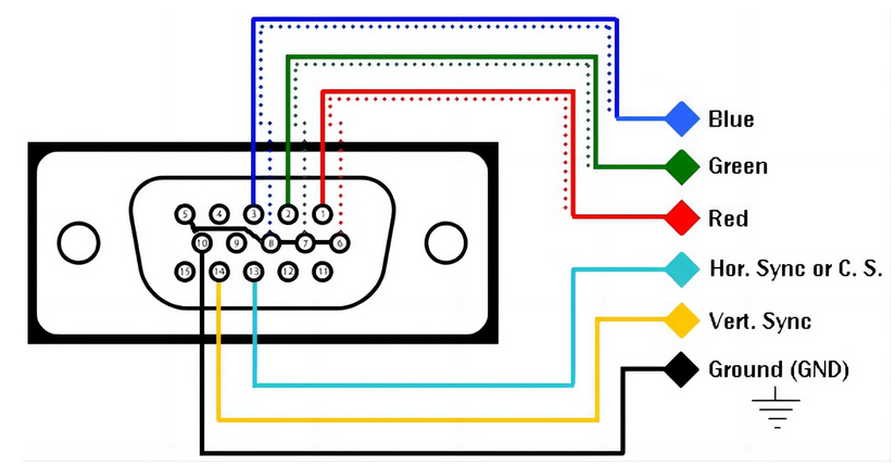

                                  Does anyone in this chat have information about the pins connection of the VGA 15 pin to the 12 pin VGA header on the M400 motherboard?
                                  If a diagram can be provided will be best.
                                  Also does anyone knows if the USB ports of the M400 box can be used for keyboard and mouse input?..... If not, is there a header in the motherboard that can be used for keyboard and mouse input.
                                  Appreciate any info anyone could provide.
                                  My thanks to all... Good day

                                      I took your picture and put some info in it in order to explain myself but I don't find the way in how to upload it the way you put the pic with your comment. Could you share in how I could insert a picture with my comment please.
                                      Anyway, what I am trying to get is like:
                                      12 pin header. ------------------------- 15 pin VGA
                                      Pin 1 _-------------------------------------------- pin 1
                                      Pin 2 ----------------------------------------------- pin 3
                                      And so on.... Cause my lack of knowledge in this kind of connections makes difficult to me to know which pin header connects to db15 pins. Using the pins numbers will make less probable to screw things up. I know the position and order number of the DB15 pins.
                                      Thank you for your help on this matter.

                                          • stephenw10S Online
                                            See the pinout below that picture here: https://en.wikipedia.org/wiki/VGA_connector
                                            You only need actually need 6 connections like:
