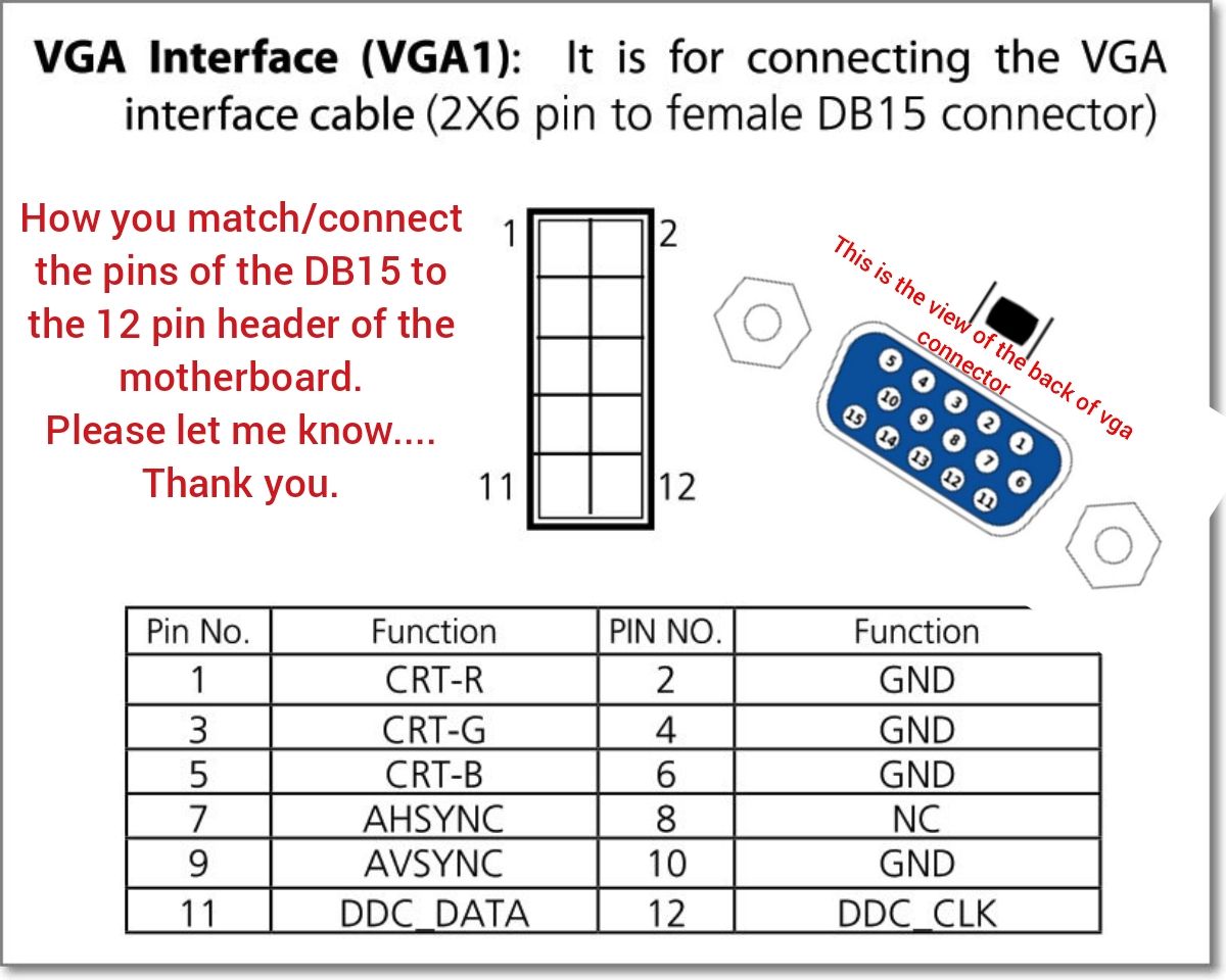

                                  Does anyone in this chat have information about the pins connection of the VGA 15 pin to the 12 pin VGA header on the M400 motherboard?
                                  If a diagram can be provided will be best.

                                    Mookatroid @jriofrio
                                    @jriofrio
                                    Directions are rather generic as there will be variances when it comes to the colour coding for each wire in a VGA DB15 connector.
                                    In short ......
                                    .... VGA header pins, 1, 2, 3, 5, 7, 9 on the M400 PCB ..... need to be connected to ......... Red, Green, Blue, Hsync, Vsync and Ground, on the DB15 VGA connector.
                                    I had to use my meter to determine which VGA wires were the required wires before I could connect it all.

                                      @Mookatroid ... Hello and thank you for replying to my question.
                                      I took your picture and put some info in it in order to explain myself but I don't find the way in how to upload it the way you put the pic with your comment. Could you share in how I could insert a picture with my comment please.
                                      Anyway, what I am trying to get is like:
                                      12 pin header. ------------------------- 15 pin VGA
                                      Pin 1 _-------------------------------------------- pin 1
                                      Pin 2 ----------------------------------------------- pin 3
                                      And so on.... Cause my lack of knowledge in this kind of connections makes difficult to me to know which pin header connects to db15 pins. Using the pins numbers will make less probable to screw things up. I know the position and order number of the DB15 pins.
                                      Thank you for your help on this matter.
                                          Well I hope this works....
