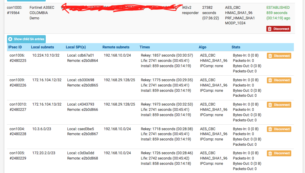

VPN S2S - P2 Bytes-In: 0 (0 B) Packets-In: 0 Bytes-Out: 0 (0 B) Packets-Out: 0
Good day,
My problem is in a vpn that had been working well around a year ago (No changes have been made in the last days that affect the behavior of this connection).
Today I have no connection to the addresses I have configured in the respective phases 2 of a vpn I have against a fortigate, to review I changed the lifetime in both phase 1 and phase 2 but the result is the same.
The vpn lifts but the state of the 15 phases 2 that I have configured is the following.
Well the question is if before it worked because no longer, as I said I see that phase 1 rises without problems equally phases 2 but these do not generate traffic input and output (This ever happened to me the brief solution was to disconnect the tunnel and upload it again), but today this solution without coherence had no effect.

ConfigWell for my part I would say that there are no problems in the configuration because as I mentioned this worked without problem and hard stable and never presented this problem, your help I have already invested in forums some people with the same problem but none gives a solution.
making a capture from the fortinet the traffic comes out but in the pfsense even with the vpn up there is no traffic for phases 2
