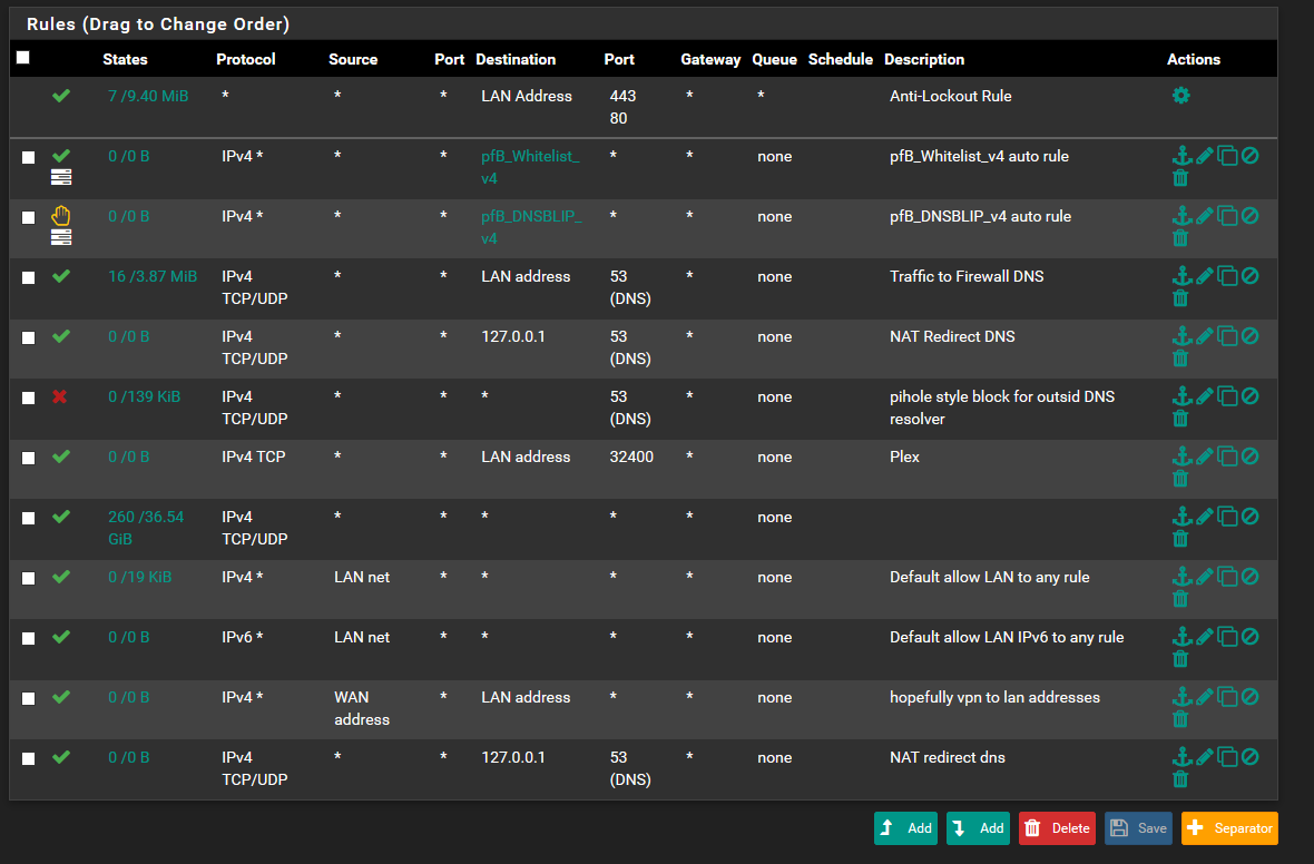

              @johnpoz i have it set up to resolve dns itself. The rules that I have set up for LAN in order to prevent DNS leaks. Maybe something is up with the rules, which is causing this?
              Below are the DNS resolver logs

                      Btw : the first 2 images, at the top of the thread, are your LAN and WAN (interface names are curt of, so the rules have no meaning at worst, tend to confusing at least) ?
                      Well .... what to say : looks messy.
                      Several identical UDP/VPN /1194 NAT (?) rules on WAN.
                      Several identical rules on LAN - but DNS traffic comes in from the LAN clients (forced to use pfSense as a DNS, that part seems ok).
                        Yeah those rules are a MESS... In what scenario is pfsense running plex? You have a rule that says ok to hit your lan address on 32400..
                        Then you have a rule on your wan with lan address is source??? WTF? Clearly you do not understand how the rules are evaluated.. It would be impossible for your wan to see lan address source.
                        You have a any rule on your wan for whitelist... This HORRIBLE!!! Have brought this up in another thread... pfblocker allowing this to happen is HORRIBLE!!! Security issue for sure..
                        Your resolving - and your worried about dns leak? You understand that every dns query will come directly from your wan IP right? That is how resolving works.
                        What I would suggest is start freaking over!!! Validate that pfsense is working out of the box with the default setup, no pfblocker.. No nonsense rules with redirecting dns, etc.. Then if you want to stop clients from using other dns then do that..
