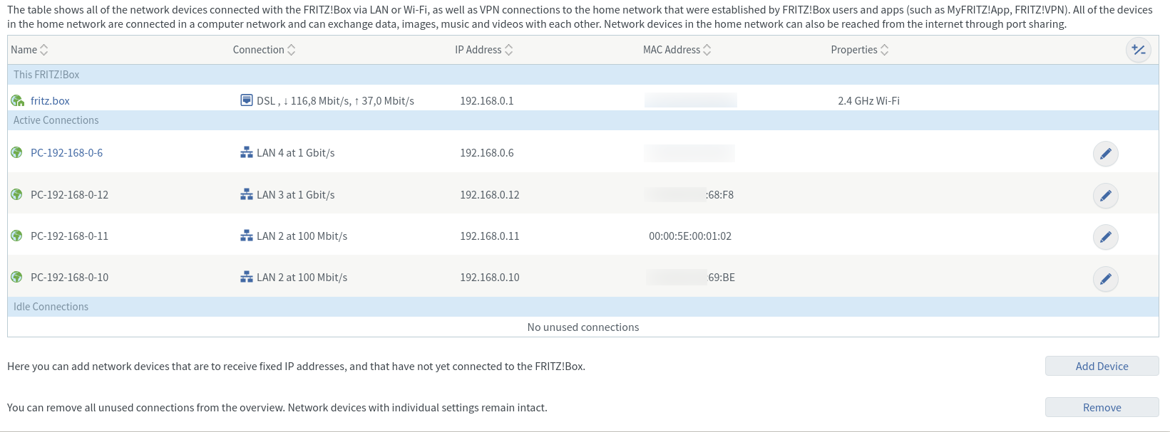

        In the ARP table of the FritzBox I see the following.
        192.168.0.6 has nothing to do with this and should be ignored.
        192.168.0.12 with :68:F8 is the secondary cluster unit with real ip and real mac-address.
        192.168.0.11 with :01:02 is the primary cluster unit with real ip and virtual mac-address.
        192.168.0.10 with :69:be is the virtual cluster unit with virtual ip and real mac-adress (of primary cluster unit).

          I believe I got it.
          Turns out, the FritzBox (at least in regards to virtual ip/mac) is crap. What you see is not what you get.
          I crossreferenced what I saw on the FritzBox with my local computer.
          On my local computer it seems to work as expected.
          Furthermore I disabled the exposed host functionality and went for a simple port forward.
          With this, initiating a vpn connection from the offsite works without any problems.
          I'll mark this as solved.
