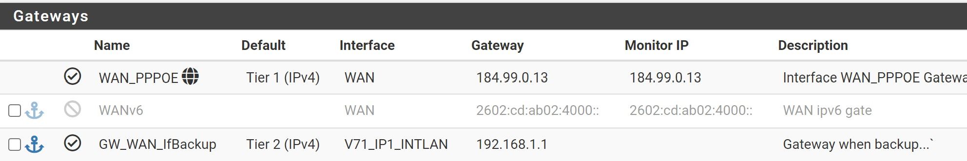

      Here is the correct setup for gateways and gw groups on primary and secondary:
      Primary
      Secondary
      After an update from primary, the secondary GW group is busted (Tier 1 is gone):
      (I was having trouble with IP addresses changing but that stabilized. Primary GW group is configured essentially the same)
