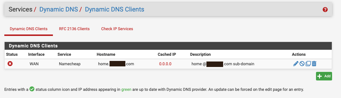

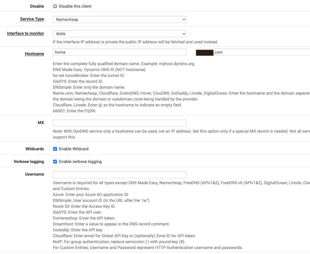

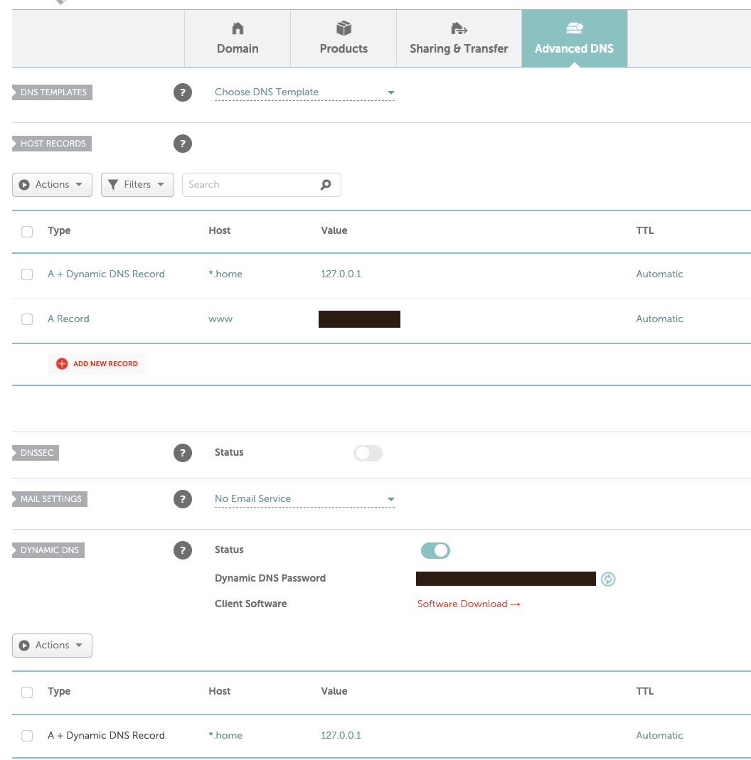

      I am trying to set up dynamic dns for a namecheap account. I have filled in the forms on both the namecheap site and pfsense. However, when I save the pfsense information, it shows that the DDNS entry is invalid (see image 1). I am trying to create a 2 layer subdomain, that is, the domain name is xxxxx.com (where xxxxx stands for the actual domain name) and I want a dynamic domain that matches *.home.xxxxx.com. I filled out the DDNS entry on Namecheap and it seemed happy with it. However, when I filled out the DDNS information on PFsense, it wasn't happy. Image 2 shows the Namecheap configuration and image 3 shows the PFsense configuration.
      Can anyone suggest why this isn't working?

        @dnessett Did you find the System Patches package and its patch "Fix Namecheap Dynamic DNS response processing (Redmine #12816)"? Namecheap has a bug in the response encoding causing it to be detected as invalid XML.
        I have a hostname like that, xxx.yyy.example.com, with no issues. In Namecheap my domain is yyy.example.com and the host is xxx. If you're actually going for a wildcard (*.yyy.example.com) it looks like Namecheap lets you create a * hostname but have to point it to an IP. Perhaps you can create something else (dummyrecord.example.com) and create *.yyy.example.com as a CNAME for dummyrecord.example.com?

                    @steveits The error was: <Err1>No Records updated. A record not Found;</Err1>. I had changed "*.home" to simply "home" earlier in the day and got the same error. But, it took a while for the DNS cached entry to timeout. I waited for an hour and the configuration update succeeded.
