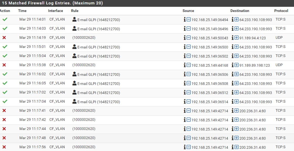

      Our Netgate PFSense is showing an abnormal behavior since we last updated, version 2.6.0.
      We have an interface (A - "CF_VLAN") that is assigned to 192.168.25.1/24 range, phisical interface em2, default VLAN; Most of our regular traffic uses that interface.
      But we also have another interface (B - "LAN_ACERTO") that right now should be out of use: 192.168.70.1/28 range, phisical interface em2, VLAN 70;
      We've been noticing that traffic that should be managed by interface A, is actually going through B. See picture bellow.
      The real issue happens when we disable interface B: then some (not all) servers with assigned IP address within interface A range stop replying request (ping, HTTP). Those servers literally go offline in that case.
      We've tried to apply the recent hotfix (https://redmine.pfsense.org/issues/12949), but it didn't help, really.
      Any ideas is appreciated. If you need further info, please let me know.

        It seems that your VLANs are not separated properly.
        As you can see in the log, the source IP of the packets coming in on LAN_ACERTO is out of 192.168.25.0/24, which shouldn't be, when the separations works.
        Possibly your switch is not configured accordingly.

          I might be missing something on what you just said, because the printscreen above should show only outgoing traffic. That is, 192.168.25.0/24 ( A - LAN_ACERTO) sending packages to remote host, not the otherwise.
          At the same time, with the img I meant to demonstrate that a rule attached to interface B - CF_VLAN is seemly to block packets that should come over (A - LAN_ACERTO, range 192.168.25.1/24).
          Besides, such uncommon behavior has started a few weeks ago when we updated to v2.6 and we haven't changed anything in the switch configuration by then.
          Would you mind to go a little deeper in your analysis, please? As I said, maybe I'm missing something, and if that's the case, please accept my apologizes.

              We do rule description (at least most for most of them). The particular rule in that screenshot is likely to be an aut-generated rule, since I couldn't find that in any interface that we have in Firewall > Rules. I suspect that is from Suricata, tbh.
              BTW, just to be sure, I've checked our switch and everything looks fine. I would appreciate any other idea.

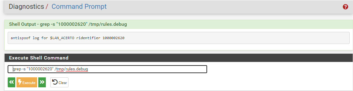

                  You can see that the rule associate with that tracker ID is by checking the file /tmp/rules.debug.
                  However it's almost certainly the antispoof rule for LAN_ACERTO:
                  antispoof log for $LAN ridentifier 1000002620
                  That is correctly blocking traffic with a source IP in the LAN_ACERTO subnet entering via a different interface. That can only happen if it is somehow being tagged as VLAN 70.
                  You can try running a packet capture on em2 directly to see exactly what traffic is coming in and how it is tagged.

                    You're right about the the antspoof rule. Thanks to your input, I managed to check that:
                    When it comes to checking the packets content to see if VLAN 70 is tagged though, apparently it isn't. I am attaching the .cap files and firewall log. I'd would be really glad if you could double-check those, please. This is how the firewall reported when I tried to run a simple sudo apt-get update in one of our servers that is showing the "CF_VLAN" issue. Notice that the firewall shows that it is traffic comes out from CF_VLAN (when it is actually from LAN_ACERTO)
