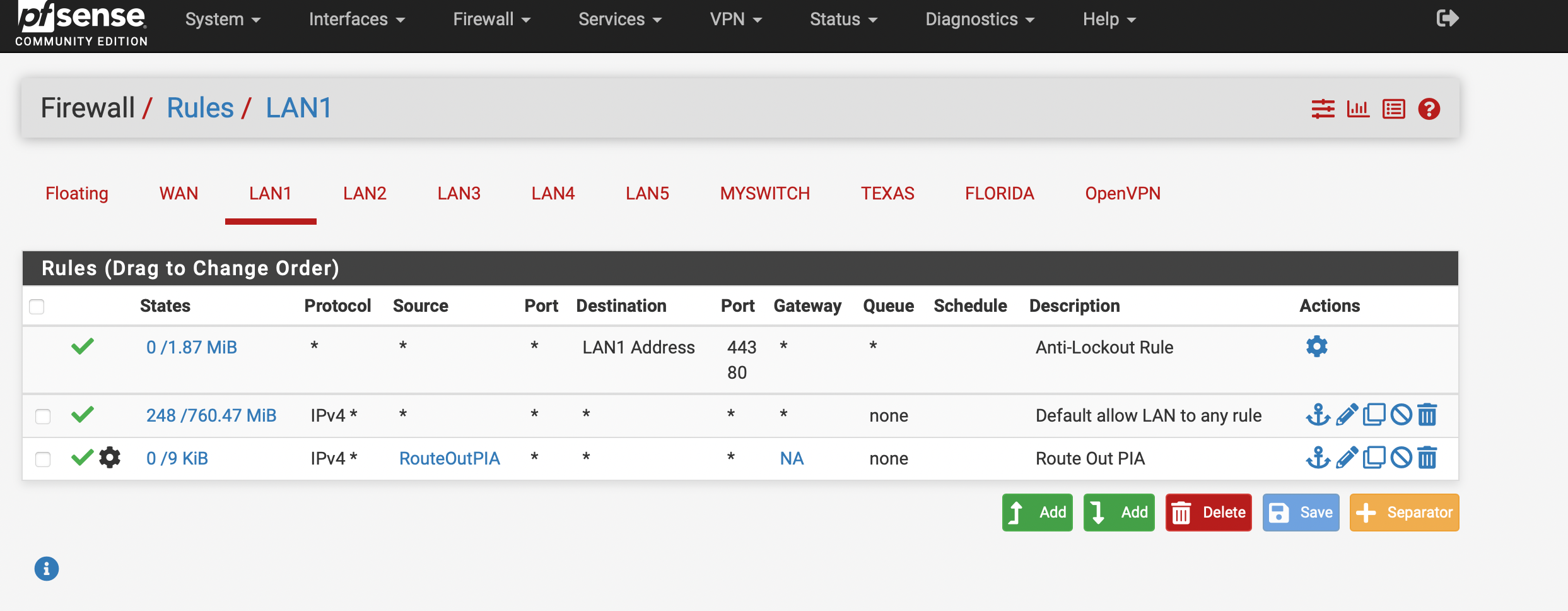

              @rjamesm Yes, I did see your screenshot on Verizon. No, VPN traffic is not being routed through out the entire network, only by Aliases.

                Btw with the rules like that, you would never use the vpn. You have a any any rule above where your policy routing. Rules are evaluated top down, first rule to trigger wins - no other rules evaluated. So that rule would never kick in how you have shown in your screenshot

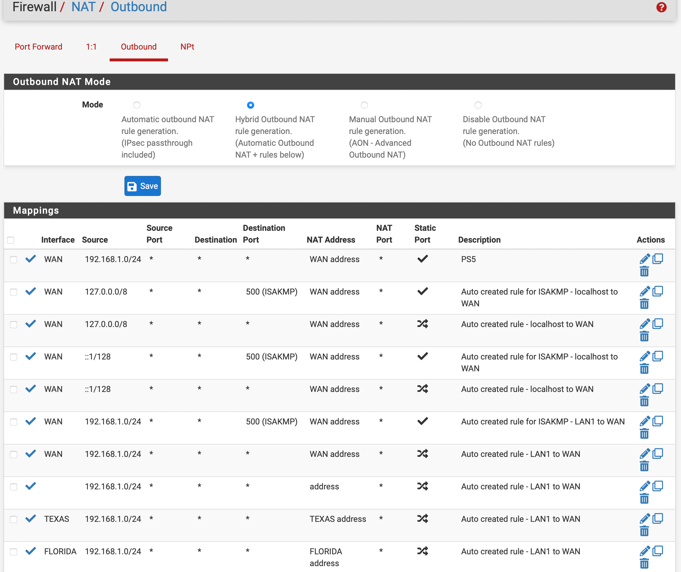

                          When you setup your vpn connection - did you mess with automatic outbound nat, setting it to manual - many a guide says to do that nonsense.

                              johnpoz LAYER 8 Global Moderator @rjamesm
                              @rjamesm what are those - those are not hybrid rules.. You have one there without a interface and says jsut address?
                              I would switch that back to full automode, Looks like you have anything coming from the 192.168.1 doing static as well.. etc..
                                Mmm, you have some odd rules there. The one with no interface is particularly suspect.
                                And, you have set static source ports for all of LAN. The issue with that, potentially, is that if you have two phones trying to connect to the same external IP you might have a state conflict where one connection fails. You should still see port 4500 states present though.
