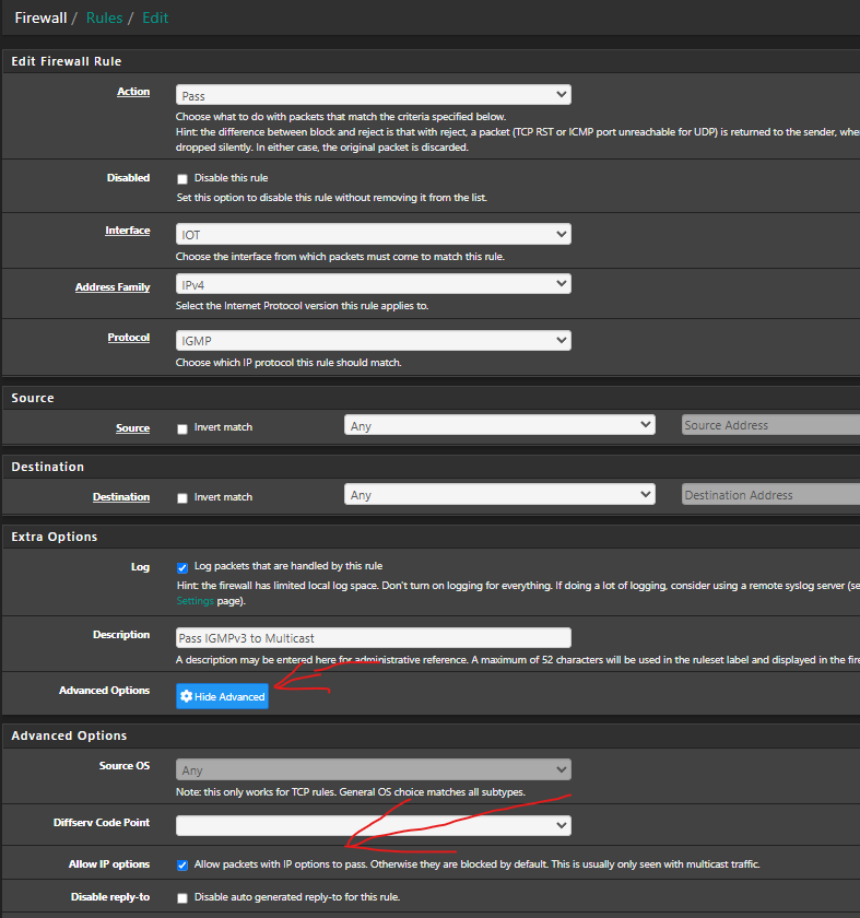

                              MoonKnight @Mission-Ghost
                              @Mission-Ghost
                              Try to edit your rule again an add this into the advanced session:
                              I don't use floating rules on this one. This is just from one of my vlan interfaces.
