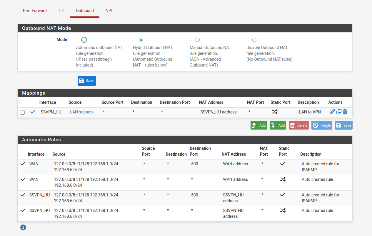

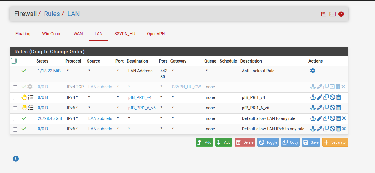

<img src="/assets/uploads/files/1749666272832-screenshot-from-2025-06-11-13-59-55.png" alt="Screenshot from 2025-06-11 13-59-55.png" class=" img-fluid img-markdown" /></p>
<p dir="auto">I'm not sure what the auto-created rules present on mine but missing from yours do.</p>
<p dir="auto"><img src="/assets/uploads/files/1749666274520-screenshot-from-2025-06-11-13-59-06.png" alt="Screenshot from 2025-06-11 13-59-06.png" class=" img-fluid img-markdown" /></p>
<p dir="auto">As soon as I enable this rule below, my internet connection stops working. Without it enabled, my IP remains listed as my ISP's.</p>
<p dir="auto"><img src="/assets/uploads/files/1749666433343-screenshot-from-2025-06-11-14-26-07.png" alt="Screenshot from 2025-06-11 14-26-07.png" class=" img-fluid img-markdown" /></p>
<p dir="auto">I currently have DoT set up with CIRA servers; I tried setting up the static gateway routing to the VPN endpoint (listed as optional in the documentation), but it did not change that my connection was down. Should I be leaving the default IPv4 gateway as Automatic?</p>

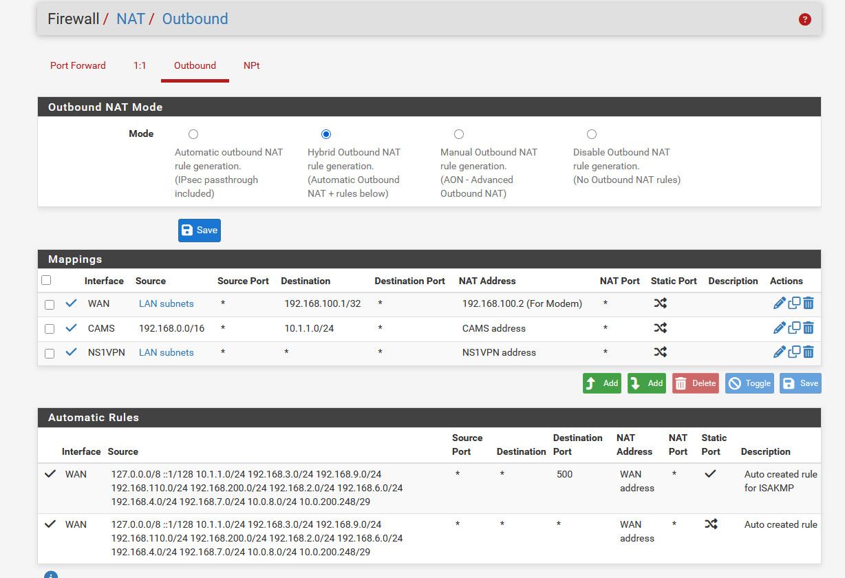

<p dir="auto">Here is example</p>
<p dir="auto"><img src="/assets/uploads/files/1749652294010-nat.jpg" alt="nat.jpg" class=" img-fluid img-markdown" /></p>
<p dir="auto">All of my normal networks are just auto - and nat to my normal wan address.. But I have a special nat, that if I route traffic out my vpn interface (ns1vpn) in my case it will nat to that address.</p>

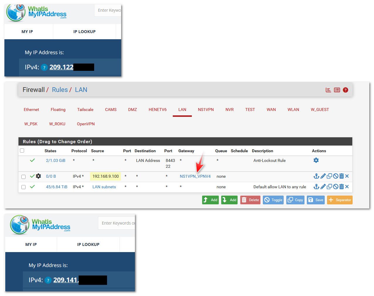

<p dir="auto">Clicky a policy route to send something out my vpn - it does so, toggle that rule off and now back to normal routing and just going out my normal wan.</p>
<p dir="auto">So as example - my normal IP 209.122.x.x out on the internet, then route it out my vpn and I am seen as my vpn exit IP 209.141.x.x.</p>
<p dir="auto"><img src="/assets/uploads/files/1749652811997-vpn.jpg" alt="vpn.jpg" class=" img-fluid img-markdown" /></p>
