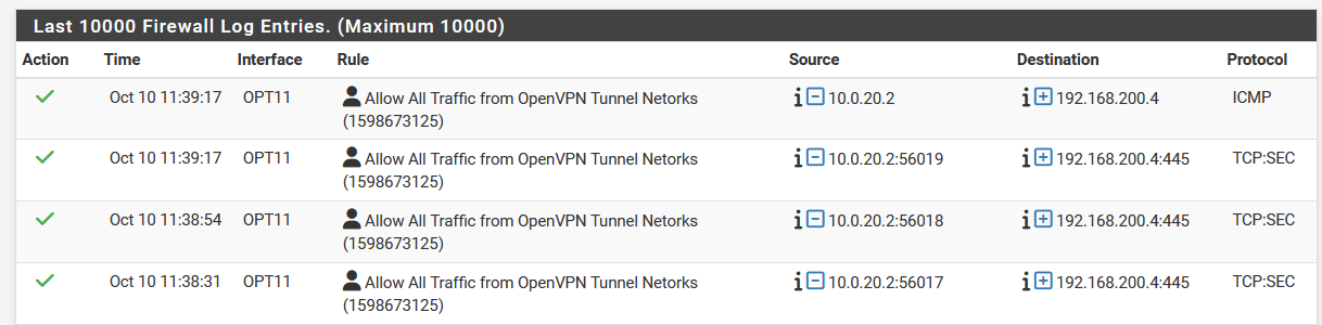

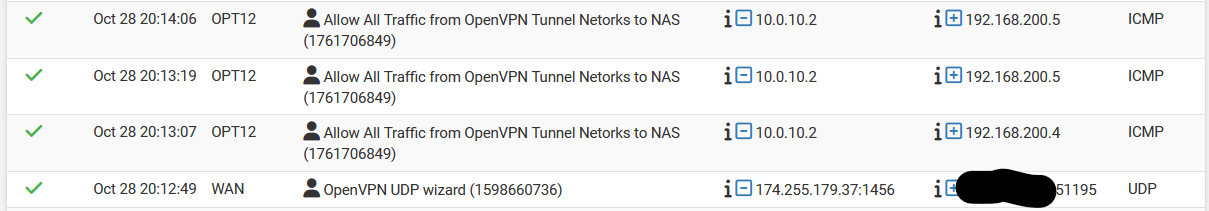

        Here is the firewall log showing the iPad reaching out to the NAS:

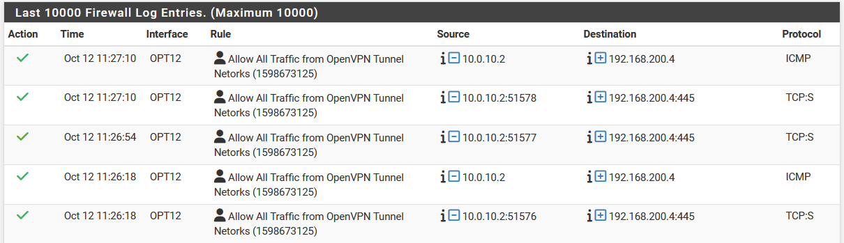

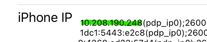

            So when I try to ping the NAS from my iPhone while using the VPN tunnel, I see the traffic pass the firewall but the ping fails. Not sure what to try next...
            I have two VPN servers. OPT11 uses TCP and assigns local devices an address in the 10.0.20.0/24 network space. OPT12 is UDP and uses 10.0.10.0/24. THe iPhone in this attempt was 10.0.10.2.

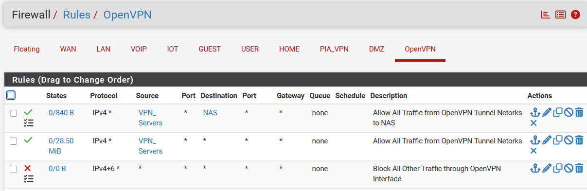

                  please post a screenshot of your firewall rule for your openVPN interface in use (rules > Interface), not just the log entry.

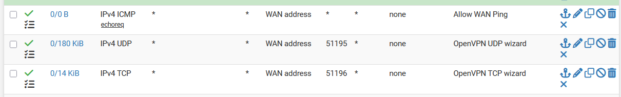

                                  OK, added an Echo Request rule on the WAN to allow ICMP traffic. I can now ping my IP directly and the DDNS URL. However, I still cannot access the NAS with File Explorer.
                                  Here are my WAN pass rules:

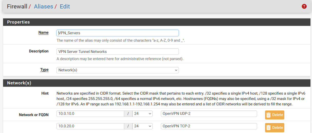

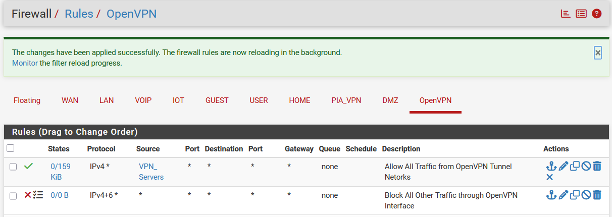

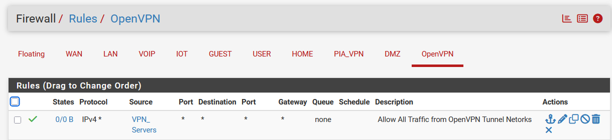

                                    Here are all the active OpenVPN interface rules:
                                    The VPN Servers Alias is this:
