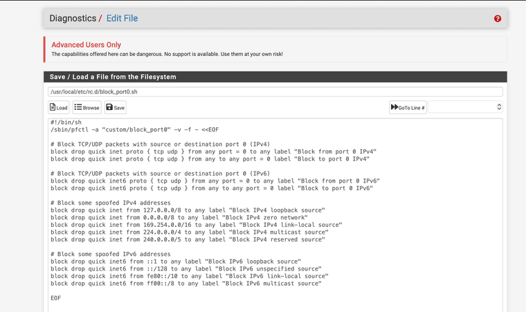

      Scrip:
      #!/bin/sh
      /sbin/pfctl -a "custom/block_port0" -v -f - <<EOF
      # Block TCP/UDP packets with source or destination port 0 (IPv4)
      block drop quick inet proto { tcp udp } from any port = 0 to any label "Block from port 0 IPv4"
      block drop quick inet proto { tcp udp } from any to any port = 0 label "Block to port 0 IPv4"
      # Block TCP/UDP packets with source or destination port 0 (IPv6)
      block drop quick inet6 proto { tcp udp } from any port = 0 to any label "Block from port 0 IPv6"
      block drop quick inet6 proto { tcp udp } from any to any port = 0 label "Block to port 0 IPv6"
      # Block some spoofed IPv4 addresses
      block drop quick inet from 127.0.0.0/8 to any label "Block IPv4 loopback source"
      block drop quick inet from 0.0.0.0/8 to any label "Block IPv4 zero network"
      block drop quick inet from 169.254.0.0/16 to any label "Block IPv4 link-local source"
      block drop quick inet from 224.0.0.0/4 to any label "Block IPv4 multicast source"
      block drop quick inet from 240.0.0.0/5 to any label "Block IPv4 reserved source"
      # Block some spoofed IPv6 addresses
      block drop quick inet6 from ::1 to any label "Block IPv6 loopback source"
      block drop quick inet6 from ::/128 to any label "Block IPv6 unspecified source"
      block drop quick inet6 from fe80::/10 to any label "Block IPv6 link-local source"
      block drop quick inet6 from ff00::/8 to any label "Block IPv6 multicast source"
      EOF

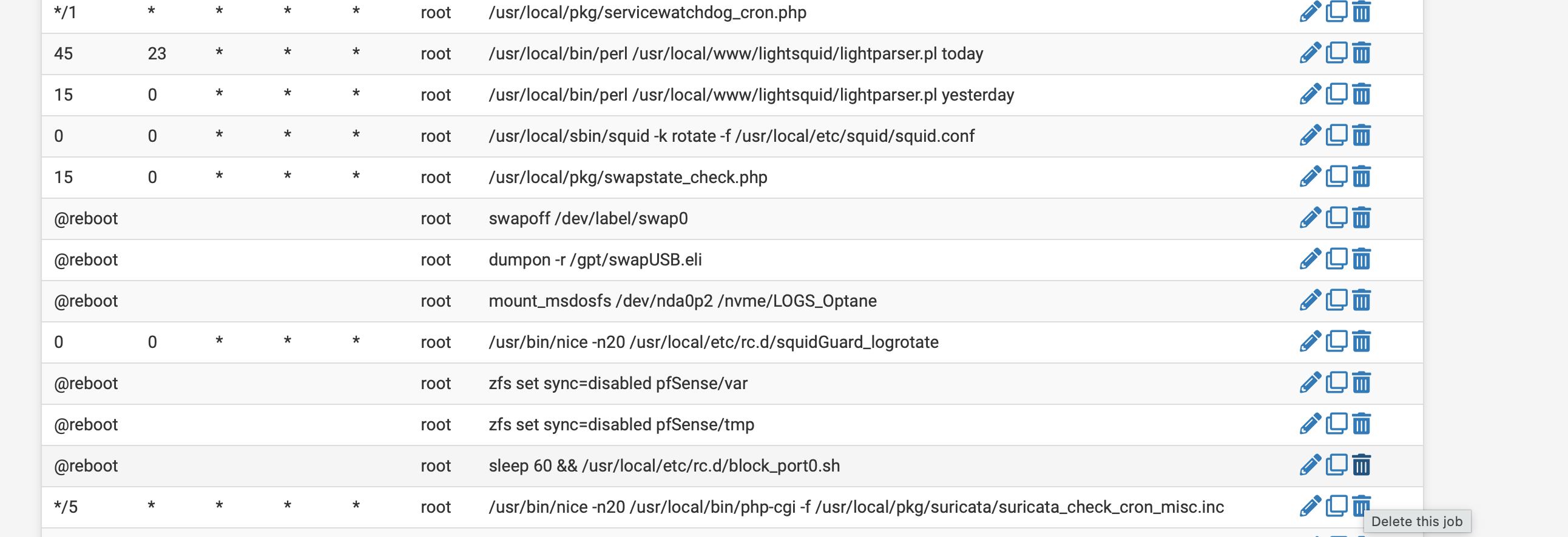

      Cron:
      sleep 60&&/usr/local/etc/rc.d/block_porto.sh

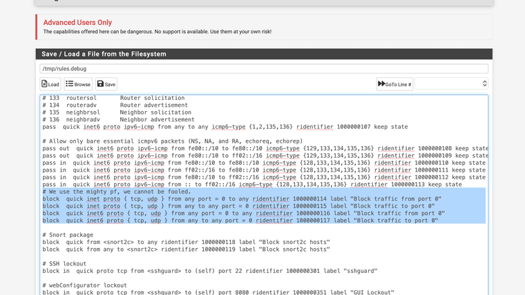

        johnpoz LAYER 8 Global Moderator @JonathanLee
        @JonathanLee said in Port 0 Extra Precautions:
        port = 0
        didn't you bring this up before - those are already blocked
        # We use the mighty pf, we cannot be fooled.
        block  quick inet proto { tcp, udp } from any port = 0 to any ridentifier 1000000114 label "Block traffic from port 0"
        block  quick inet proto { tcp, udp } from any to any port = 0 ridentifier 1000000115 label "Block traffic to port 0"
        block  quick inet6 proto { tcp, udp } from any port = 0 to any ridentifier 1000000116 label "Block traffic from port 0"
        block  quick inet6 proto { tcp, udp } from any to any port = 0 ridentifier 1000000117 label "Block traffic to port 0"
        Pretty sure those others are also blocked - I know 0.0.0.0/8 is in the bogon table, I know 224.0.0.0/4 and 240.0.0.0/4 also in bogon. 127.0.0.0/8 also in bogon. ::/10 is in bogonv6
        Blocking fe80::/10, and ff00::/8 prob going to cause you problems like that if your trying to run ipv6. I know some stuff in those ranges are required for stuff like ns,na and RA ane echoreq and rep.. The required stuff is specifically allowed already in the rules but loading your own rules like that where are they going to end up in the rules order?
        169.254 also already blocked
        block in  quick from 169.254.0.0/16 to any ridentifier 1000000101 label "Block IPv4 link-local"
        block in  quick from any to 169.254.0.0/16 ridentifier 1000000102 label "Block IPv4 link-local"
        I see nothing you have presented that isn't already blocked, or could cause issues.
        If you want to add extra rules - put them in floating or specific interfaces. Then your sure the rules pfsense puts in you will not be overridden.
        • JonathanLeeJ Offline
          JonathanLee @johnpoz
          @johnpoz thanks for the reply. I was getting wedged on reboots until I removed that script. It seemed to fix the issues. I don’t know if that was related or not. My main issue was that also dhcpv6 leases for managed addresses on the one side of the network. Some of them would stay active, even though the device is completely turned off for a couple days they would still have a lease active it was that was another weird one. Yeah it is related to DHCPv6 in router advertisement sections

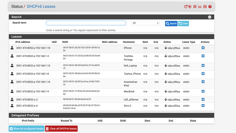

            Gertjan @JonathanLee
            Some of them would stay active, even though the device is completely turned off for a couple days ...
            What DHCPv6 server ? ISC ? Kea ?
            Default lease duration ?
            What do ou mean by 'active' ? Even with the device turned off, the IPv6 address still replies to a (example) ping ?
            That one side is called the DHCPv6 server. You might call that "one side". How is that a problem ?

            I presume @reboot means : during the boot, this line gets executed.
            Look at your logs, you'll find :
            Afaik : the /tmp/rules.debug is regenerated very often. This file is used to "repopulate" all the firewall rules and settings.
            I don't think the rules you put in place with the @reboot will survive this.
            Also, files with the .sh extension and execute bit set, place in the /usr/local/etc/rc.d/ folder are executed at boot. There are already a couple of .sh file there :

            Then why adding a cron task ? Doesn't that means you rules get added twice ?
                  I have two subnets I have a guest area and a secure side for openVPN use with my private cloud. The side I am talking about is the secure side. So my WLAN interface
                  I am using ISC on plus 23.05.01 still I can't upgrade util the Squid status page issue is resolved the bug report is still open in Redline after Squid did there updates for the security issues the status page is not working.
                  7200 seconds.
                  Max lease time 86400 seconds.
                  What do you mean by 'active' ? Even with the device turned off, the IPv6 address still replies to a (example) ping ?
                  By active I mean if I have it set to RA mode managed if I go to status/DHCPv6 Leases some devices even when turned off show Online in green for days on end until a reboot at that point the system says wedged reset its weird like it hangs with the dhcpv6 lease I have not attempted to ping it I will next time, but the ipv4 lease for that device is gone when this occurs.

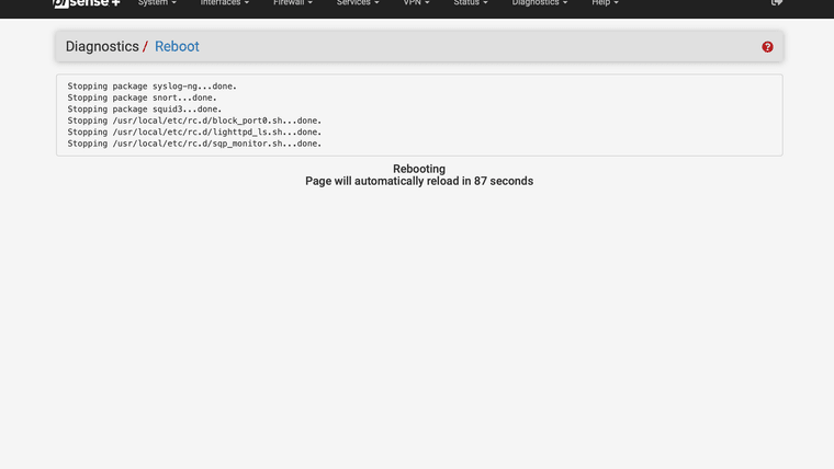

                  On shutdown it does try to stop the script you can see the script name also so it is running at times. I have removed the cron, based on the recommendations I am thinking I will delete the file I just wanted port 0 to be disabled on ipv6 also but it appears to break something when it is running.
                    dude.. Run squid on something else if you want the latest and greatest version, etc. Posting stuff about adjusting rules on a 2 year old version is a waste of time.
                    As to port 0 on ipv6 - what are you not getting that those are already blocked??
                    rules.debug

                      @johnpoz On a side note thanks for info on cron I removed that and the wedged errors are gone and it does run automatically. You can see it running when it reboots.
                        @johnpoz said in Port 0 Extra Precautions:
                        rules.debug
                        Yes they are there .. there was something that wasn't working originally that was why I had this script I can't remember what it was right now I have to find that old post. The website will not let me view historical posts right now for some reason it only lists the last couple or so now
