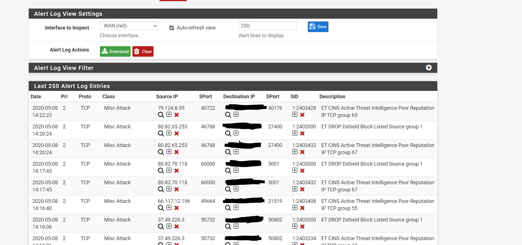

                                  I have tried to setup snort like here mentioned: https://docs.netgate.com/pfsense/en/latest/ids-ips/setup-snort-package.html
                                  What I want to archive is, that I see in the alerts section more meaning full information like on the screenshots at the end of the side (facebook, icloud ect)
                                  I have my list with alerts, but this additional usefull info missing. why?

                                    Following your question is difficult due to the translation confusion (I'm guessing English is a second language for you), but it sounds like maybe you need to scroll over to see the Message column on the ALERTS tab. What type of device are you using to view the pfSense GUI screens? If it has a small screen, you will need to scroll over to the right. It could also be that if you choose a non-standard theme that could cause scrolling problems.
                                    A screen capture of what you see on your device would be helpful in order to understand what is missing for you.

                                      Jep, I hope it s not too bad.
                                      I m on the last pfsense version, and I use a 34 " screen. Scrolling in "all" directions does not change it. Maybe now you understand, why I was asking for lists to whitelist and help. With only this alerts it s really hard to find "good" traffic!

                                        I'm sorry, but I completely do not understand what you are asking for. Everything available from the alerting rules log is displayed on that screen. I mistakenly said Message column but the actual name is Description. I thought perhaps you were viewing on a mobile device and that column was scrolled off the screen. This tab shows alerts coming from the rules you have enabled. If you don't enable the rules (and necessary preprocessors), then no alerts can happen from those rules. Again, though, I really don't understand what you are trying to say is missing.
                                        The best guess I can come up with is you are really not experienced in intrusion detection systems, and if that is true, then Snort is not going to be fun for you. You need to learn about the technology first if this is new to you. You will need to learn the Snort rule syntax and then examine the text of triggering rules to determine what they are alerting on. Research on the rules vendor sites can also help. And learning about the technology requires lots of reading and studying on the web, or else take some classes.

                                          Please go back the the fololowing URL: https://docs.netgate.com/pfsense/en/latest/ids-ips/setup-snort-package.html
                                          An the end of the article you see the ALERT section as discussed. The only difference is, that on this screenshot you have on the right side a information, that is request was related to Amazon, icloud what ever.
                                          For this information I m looking for

                                            @interessierter said in SNORT blocking too much:
                                            Oh, so you don't have the OpenAppID rules enabled? That's where that type of information comes from. Did you follow all of the steps in that article you linked? Sounds like you missed one if you are not seeing OpenAppID alerts (or else there is no traffic on your network matching those rules).
                                            To use OpenAppID you must do four things.
                                            1. On the GLOBAL SETTINGS tab enable the download of the OpenAppID Stub Detectors and the OpenAppID text rules (that's two different checkboxes) and save the change.
                                            2. On the PREPROCESSORS tab for the interface, enable the OpenAppID preprocessor and save the change.
                                            3. On the CATEGORIES tab for the interface, enable the OpenAppID rule categories that you want to use by checking the boxes and then saving the change.
                                            4. Restart Snort on that interface using the GUI icon on the INTERFACES tab.
                                            Note that the OpenAppID rules are not perfect. They were created by a volunteer maintainer in Brazil and are hosted by the pfSense team's infrastructure. I don't believe the maintainer has updated them in a while, so that means there is likely some types of traffic they will miss.
                                            Finally, a last warning, if you turn on OpenAppID rule blocking your life will be miserable if folks on your network routinely use social media and streaming apps. That's the type of traffic those rules are designed to detect and usually block. The rules are really designed for corporate enterprise networks where the management does not want the workers wasting work time on social media.
                                            Your question seems to have wandered from "snort is blocking too much" to "I want to see more info". If your original problem is Snort is blocking too much, then turning on OpenAppID is going to make it a whole lot worse! I suspect your real issue is several of the HTTP_INSPECT preprocessor rules are causing you grief when you have blocking enabled. Read through this very long thread to see some examples from more experienced users showing which rules are typically disabled: https://forum.netgate.com/topic/50708/suricata-snort-master-sid-disablesid-conf.
