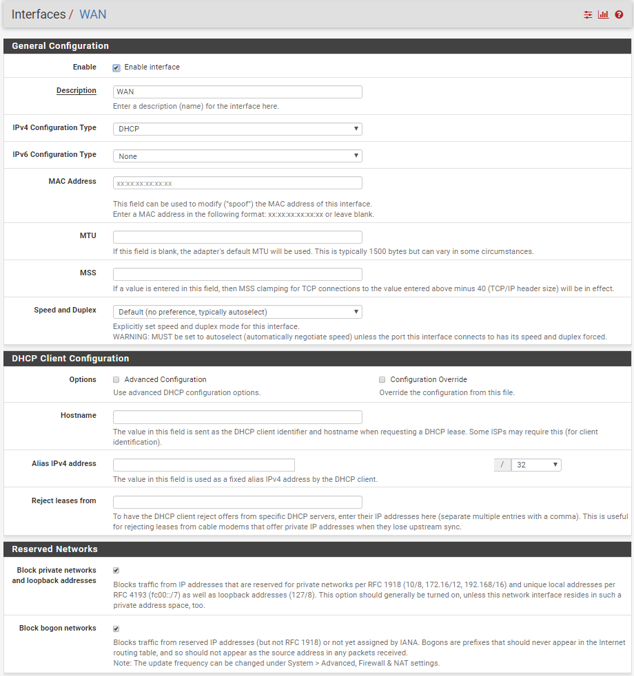

                                        CoyoteKG
                                        Hello, I succeeded to setup on cloud with one WAN openvpn and connect devices from different places to one network.
                                        ISP is Hetzner.
                                        This is the configuration if someone need. Mostly done via Wizards, with small corrections afterwards.
                                        Still need a little bit to harden firewall.
