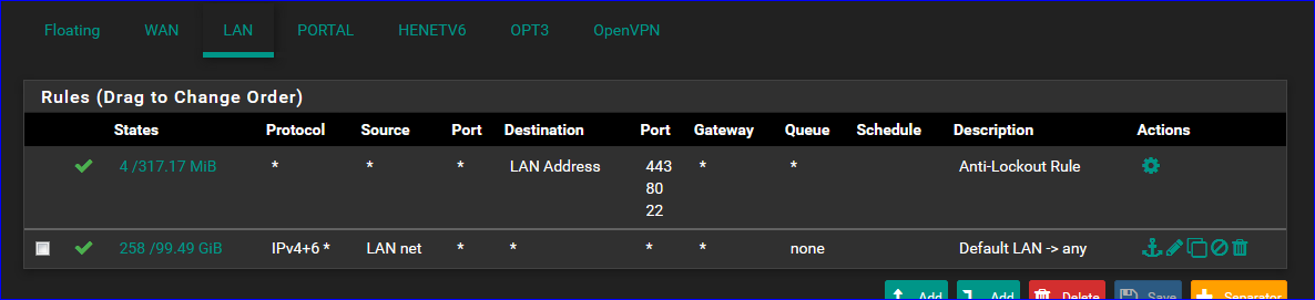

                  Example :
                  When you know that the stars "*" mean "any" the image is quiet good readable.
                  The second rule : "Traffic coming into LAN interface, IPv4 & IPv6 - from the LAN, net range, is accepted"
                  The first rule is created when you activate the GUI and console anti lock out.
                  The counter in front of the rules are important. You can check if your rules actually apply.

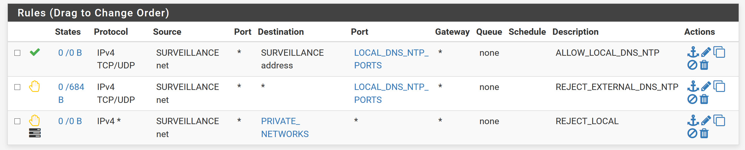

                                      @johnpoz hello
                                      I don't know if I am doing this right!!!!
                                      Let me explain what I need and what I have make sure I don't need
                                      I need all the cameras to hit the pfSense interface for DNS 53 and NTP 123
                                      What I want to make sure 1st they cannot access the pfsense web gui on ports 80,443 and ssh to 22. 2nd each cams are not aware of other hosts on it's network or any other netowrk
                                      They will be controlled from a software on the mgmt netowork,so all I need is to resolve and get the time's right
                                      Thank you
                                        @xlameee said in Understanding better the firewall rules:
                                        2nd each cams are not aware of other hosts on it’s network
                                        This has zero to do with pfsense. Your going to need a switch that can to private vlans for that, or if wifi then set AP to isolate clients. Different makers call it different things.
                                        What is below that.. I don't see any allow rules - is there an allow rule for any so they can use the internet? What is in your aliases?
                                        But from your descriptions sure that would allow access to dns and ntp on the pfsense surv IP. Then block/reject anywhere else those ports.
                                        Then if your private networks alias includes all rfc1918 space or your other networks it would block access to those. But if you have say an any any rule below that, then it would be possible to hit the web gui on your wan IP.. Which you would assume would be public.
                                        If you do not want stuff to get to stuff on firewall, then you should use the "this firewall" dest built in alias which would include all pfsense IPs, lan, optX, wan, etc.

                                          @johnpoz alias PRIVATE_NETWORK RFC1918
                                          alias LOCAL_DNS_NTP_PORTS ports 53 123
                                          No dont want them to access internet
                                          Isn't is pfSense have an built in firewall rule DENY ANY to All until PASS traffic rule is in place
                                            yes there is a default deny for sure.. So if you do not have an allow below that then your fine other then the rule would allow your camera to hit your web gui via the wan IP address, unless it is also a rfc1918 address.
                                            Most the time the wan IP is public, user tend to forget this when doing rule.
                                            But if you do not have any allow rules, what would be the point of the cam being able to do dns? Other than say looking up stuff on its own network, but you stated you didn't want the cam even knowing about other devices on its own network. So having a hard time understanding the point of allowing dns?
