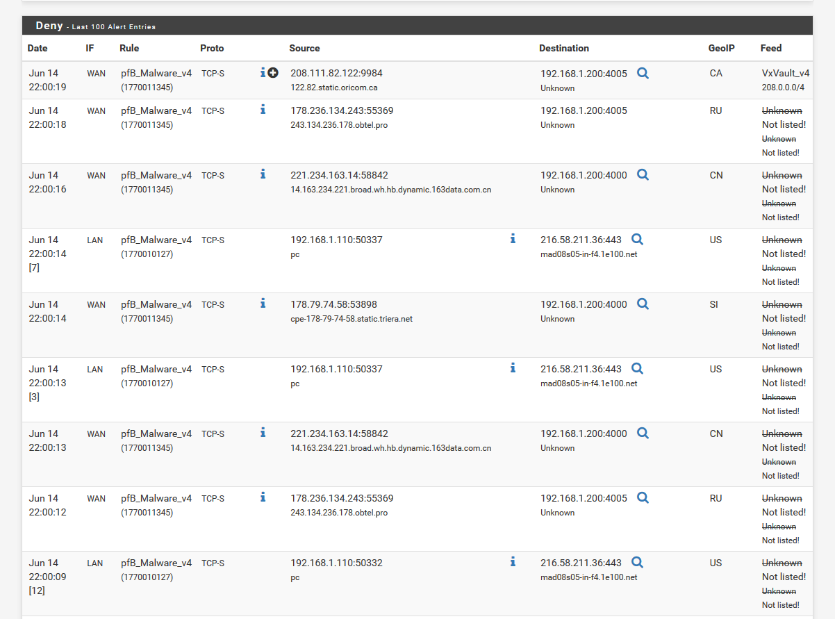

      After using it for a while a day misteriosly I start to get hundreds of IP's blocked that appears in the pfblockerng log but doesn't belong to any list, then services from google, like drive, and google.com doesn't work because for some reason pfblockerng is blocking them, even this forum wasn't working while other sites did.
      First my configuration is fine and I have not done any change between it was working and then not, so it must be a bug in pfblockerng
      Second, same problem in the previous version.
      Third it doesn't matter what you do, or change in the config the only way to make it work again is to delete everything and start from scrach.
      I have seen the same bug in other threads, is old and totally a priority since it breaks the entire software functionality. What the problem is and why there is no a way to fix it, even if it's manual (pressing a button)
      Other minor problem is that when I delete logs in pfsense and pfbockerng packets in the widget after a while old logs appears for pfblockerng
      Thanks for your time.

        @l0rdraiden said in pfblockerng error: Unknown Not listed!:
        After using it for a while a day misteriosly I start to get hundreds of IP’s blocked that appears in the pfblockerng log but doesn’t belong to any list
        It's not an error, the Alerts will display Unknown Not listed when the IP is no longer in any IPV4 lists or during a Update as the database is being rebuilt.

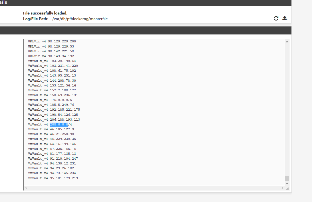

                        • BBcan177B Offline
                          BBcan177 Moderator
                          It looks like the Feed "VXVault" has a large CIDR: 208.0.0.0/4 which is causing your issue... Not sure which URL you are using for that? I checked the feed, and don't see that IP listed. The only way to overcome that CIDR blocked entry, is to create a "Permit Outbound" Alias to allow outbound to it.
                          In regards to the "Not Listed". The new DEVEL version keeps its own copy of the events in "/var/log/pfblockerng/ip_block.log" So if you wanted to start over, you could delete that log file.

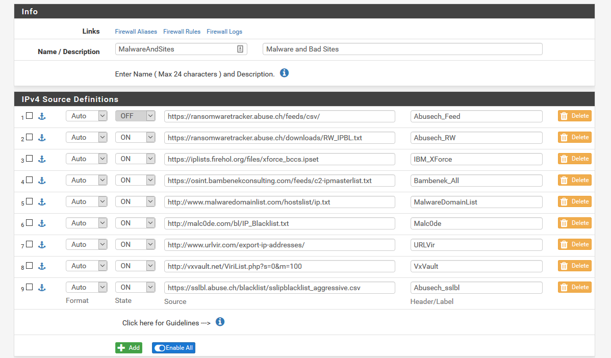

                              First and example of the log where for example this forum is being blocked and they all appear as not listed... but somehow those IP's are part of the blocklist
                              This is the list of url inside that group
                              http://vxvault.net/ViriList.php?s=0&m=100
                              This is the ip_block.log
                              Jun 16 10:53:15,1770010922,igb0,LAN,block,4,6,TCP-S,192.168.1.110,208.123.73.199,55932,443,out,US,pfB_MalwareAndSites_v4,208.0.0.0/4,VxVault_v4,forum.netgate.com,pc,+
                              Jun 16 10:53:15,1770010922,igb0,LAN,block,4,6,TCP-S,192.168.1.110,208.123.73.199,55932,443,out,US,pfB_MalwareAndSites_v4,208.0.0.0/4,VxVault_v4,forum.netgate.com,pc,-
                              Masterfile
                              VxVault origin file
                              [0_1529140752720_VxVault_v4.orig](Uploading 100%)
                              VxVault_v4.orig -> https://pastebin.com/ntsNk03s
                              So I don't understand why it's blocking 208.0.0.0/4 and 176.0.0.0/5 if these are not in the original list and still remain after reload the ip lists. I don't know how to get rid of them. Maybe is a problem with the VXVault format. But still that doesn't explain why those IPs don't disappear and why is blocking something that is not related to any list, at least I don't understand it.
                              I can understand that If I update and an IP disappear in the log the old blocks will appear as "not listed old_list_name" but I don't undestand why a non listed IP is blocking stuff, or that a "non listed not listed" IP what ever it means (it was not listed and now is either listed) is blocking something. pfblockerng should delete not listed IPs so this doesn't block anything anymore and I think this is what is failing here.
                              How I can fix it? It's the 3rd or 4th time that I have had this problem with pfblockerng since I started to use it (3 months ago) and the only way to fix it what to start from scracth.

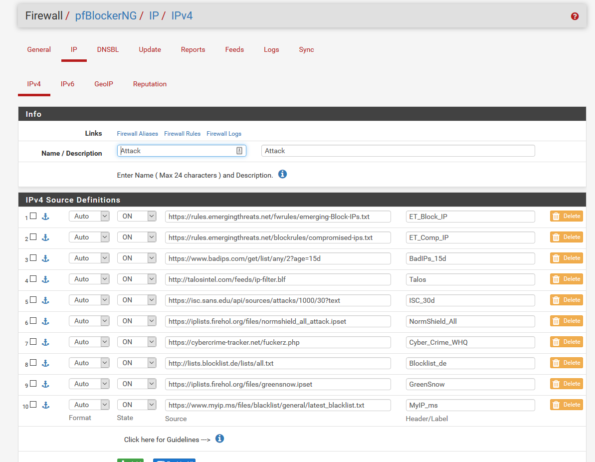

                              The only thing I can think that I did wrong maybe was this "** AVOID ** Running these "Force" options - when CRON is expected to RUN!" so maybe I run and update while cron was working, I don't know for sure but I can't discard it since when I whitelist something I usually run the Update task. Could this be the root cause of my issue? maybe I'm that stupid and I did the same mistake 3 times xD
                              On the other hand the widget packet count doesn't work very well
                              and then if I click in attackv4
                              Thanks

                                Run these commands to see where these IPs are listed:
                                grep "\.0\.0\.0" /var/db/pfblockerng/deny/*
                                grep "\.0\.0\.0" /var/db/pfblockerng/original/*
                                grep "\.0\.0\.0" /var/db/aliastables/*

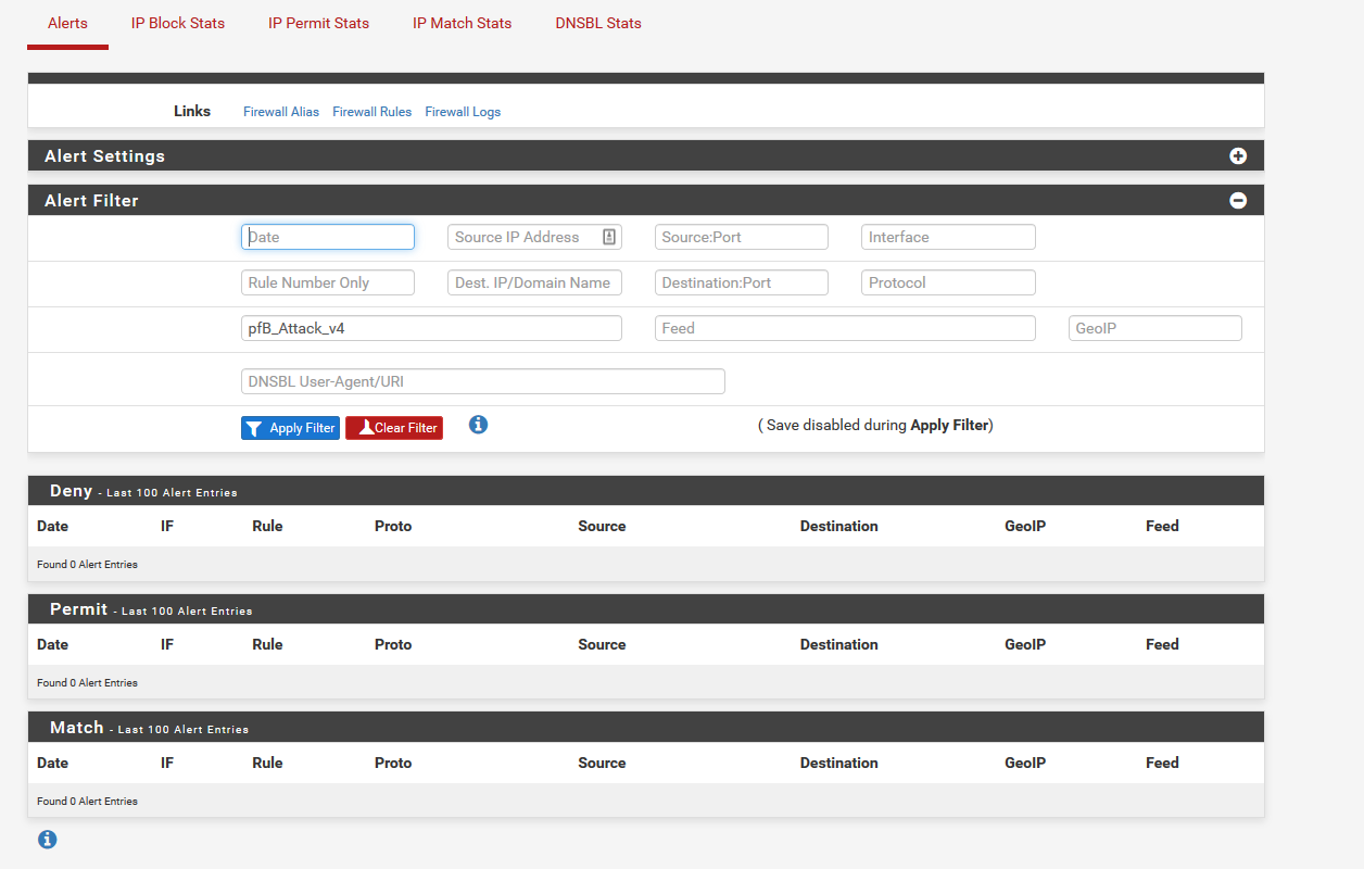

                                For the Widget pivot to the Alerts Tab. Run this command to see what entries are in the ip_block.log:
                                grep "pfB_Attack_v4" /var/log/pfblockerng/ip_block.log
                                  It could be that the ip_block.log is rotating the max. line count and clearing out those entries. You can increase these log line limits in the General Tab.
                                  Shell Output - grep ".0.0.0" /var/db/pfblockerng/deny/*
                                  /var/db/pfblockerng/deny/ET_Block_IP_v4.txt:161.0.0.0/19
                                  /var/db/pfblockerng/deny/ET_Block_IP_v4.txt:223.0.0.0/15
                                  Shell Output - grep ".0.0.0" /var/db/pfblockerng/original/*
                                  /var/db/pfblockerng/original/ET_Block_IP_v4.orig:161.0.0.0/19
                                  /var/db/pfblockerng/original/ET_Block_IP_v4.orig:223.0.0.0/15
                                  Shell Output - grep ".0.0.0" /var/db/aliastables/*
                                  grep: /var/db/aliastables/*: No such file or directory
                                  https://rules.emergingthreats.net/fwrules/emerging-Block-IPs.txt
                                  So it's a problem with this list?

                                  Shell Output - grep "pfB_Attack_v4" /var/log/pfblockerng/ip_block.log
                                  Jun 16 10:38:00,1770010014,igb0,LAN,block,4,6,TCP-S,192.168.1.209,196.196.193.44,48140,45278,out,IE,pfB_Attack_v4,196.196.0.0/14,ET_Block_IP_v4,Unknown,Unknown,+
                                  I have increased the limits to 40k
                                        it’s a missconfiguration in my side or a bug? can I fix it?
                                        Well in its current state, I can't see any Feed that has those IPs? So I don't see anything to fix either way.
                                        If it happens again, run those commands and we can do some more debugging.

                                          @l0rdraiden Why don't you remove the http://vxvault.net/ViriList.php?s=0&m=100 URL as it's not geared for IPV4 🙄
