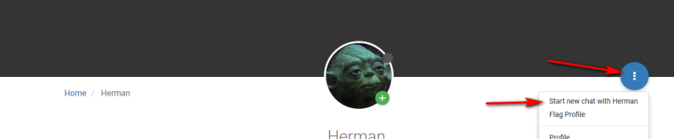

                                            Dude look at my profile - you figured out how to follow me..
                                            Click the 3 dots and then start conversation - or just answer the one I started with you.
