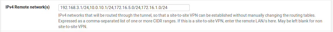

              Beginning with the working Tunnel:
              This one works without any issues, every network is accessable from my side (LAN @ 10.0.11.0/24)

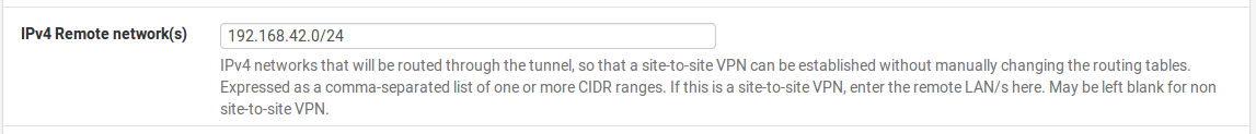

              Next is the same config for the radio network, this one is NOT (but should) accessable from my side (LAN @ 10.0.11.0/24):

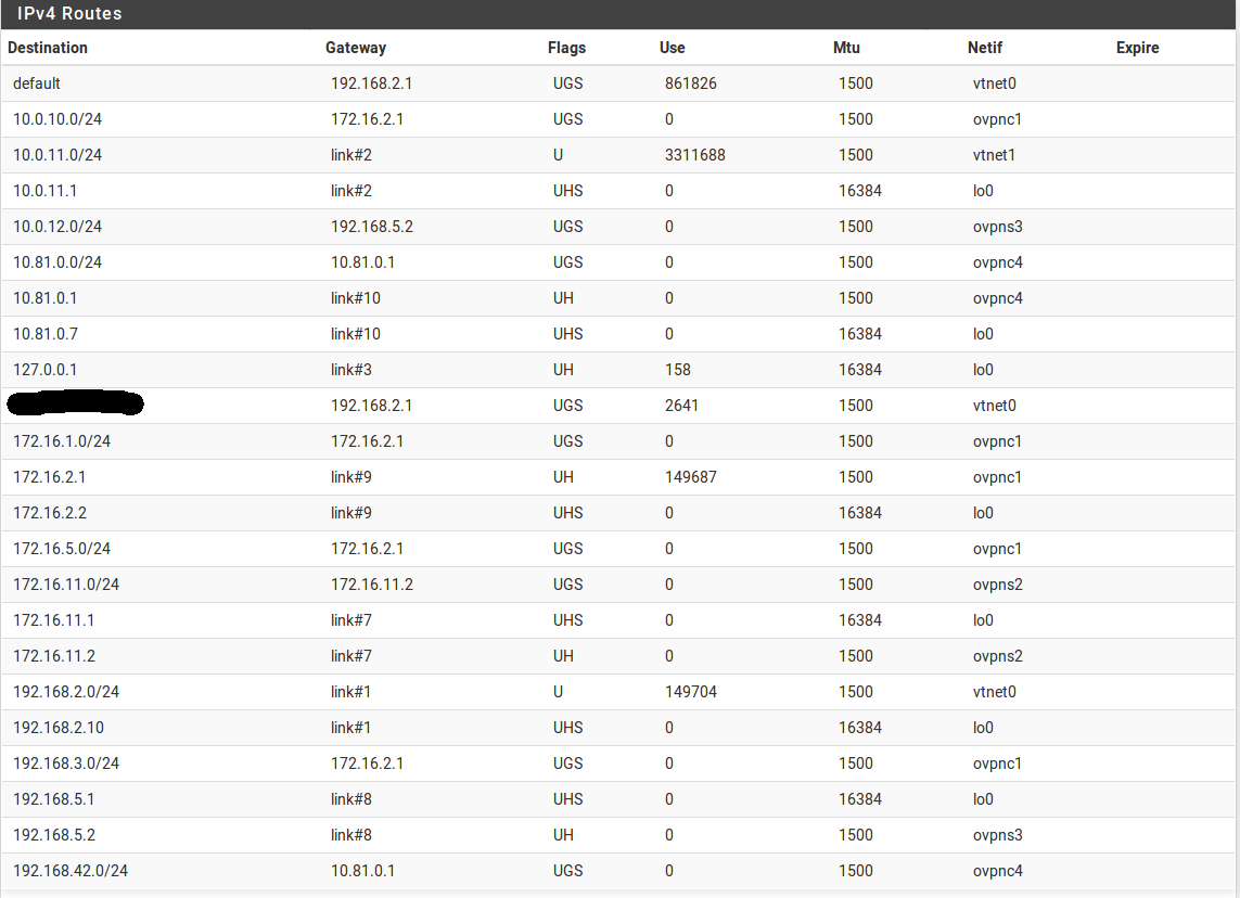

              Last but not least my Routes, as far as i can see this is correct in every way.
              I did everything the same in both tunnels, the first one works, the second one does not...

                          In your second picture.. You need to add your LAN to the Remote Networks of that site. 10.0.11.0/24

                                Looking again your radio station router should not have its own LAN in the "remote networks" entry..

                                  Chris-The-Tuner
                                  Yep that eas the problem.
                                  I just mapped the traffic from my LAN to the IP i get from the VPN Server so that i show up as a Single VPN Client and not as a LAN workstation.
                                  Works fine now :)
                                  Thank you very mutch !
