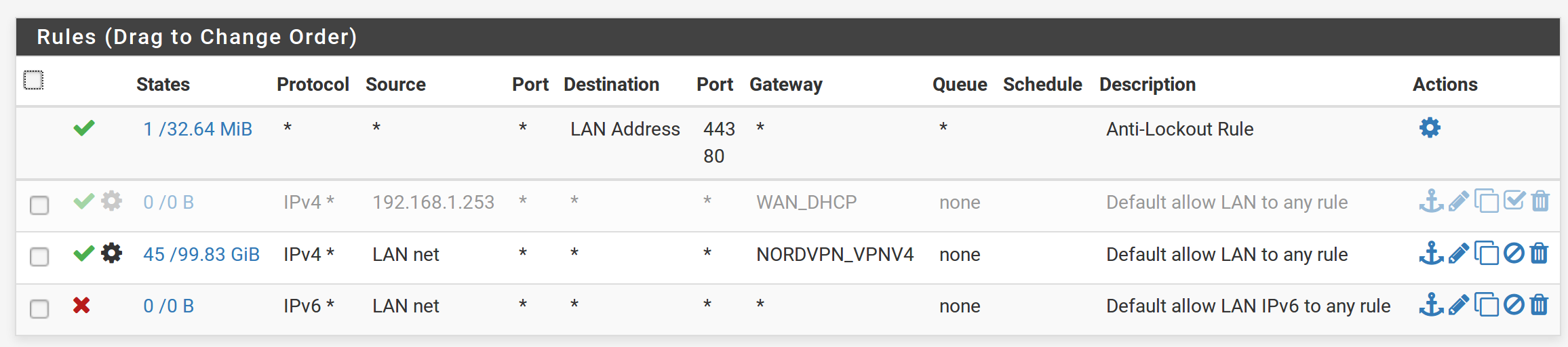

      I have below setup allowing a single device access via WAN Gateway (non-VPN), all others via VPN Gateway only. The issue is, my single device doesn't get the internet connection at all after this setup: (please let me know if you need more information on the setup). My idea is to have couple of devices go through the non-VPN gateway, how can I achieve this?

        @yupq6wlc79ts Hey
        See my rules
        The order of the rules is important
        I hope the picture will help you to understand how to do it

                What I see now from You is that all IPv4 traffic from Lan Net goes to the Internet through the NORDVPN gateway.

                  Yes. That's correct, all IPv4 traffic goes to Lan Net to Internet via NORDVPN. All I want now is, 5 specific devices should go directly to the internet without VPN.
                  So I started with 1 example of 192.168.1.253, and selected WAN_DHCP as a gateway. I don't get any internet via this rule, so I disabled it for now (screenshot). How can I achieve this?

                    Rules for 5 devices must be first
                    and the last one should be the rule for NORDVPN
                    A deny rule for IPv6 does not need

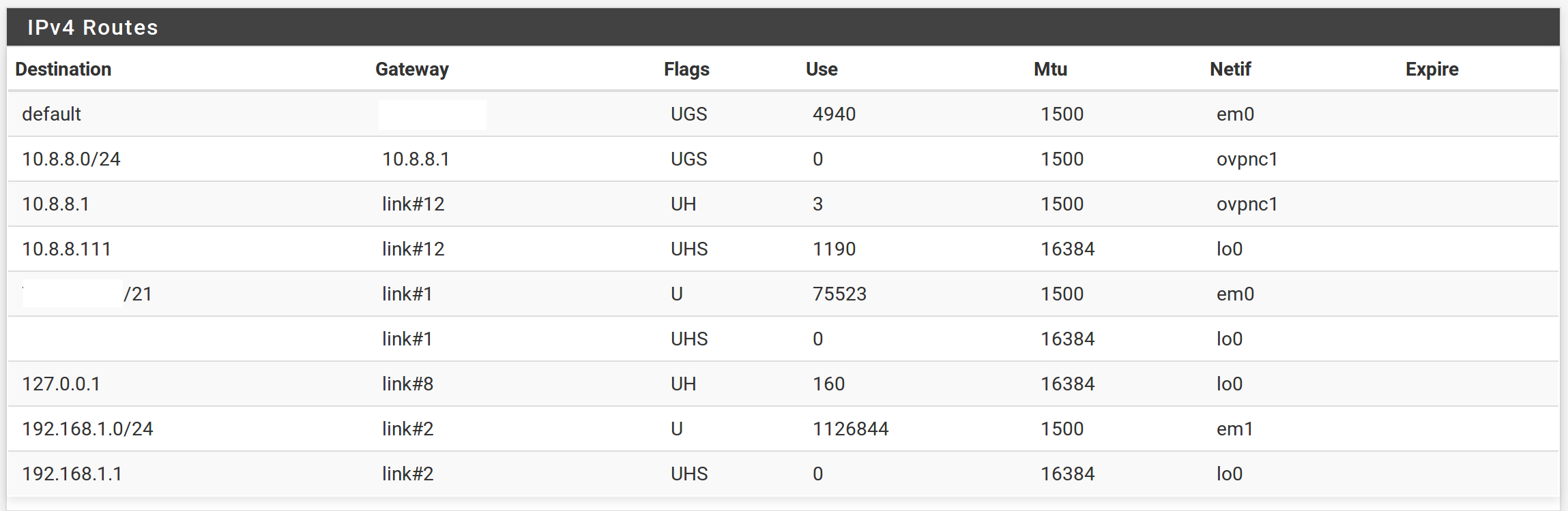

                                  • K Offline
                                    Konstanti @yupq6wlc79ts
                                    @yupq6wlc79ts
                                    all right now.

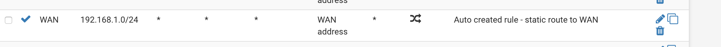

                                    check nat / outbound for wan interface

                                        Here is and mistake
                                        no nat rule for wan 192.168.1.0/24
                                        It is necessary to add

                                            Add a nat outbound rule for the 192.168.1.0/24 on the wan interface as I showed in the picture
                                            and 5 devices will be able to access the Internet via wan
