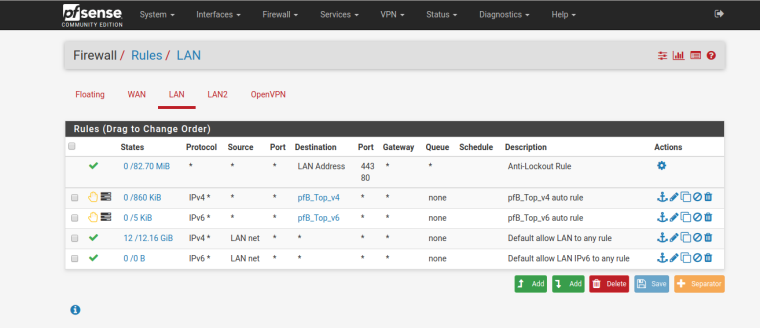

          Here are my firewall rules. Yes, PFsense is the gateway for everything. Web UI is available at 192.168.1.1 for Lan1, 192.168.2.1 for Lan2. Every machine is Linux so it won't be an issue client side. I can ssh to the machine on Lan2 if I use the public IP address (Virtual IP with 1:1 nat for that machine), but I can't ssh from 192.168.1.0/24.

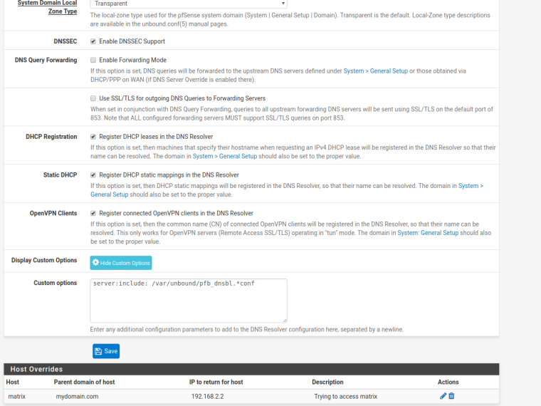

                                    @bepo So, I went to DNS resolver and selected host overrides. Under 'host' I put the hostname displayed for hostname in the DHCP static mapping page. For domain I entered mydomain.com, and I entered the local address of the server as the 'IP to return to host'. That hasn't worked though, so was I on the right path or should I delete that host override?

                                          @bepo I've done that, but it isn't working. I ran traceroute to mydomain.com but it is only showing the public ip address, and I still can't log in to the server from Lan. Does anything need to be added/checked under 'DNS server settings' in general setup? At the moment that section is blank.

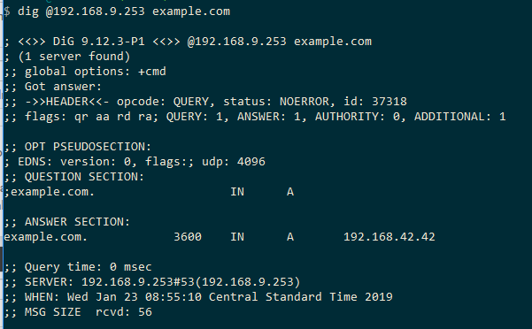

                                            But just create a record like this..
                                            Now if your client points to pfsense it should resolve to that... Make sure you put it in the right place if your using the forwarder on pfsense you put it there, default is resolver (unbound) and you would put it there.
                                            If your client is not using pfsense for dns - then you would have to use the redirect method.
                                            if really is just example.com then the host would be example and the domain would just be com
                                            query to validate
                                            Clearly you would use your own local IP ;) I shouldn't have to say that - but you would be surprised! ;)
