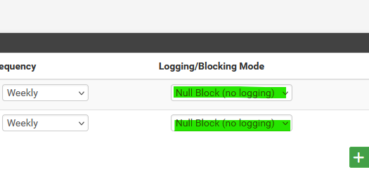

What was missing was I left "BNSBL Mode" on Unbound (default) rather than setting it to "Unbound Python mode". That one checkbox and a reload and logging is working perfectly.

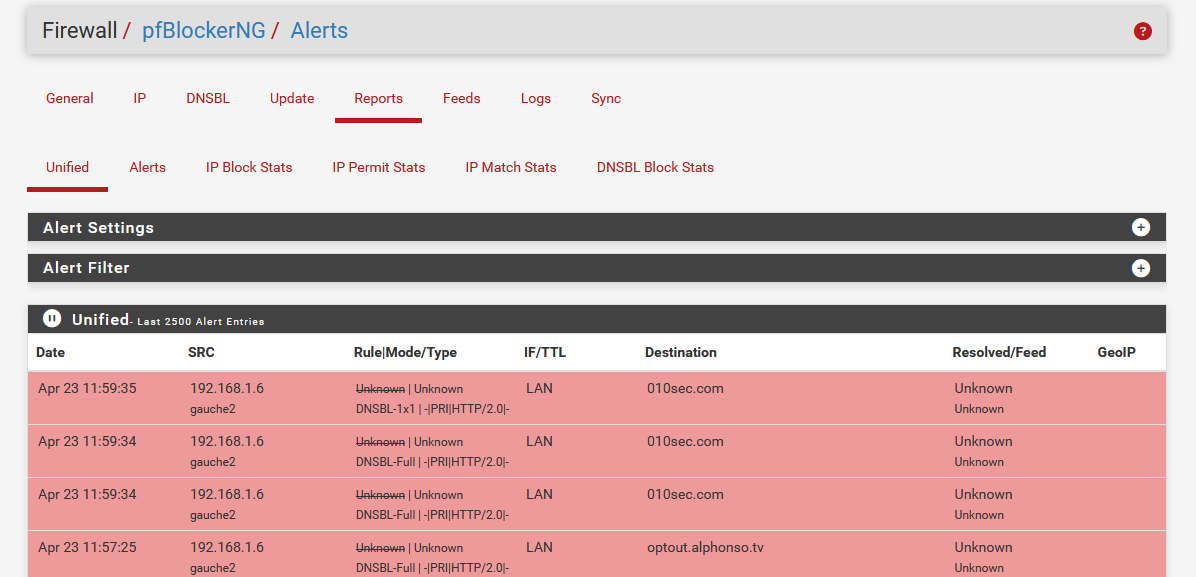

I switched from Python to unbound mode :
I tested with a listed DNDBL host entry (StevenBlack's list) 010sec.com

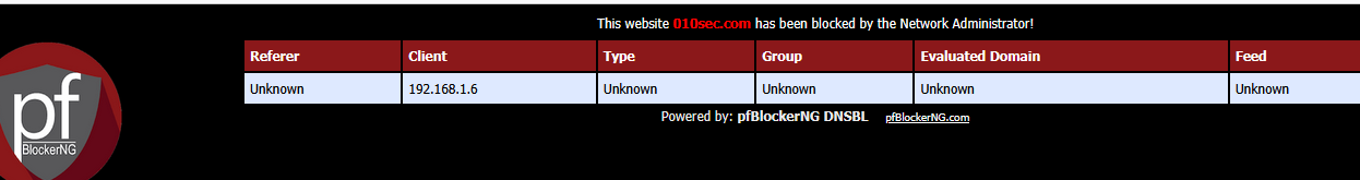

Sure enough : using http, not https ....
and sure enough :
So Python mode isn't mandatory to make this work.
Btw : I really though everybody had abandoned "unbound mode" by now .... as Python mode is way better/faster/much cooler ^^
That said : imho, you can safely forget about that pFb black web server page that shows up when a visitor visits a site that is blocked.It's something that worked well in the past, when all sites were http based. Because : it needs http sites to actually work - not https.
