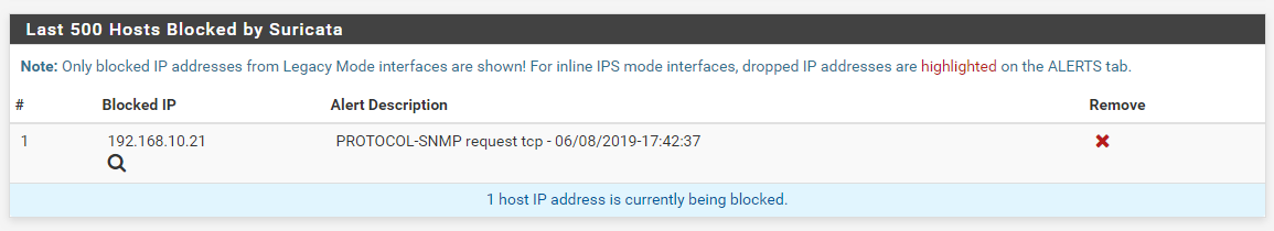

          To be sure blocking is working, I just installed the latest 4.1.4_2 version of Suricata on a virtual machine and then scanned the WAN IP address of that virtual machine from a Kali Linux host using nmap. I enabled the emerging-scan rules in Suricata.
          Here are some of the alerts from the nmap scan:
          And here is the BLOCKS tab showing the Kalin Linux host getting blocked. The Kali Linux IP address is 192.168.10.21:
          So Suricata appears to be working fine. You have something quite out of shape in your firewall. Those warning messages about receiving an invalid IP are not normal!

                  Just to be clear, are you seeing alerts on the ALERTS tab that correspond with IP addresses that should be blocked? I need to be sure you are getting the proper alerts first. I tried to reproduce this behavior for the previous poster but was unable to do so. He wiped and reloaded pfSense and his error went away (according to his last post).
                  B 2 Replies Last reply Reply Quote 0
                  • B Offline
                    bose301s @bmeeks
                    • B Offline
                      bose301s @bmeeks
                      @bmeeks Here is my Alert list which I would think should cause at least one block:
                      Here is my Block list with no blocks:
                      bmeeksB 1 Reply Last reply Reply Quote 1
                      • bmeeksB Offline
                        bmeeks @bose301s
                        @bose301s: and one last question, is the "Which IP to Block" setting on the INTERFACE SETTINGS tab set to BOTH, or DST or SRC? BOTH is the default.
                        Edit: Oh, and you do not have Block on Drops only set do you? If so, have you changed your rule actions to DROP from their default of ALERT?
                        Just checking all the obvious things first.
                        • B Offline
                          bose301s @bmeeks
                          @bmeeks said in Suricata 4.1.4_2 not blocking hosts:
                          The which IP to block is set to BOTH and I did not change it to Block on Drops.
                          • bmeeksB Offline
                            bmeeks @bose301s
                            @bose301s:
                            Okay. I will look into this again. It very well may be related to a bug fix I did to correct a problem with Suricata failing to start on interfaces with a /31 subnet mask.
                            So that I can test with the exact same IP configuration, will you PM me the IP address and subnet mask for your WAN link? If it is what I suspect, then certain types of IP subnets may trigger the problem, and using yours can help me locate it. You can do that using the Chat icon at the top right corner of this page.
                              ryan_g
                              I am having the identical problem with 4.1.4_3 after updating. I have not tried rebuilding the entire router but wiping Suricata and reinstalling/re-configuring has not made a difference. Alerts are showing properly, just no blocks. I will message my IP if that helps.
                              • B Offline
                                bose301s @bmeeks
                                @bose301s:
                                I am really new to pfSense, do you need my public IP and the Subnet?
                                  jchud
                                  I recently upgrade to 4.1.4_3 and am having the same issue where it is alerting but not blocking. And when I tried rebooting my pfsense box this morning it failed to properly come back up, displaying a ton of errors to the console. Just got done rebuilding me entire pfsense box and still having the same issue.
                                  • bmeeksB Offline
                                    bmeeks @ryan_g
                                    @ryan_g : I received your info. Thanks. Will look into this problem. I am pretty sure I introduced it by fixing another issue reported on Redmine with /31 point-to-point subnets.
                                    • bmeeksB Offline
                                      bmeeks @jchud
                                      @jchud said in Suricata 4.1.4_2 not blocking hosts:
                                      I suspect this is a common problem, and likely one I inadvertenly introduced while fixing another reported bug. I will get this one fixed.
                                      • bmeeksB Offline
                                        bmeeks @bose301s
                                        @bose301s said in Suricata 4.1.4_2 not blocking hosts:
                                        @bose301s:
                                        See my PM reply to you. Was away for a while and replied to your post after it was 5 hours old.
                                        • bmeeksB Offline
                                          bmeeks
                                          To anyone else experiencing this issue of the latest Suricata package not blocking hosts when Legacy Mode blocking is enabled, I am aware and looking into the fix. Pretty sure this is a side effect from fixing another different bug. The issue is within the custom blocking plugin I wrote for Suricata, so I will have to patch and then submit an updated Suricata binary to correct the problem.
                                          • bmeeksB Offline
                                            bmeeks
                                            The fix for this bug is posted for the pfSense team to review and merge. I've asked them to expedite this one, so keep checking for a new Suricata package to show up in PACKAGE MANAGER either later today or early tomorrow.
                                            The pull request for the fix is here: https://github.com/pfsense/FreeBSD-ports/pull/652.
