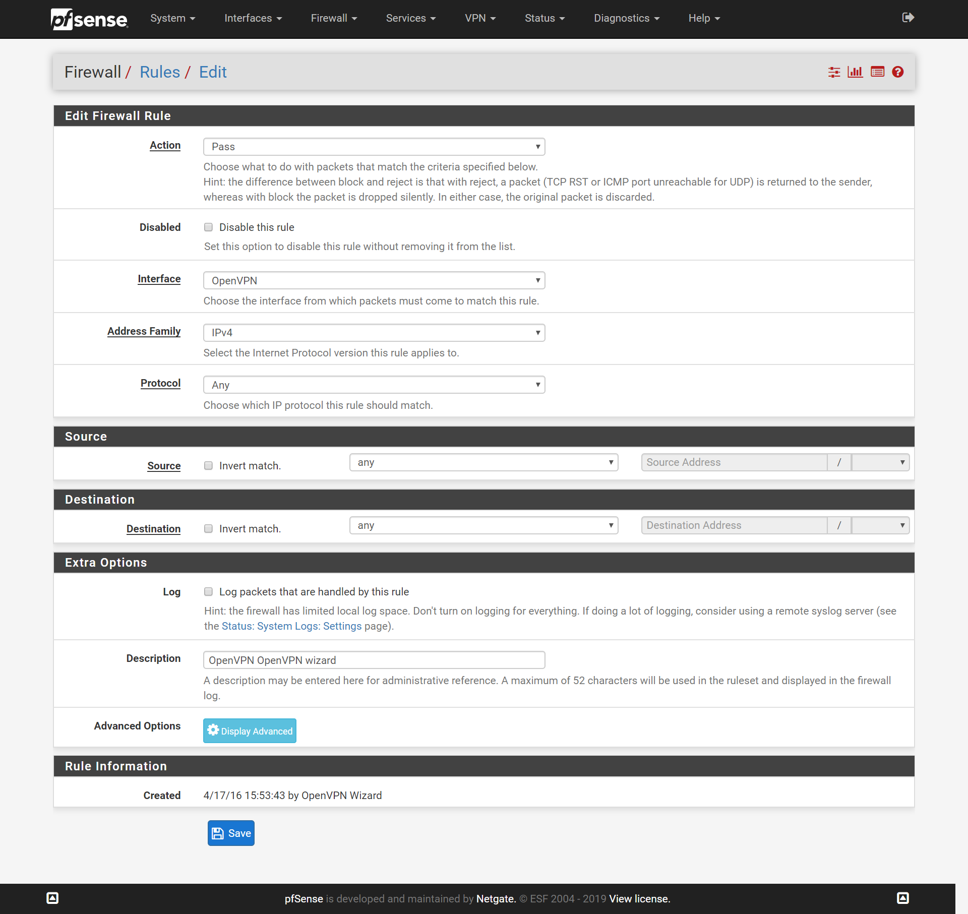

                              my firewall in pfsense has a rule for openvpn interface to pass any protocal from ipv4
                              source and destination is set to any.
                              do i need another firewall rule in pfsense?
                              • DerelictD Offline
                                Derelict LAYER 8 Netgate
                                Post said rule.
                                Chattanooga, Tennessee, USA
                                  ariban99 @Derelict
                                  @Derelict see attached
                                  sorry for the delay in responses, i have to wait 120 seconds between each postscreencapture-192-168-1-1-firewall-rules-edit-php-2019-07-02-17_39_13.png
                                  • DerelictD Offline
                                    OK it's not that. check the firewalls on the target hosts.
