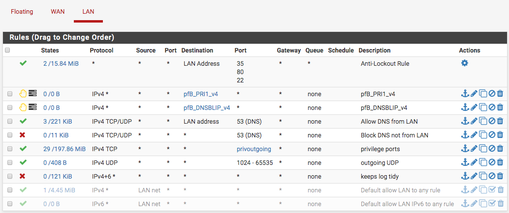

      Here is my LAN firewall that was inspired by the thread "Taming the Beast." However, I notice privilege ports, just the TCP is seeing traffic...could the default rule below maybe overriding...did I get it wrong or I just don't have any UDP traffic now? I disabled IPv6 addresses.

        Gertjan
        Use an application that actually uses UDP ;)

              I really don't see the point to some of those rules.. Your allowing privout and then all the above ports, but then under that you have any rule.. Your not logging those - so what exactly do you think the point of those are?
              NollipfSenseN 2 Replies Last reply Reply Quote 1

                @NogBadTheBad Thanks NogBadTheBad...that's the kind of feedback I am seeking...yes, it'd done by pfSense; so, I'll make the change.

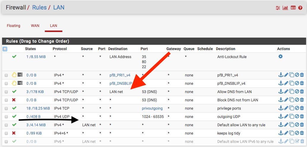

                    @johnpoz Okay Johnpoz, I disabled the any rule and move up the block all.
                      @NollipfSense said in Firewall Feedback:
                      How you could tell that those (privout and UDP) aren't logged?
                      Because they don't have the log icon next to them..
                      I would of just gone the other way and removed those rules.. And left the any... With your current rules you can not even ping anything not even pfsense own lan IP.
                      I can think of a few UDP ports that your blocking, NTP and QUIC or HTTP/3 that could be causing you issue going forward with such rules. ESP and AH come to mind as well that could be causing your clients issue.
                      If your wanting to lock down to only used ports/protocols - its prob better to log your any rule for a while and then figure out what is being used on your network, and then create the rules to allow what you want.
                      Also since your not logging the block rule you have there - you will not know what clients are banging on the door to let them out ;) Which just becomes unwanted noise on your network, which might be better to reject or turn off such protocols/applications your not going to allow out off on the client side, etc.
                      NollipfSenseN 1 Reply Last reply Reply Quote 0

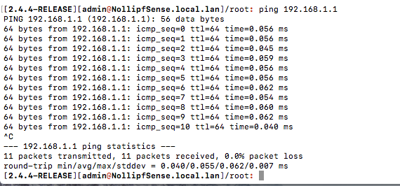

                        Okay Johnpoz, I really appreciate your input...I turned on logging; however, I was able to ping pfSense lan IP!

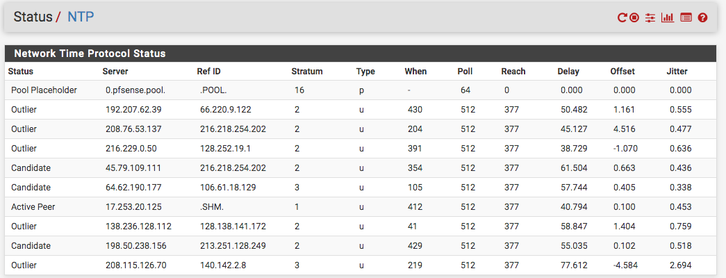

                        I am curious about the NTP (TCP/UDP) as well as the other UDP ports such ESP and AH (1701, 4500)...wouldn't they get covered by the privout and the UDP outgoing? In the pic below, is that an example of noise that you mentioned? Should I allow a rule with NTP protocol?

                          Your pinging pfsense from itself - no shit you can do that ;) heheheheeh Ping it from a client on your lan.. Your rules do not allow it.
                          No they wouldn't ntp is port 123 UDP, which you have set to 1204 and above. QUIC, or now called http/3 is UDP 80, etc.

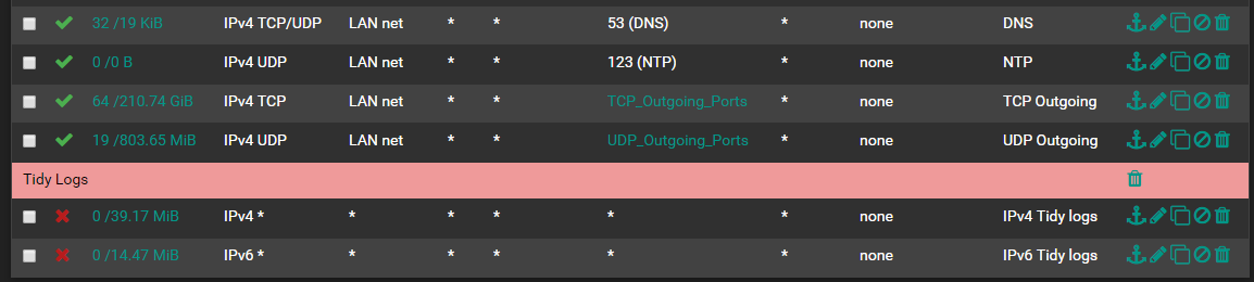

                                      @johnpoz Hey Johnpoz, this is how it is now...I understand what you were saying about the default any-any rule...I could not do without it as Internet radio breaks...I suspect it uses the lower UDP ports.
