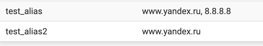

                            [2.4.4-RELEASE][admin@pfSense.localdomain]/root: pfctl -t test_alias -Ts
                               5.255.255.5
                               5.255.255.50
                               8.8.8.8
                               77.88.55.50
                               77.88.55.88
                               2a02:6b8:a::a
                            [2.4.4-RELEASE][admin@pfSense.localdomain]/root: pfctl -t test_alias2 -Ts
                               5.255.255.5
                               5.255.255.50
                               77.88.55.50
                               77.88.55.88
                               2a02:6b8:a::a

                              • K Offline
                                Konstanti @werter
                                @werter

                                Jan 14 14:45:39 pfSense filterdns: 	Awaking from the sleep for hostname 8.8.8.8 (1)
                                Jan 14 14:50:39 pfSense filterdns: 	Awaking from the sleep for hostname 8.8.8.8 (1)
                                Jan 14 14:50:39 pfSense filterdns: 	Awaking from the sleep for hostname www.yandex.ru (2)
                                Jan 14 14:55:39 pfSense filterdns: 	Awaking from the sleep for hostname www.yandex.ru (2)
                                Jan 14 14:55:39 pfSense filterdns: 	Awaking from the sleep for hostname 8.8.8.8 (1)
                                Jan 14 15:00:39 pfSense filterdns: 	Awaking from the sleep for hostname www.yandex.ru (2)
                                Jan 14 15:00:39 pfSense filterdns: 	Awaking from the sleep for hostname 8.8.8.8 (1)
                                Jan 14 15:00:39 pfSense filterdns: 			adding address 77.88.55.70 for host www.yandex.ru
                                Jan 14 15:00:39 pfSense filterdns: 			removing address 77.88.55.60 from host www.yandex.ru
                                Jan 14 15:00:39 pfSense filterdns: Change detected on host: www.yandex.ru
                                Jan 14 15:00:39 pfSense filterdns: 	Awaking from the sleep for type: pf table: test_alias hostname: www.yandex.ru
                                Jan 14 15:00:39 pfSense filterdns: 		Added pf address, table: test_alias host: www.yandex.ru address: 77.88.55.70
                                Jan 14 15:00:39 pfSense filterdns: 		FAILED to remove pf address, table: test_alias host: www.yandex.ru address: 77.88.55.60 error: -1
                                Jan 14 15:00:39 pfSense filterdns: 	Updated pf table test_alias host: www.yandex.ru error: -1
                                Jan 14 15:00:39 pfSense filterdns: 	Awaking from the sleep for type: pf table: test_alias2 hostname: www.yandex.ru
                                Jan 14 15:00:39 pfSense filterdns: 		Added pf address, table: test_alias2 host: www.yandex.ru address: 77.88.55.70
                                Jan 14 15:00:39 pfSense filterdns: 		FAILED to remove pf address, table: test_alias2 host: www.yandex.ru address: 77.88.55.60 error: -1
                                Jan 14 15:00:39 pfSense filterdns: 	Updated pf table test_alias2 host: www.yandex.ru error: -1
                                Jan 14 15:05:39 pfSense filterdns: 	Awaking from the sleep for hostname 8.8.8.8 (1)
                                • werterW Offline
                                  werter
                                  @Konstanti
                                  Супер. Осталось 2.4.5 дождаться )
                                  • K Offline
                                    Konstanti @werter
                                    @werter
                                    Ну , да )))
                                    В процессе тестирования вылезла одна ошибка
                                    Я у себя ее поправил , теперь все работает нормально ,по-моему
                                    Было
                                    Стало
                                    Jan 16 17:37:57 pfSense filterdns: 	Awaking from the sleep for hostname www.netflix.com (2)
                                    Jan 16 17:37:57 pfSense filterdns: 			adding address 54.84.155.179 for host www.netflix.com
                                    Jan 16 17:37:57 pfSense filterdns: 			removing address 52.20.168.249 from host www.netflix.com
                                    Jan 16 17:37:57 pfSense filterdns: 	Updated pf table test_alias host: www.netflix.com error: 0
                                    Те программа отрабатывала нормально , но в логах писала об ошибке
