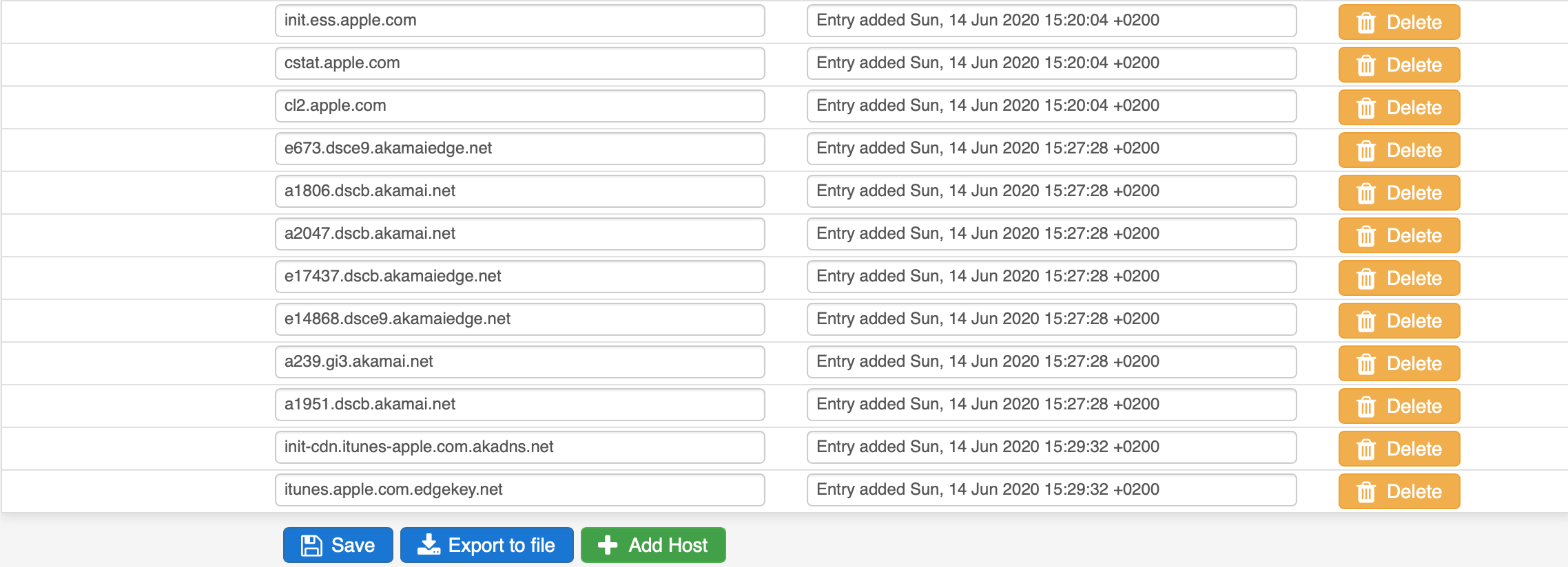

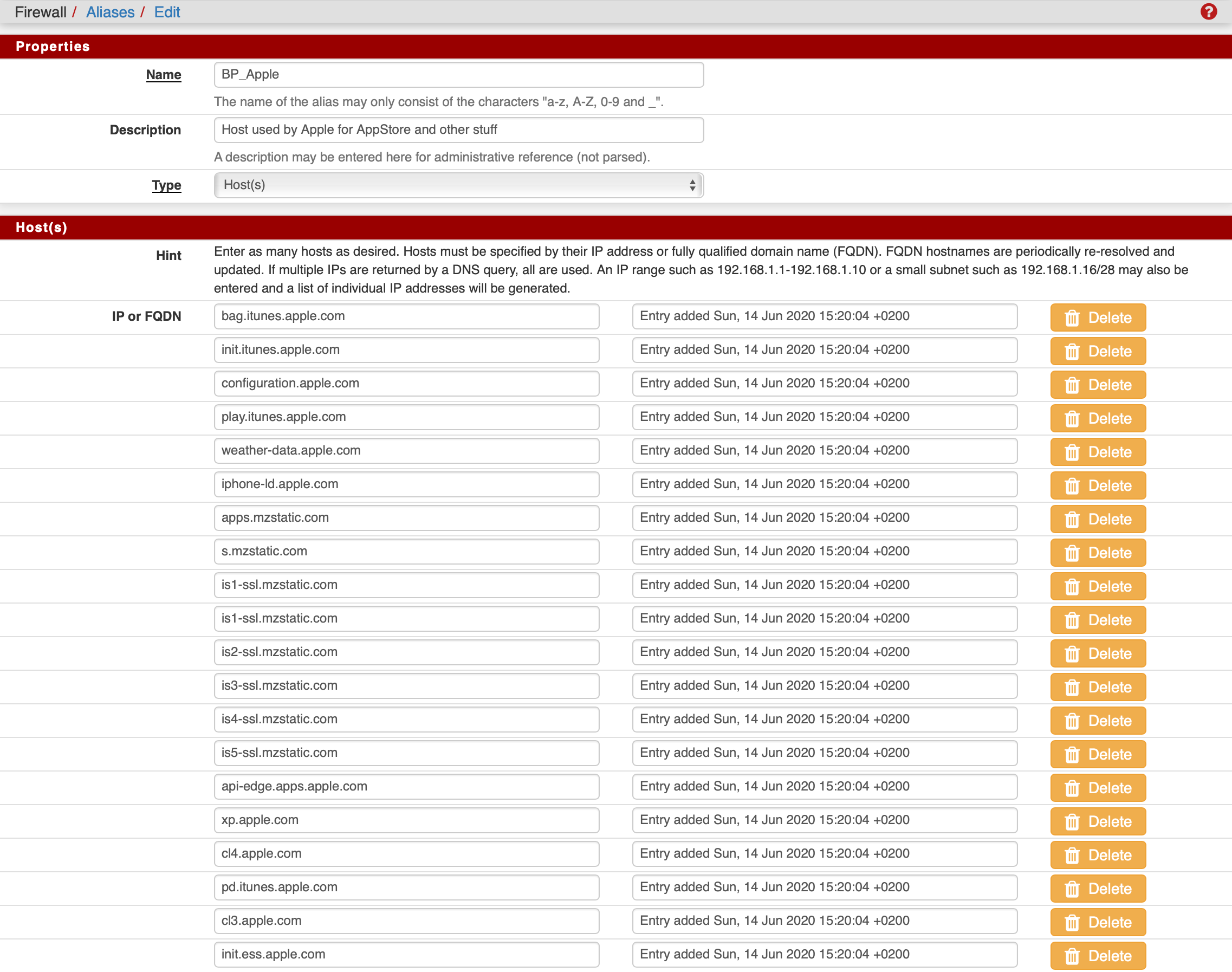

                                  @xalex1977 larksuite.com is running on a CDN. We faced the same issues like you, with other and more dramatic consequences (squid crashes and so on). We pinned it down to DNS. We changed from Google-DNS to the local ones from our ISPs, we made DNS-Resolver work (and played with minimum TTLs), fixed our Windows-DNS Servers and disabled the name caches (which doesn't work, we clean them now manually every 5 Minutes via a script) and we disabled name-caching on our clients. Key is that your DNS between Pfsense, internal DNS and your clients is always sync. Squid is a b*tch if one of your boxes is responding with the wrong host or ips.
                                  We made for critical sites (like SAP C4C) static host overrides because they drive crazy with changing their IP every few minutes. All in all i'm very happy right now with or setup!
                                  Another trick we learned that you can use an Alias in Squid to Bypass traffic like for services hosted by Apple (iTunes, App-Store and so on). Key is that you add all known cnames from that cdn-hosted site to your Alias and add that Alias to Squid in the "bypass proxy for these destination IPs".
                                  I'm not a hardcore linux or network specialist but if you check your config, fix your dns and have everything in place it works pretty well. It is some work in the beginning (GotoMeeting, Teams and Apple stuff) and sometimes it's challenging but it will work!
