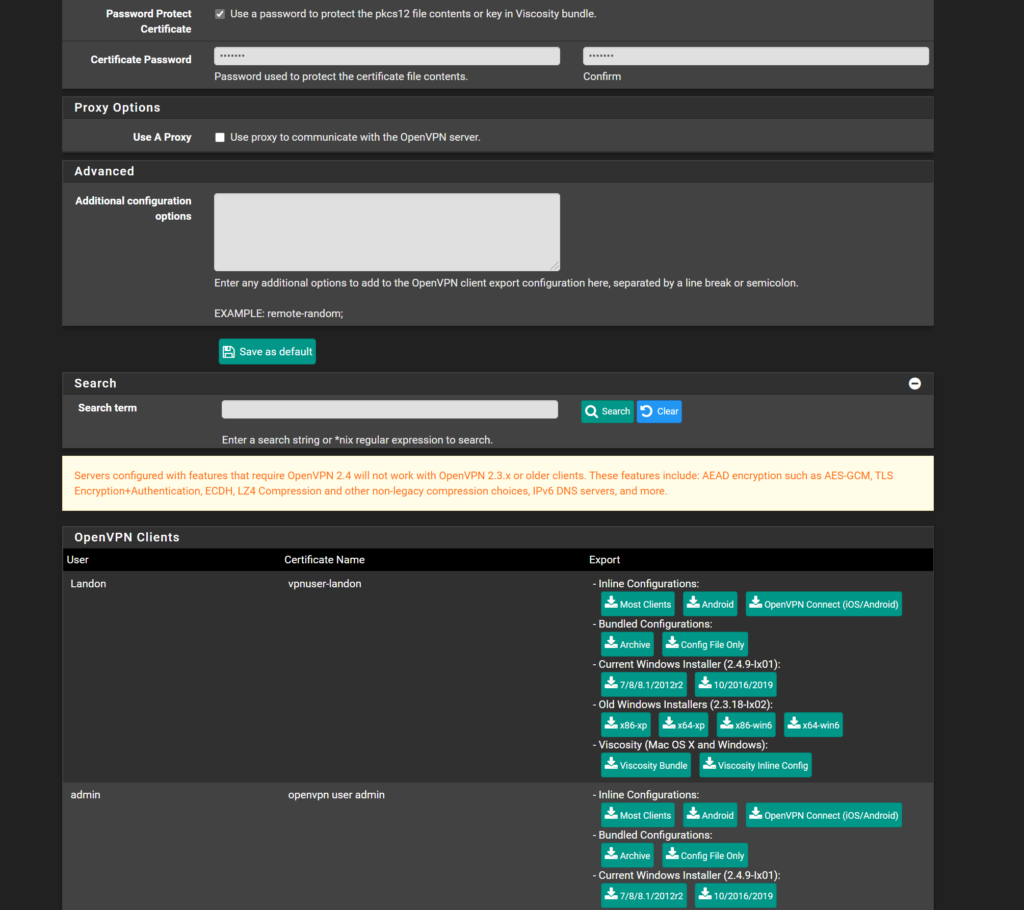

        I assume, you are using the NetworkManager on your Linux.
        Possibly you need to install the OpenVPN package for NM before you can go on.
        Set a password for the PKCS12 file in the client export utility and download the archive (bundled config).
        Extract it to a folder on you Linux and import the .ovpn in NM. Enter the password for the private key and your user date and connect.
        That's the whole magic.

                        @comet424 said in having issues connecting to OpenVPN from Linux Lite:
                        doesnt matter tried Archive bundle before you can not import OVPN its not a vaild file
                        What is the OpenVPN version on your Linux?
                        i still dont know what you mean "user date" whats the date i enter?
                        Username and password. However, if your server use SSL authentication only, there is no need for it.
                        The archive bundle contains 3 files only:
                        • .ovpn
                        • .p12
                        • .key
                        That's all you need.
                        As shown in your screenshot, the p12 has to be entered in the User Certificate, CA Cert and Private key box.
                        Underneath enter the password you've set in the client export utility.
                        1 Reply Last reply

                                So your LInux uses OpenVPN 2.3.10 as shown in the screenshot. That's a very old version and it's not capable of some current features of the pfSense OpenVPN.
                                That would be the reason for the config file import to fail. To configure the client manually won't help here, the connection will fail anyway.
                                You should get a new client version.
                                If you want to connect with that client, you may have to downgrade some settings of your OpenVPN server and reconfigure all your clients. Alternatively you may setup an additional server on another port for 2.3 clients.
                                Settings you may have to change for 2.3:
                                TLS Key Usage Mode: TLS Authentication
                                Encryption Algorithm: AES-xxx-CBC
                                Enable NCP: uncheck
                                Compression: disable or LZO
                                No IPv6 tunnel or networks
                                1 Reply Last reply
