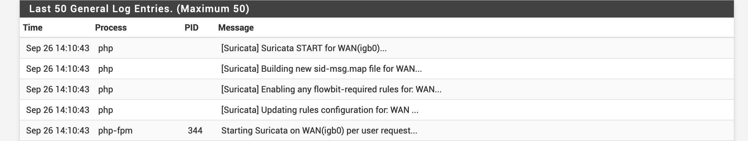

          I checked the System Logs/ System/ General and this is what I found:
          It says "START", but it immediately goes to the red "X"...doesn't even show the green check mark at all, not even a glimpse of it.

            Did you actually attempt to start it twice in quick succession? The log shows a start at 08:59:49, and then another start at 09:00:30. So roughly 40 seconds or so apart.

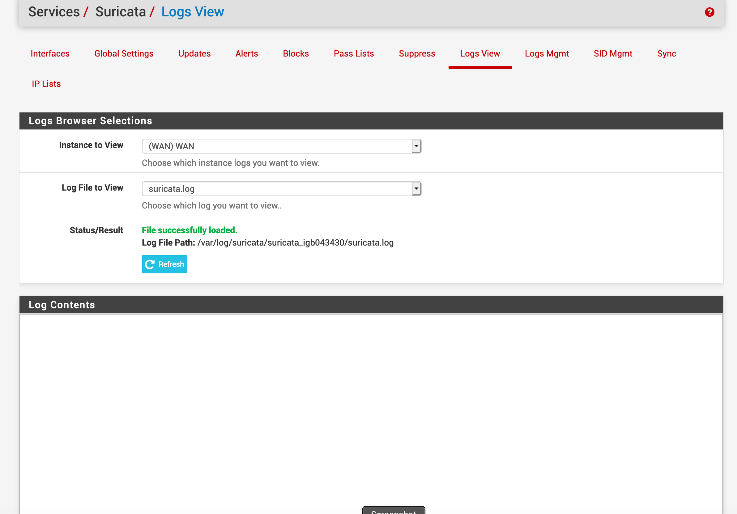

            Without attempting another start, go to the LOGS VIEW tab and make sure the WAN interface is selected in the drop-down selector there. Then choose the suricata.log file in the Which File To View selector. There should be something in that file giving a hint of what's wrong if the binary even tried to start. Post back whatever you find in that file. That file almost can't be blank if the binary even begins to start. One of the very first things that happens is the version string is written to that log. The fact you say this command works with no errors --
            /usr/local/bin/suricata -V
            indicates to me that the binary at least is starting and can find its basic dependent shared libraries.
            Are there any other Suricata related messages in your system log? If so, post those as well. In particular are there any errors related to Signal 11 or Signal 10 with Suricata?

              Here is what the log screen looks like, without starting another session.

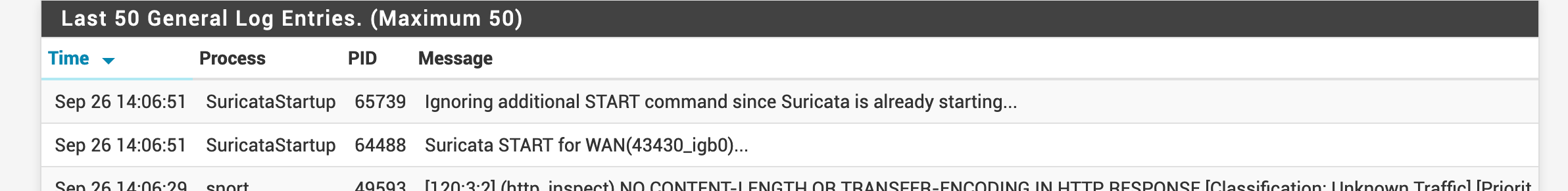

              Then I hit start, this is what is in the system log:
              Then after a few minutes, I hit start again, I also quit Snort (I have snort running because suricata is not working..):
              And again it went to the red X. I hti start one more time...
              And still red X, still no logs in suricata.

                You have something trying to start two identical instances of Suricata on that interface. See that line that says "...Ignoring additional START command since Suricata is already starting..."? That is an unexpected condition. There should not be two starts happening. That message is coming from the shell script in /usr/local/etc/rc.d that is used to start Suricata when the firewall reboots or when you click the icon in the SERVICES widget.
                Do you have the Service Watchdog package installed, and if so, is it configured to watch Suricata?
                You have something weird going on in your system if the shell script is trying to start Suricata while you are using the GUI icons to do the same. That's why you are having problems.
