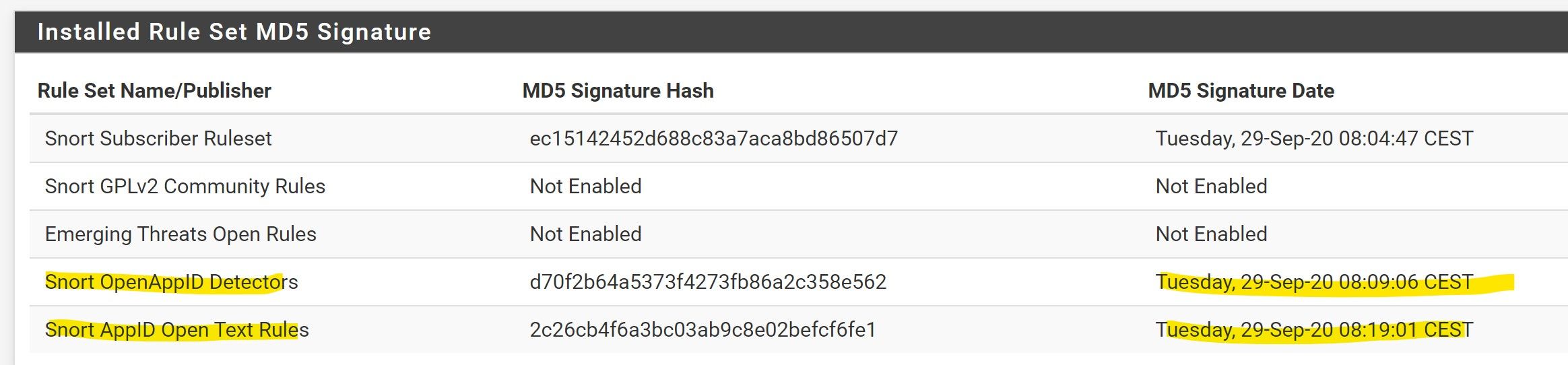

I did the following, and still no luck:
Installed the OpenApp ID Detector Rules and download
Installed AppID Text Rules and download
Activated all appid rules

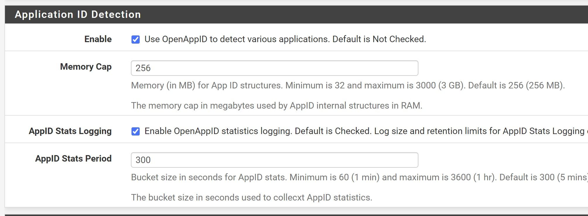

Enabled AppID detection and AppStats Logging

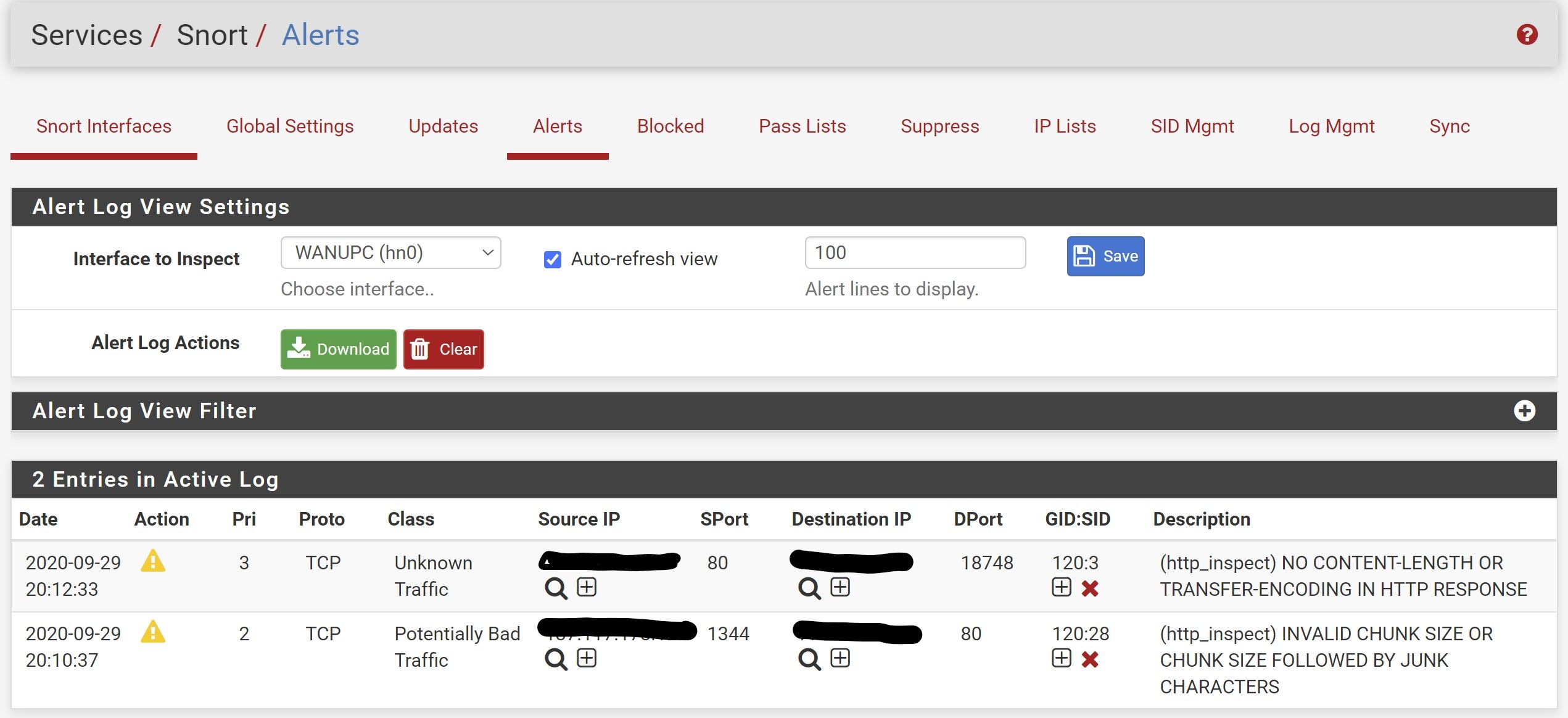

Hm.. but in the ALERTS i don't have anything from AppID as you can see in the screenshot. Shouldn't the recognized apps not fire alerts as well?

statTime="1601402700",appName="__unknown",txBytes="3255",rxBytes="110926"Alerts window:
You will only get alerts from OpenAppID text rules that are enabled (not commented out, for example, in the rules file) and that match traffic.
