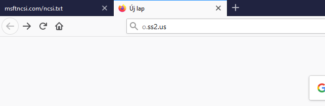

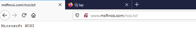

      Just for the sake of the test we installed the new Win10 release (20H2 clean install) and ...
      The pfBlockerNG is currently unable to do anything at this point...! and / or :-) ?
      a blocked target on a Win10 1909 machine, for example (msftncsi.com or o.ss2.us):
      or
      the same on a 20H2 windows machine:
      or
      o.ss2.us = redirect to https://www.starfieldtech.com/
      the network settings are exactly the same on the two computers (except IPs RFC1918, :-)):
      PC config via DHCP - pfSense DNS - pfBlockerNG

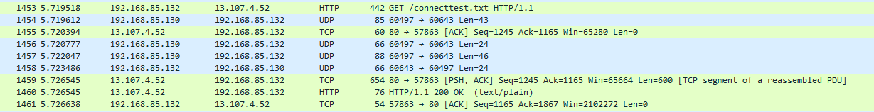

              I understand that, but did you see Wireshark?
              MS connecttest is disabled everywhere on the network, but on this one machine, pfBlockerNG is bypassed
              (since connecttest runs on an external web server of its own)
              in addition, it uses a new MS IP (for me new): 13.107.4.52 - instead of this 131.107.255.255
              where does it get DNS from?

                  The WS *.pcap basically shows port 80, hmmmm
                  the way it works http - http://www.msftconnecttest.com/connecttest.txt
                  or
                  http://www.msftncsi.com/ncsi.txt
                  therefore I am completely lost...it can be inside in advance...
                  but as you can see it downloads the connecttest.txt file
                  200 OK
                  and pfBlockerNG is bypassed!
                  13.107.4.52...- <h2>Our services aren't available right now</h2><p>We're working to restore all services as soon as possible. Please check back soon.</p>08Lu2XwAAAADuj8s0xzLNRqgGp76wBEbWTElTMDFFREdFMDMxNQBFZGdl

                                  --- o.s22.us
                                  I'll show you again,
                                  this domain is blocked by us..., o.ss2.us via DNSBL feed
                                  Win1909:
                                  test PC on clean 20H2:
                                  network setup:
                                  pfSense IP is: 192.168.85.1
                                  igen = yes
                                  DHCP kiszolgรกlรณ = DHCP server
                                  (sorry for the hungarian OS language)

                                  192.168.85.130 on Win1909
                                  no entry from 192.168.85.132 on win 20H2
                                    You would prob get better help on some MS forum.. While this I guess could be related to pfblocker.. If said device doesn't ask pfblocker for dns, that is not pfsense or pfblocker that keeps the client from doing that.
                                    Why said client doesn't use your assigned dns, would be up to the client.. No matter what you hand it via dhcp.
                                    I wouldn't block that mfsft site for sure.. That is a well known domain in how windows check if it has internet, etc. Blocking it could for sure kick in other methods of the OS trying to see if it has any sort of internet connectivity..

                                      so as I wrote above we run an external connecttest server, this is not an MS denial...
                                      it was just enough of the voyeur or something...
                                      not really a pfSense or pfBlockerNG theme (issue), yet ... you are right (let's say it's a simple statement)

                                        (maybe the Wireshark isn't lying??!!)
