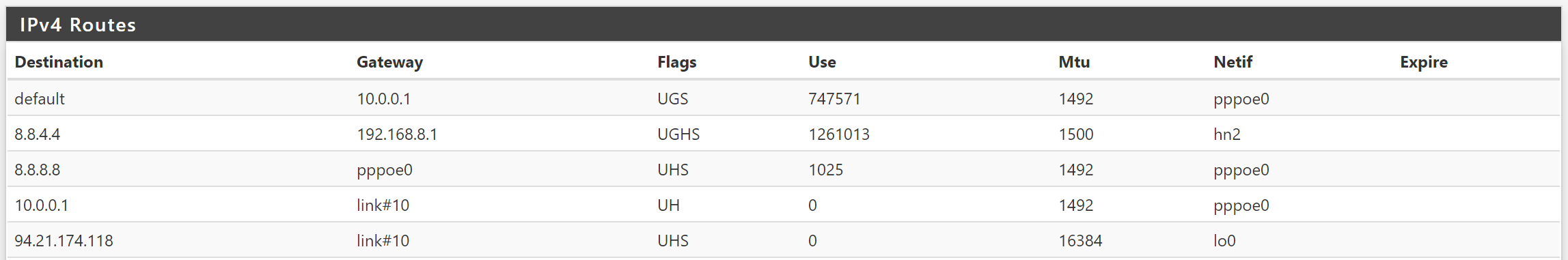

      Oddly, the error message that OpenVPN logs shows that it is trying to bind to the "old" IP address:
      OpenVPN log:
      Nov 27 05:13:14	openvpn	93648	/usr/local/sbin/ovpn-linkdown ovpns1 1500 1572 192.168.253.1 192.168.253.2 init
      Nov 27 05:13:14	openvpn	93648	Exiting due to fatal error
      Nov 27 05:13:14	openvpn	93648	TCP/UDP: Socket bind failed on local address [AF_INET]94.21.55.69:1194: Can't assign requested address (errno=49)
      Nov 27 05:13:14	openvpn	93648	Preserving previous TUN/TAP instance: ovpns1
      Nov 27 05:13:14	openvpn	93648	Re-using pre-shared static key
      Nov 27 05:13:14	openvpn	93648	NOTE: the current --script-security setting may allow this configuration to call user-defined scripts
      Nov 27 05:13:09	openvpn	93648	SIGUSR1[soft,ping-restart] received, process restarting
      Nov 27 05:13:09	openvpn	93648	Inactivity timeout (--ping-restart), restarting
      System log just before this:
      Nov 27 05:14:30	kernel		pid 129 (ntopng), jid 0, uid 0: exited on signal 11 (core dumped)
      Nov 27 05:13:14	check_reload_status		Reloading filter
      Nov 27 05:13:14	kernel		ovpns1: link state changed to DOWN
      Nov 27 05:12:27	check_reload_status		Starting packages
      Nov 27 05:12:14	check_reload_status		rc.newwanip starting pppoe0
      Nov 27 05:12:14	ppp		[wan] 84.236.40.239 -> 10.0.0.1
      Nov 27 05:12:14	ppp		[wan] IPCP: LayerUp
      Nov 27 05:12:14	ppp		[wan] IPCP: state change Ack-Sent --> Opened
      Nov 27 05:12:14	ppp		[wan] IPADDR 84.236.40.239
      Note, OpenVPN tries to bind to 94.21.55.69:1194 while the WAN interface has the IP 84.236.40.239 by then since about a minute ago. Looks like OpenVPN notices the connection down and tries to rebind to the wrong address.

          Your log shows :
          @mcfly9 said in OpenVPN quits on WAN IP change:
          If you're using pppoe, where does this "10.0.0.1" comes from ?
          A Modem type WAN device shouldn't offer a RFC1918.
          ntopng isn't happy neither.
          A coredump isn't the normal a process stops.
          to 94.a.b.c:1194 while the WAN interface has the IP 84.e.f.f
          Before openvpn restarts, its config file is recreated with the IP of the - typically - WAN interface at that moment.
          So, one minute after the WAN IP changed, your GUI > Status > Interfaces > IPv4 address still shows the old IP ?
          Also, 'packages' like openvpn are restarted when there is a new WAN IP. So when the new WAN IP is in place.
          You didn't not show enough info to locate the real problem.

                              Right. So the issue is not that the VPN connection drops. That is totally expected when the WAN IP changes. The issue is that in this process the OpenVPN service quits and is therefore not any more available to accept client connections.
                              @Gertjan said in OpenVPN quits on WAN IP change:
                              I am not sure, I was never able to witness this myself as this usually happens between 4am-6am, when the ISP decides to recycle my connection. My statement was based on the log entry of OpenVPN showing OpenVPN trying to bind to the old IP, approx. 1 minute after the WAN connection has received a new IP:

                                  Well, with PPPoE, it's not CGNAT. I get a publicly addressable and routed IP and I am able to accept incoming connections to any port (except tcp/25...).

                                    I have now enabled this setting (Reset all states if WAN IP Address changes) and will have a look what happens.

                                          So if it would be nat'ed, how would I be able to accept inbound connections to an arbitary UDP port?
                                          This is what I see on the interface:
                                          It's only the default gateway which is RFC1918.
                                          DaddyGoD JKnottJ 3 Replies Last reply Reply Quote 0
                                            since 😉 , DIGI a good head and all the ports are forwarded, but yours goes through his NAT
