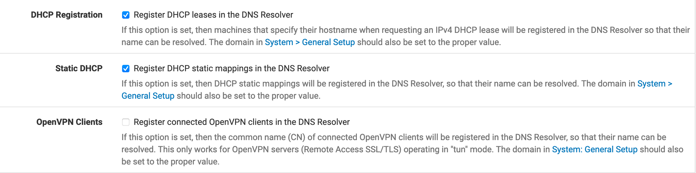

                                Original release notes:
                                "The DNS Resolver (Unbound) DHCP Registration option is not compatible with DNSBL Python mode. The pfSense devs are aware and changes are required to be made to the dhcpleases binary to stop/start Unbound instead of sending a SIGHUP. The use of this option and the Unbound Python mode will cause an Unbound crash.
                                If DHCP Registration is enabled in Unbound Python mode, or DHCP Registration enabled after Unbound Python mode is enabled, Unbound Python mode will be downgraded to Unbound mode to prevent Unbound from crashing."
                                • ? Offline
                                  First and third are a no go for sure, I can live with that. The second, static leases, would be a show stopper. I need to be able to resolve those devices and do reverse lookup for them.
                                  Of course using the non python mode removes these restrictions.
