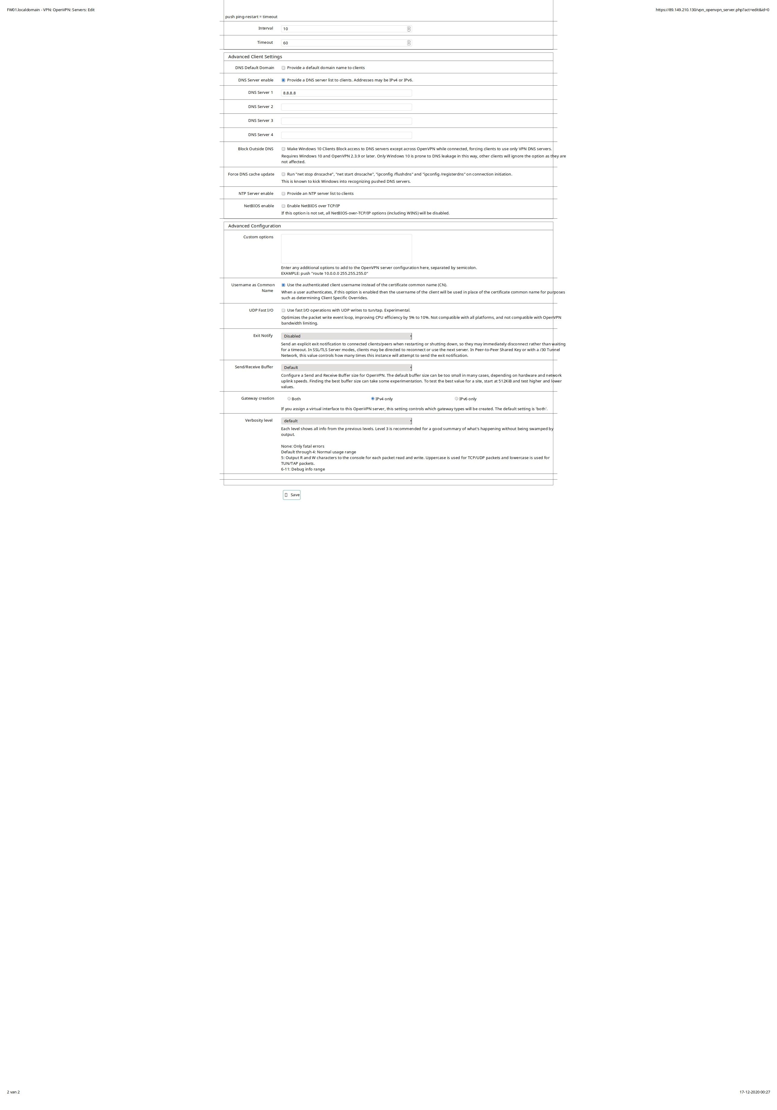

 @johnpoz Running the wizard again is exactly what I already did with for most the default settings, like Omit preference. Please give me 15 minutes, than I will upload the config.
 @johnpoz The[0_1608162720468_OpenVPN.config.pdf](Uploading 100%) config
 And what is not working? What does the log say on connection? Your not using encryption there your using just auth. Your not even using tls there.. And what are you using for auth? One sec an will post up mine here
 @johnpoz This is normally working. The problem is that when I set TLS Authentication to TLS Encryption and Authentication I don't get a connection anymore.
 Your not using TLS.. so how would it encrypt.. You just have user auth set, not remote (ssl/tls)
 @johnpoz You are right. Let me check again. I did that as well and also did not work, but I changed several other settings at the same time (stupid) and I had set it back to just the auth setting and now I forgot to enable SSL/TLS again.
