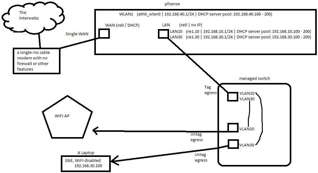

      Greetings! I am running 2.4.5-RELEASE-p1. Below is a diagram of my network
      Apologies in advance for using mspaint. I would like to add that ALL ipv6 is disabled/unused.
      I will post the output of my full firewall ruleset below. But apart from some NAT stuff for gaming on the WAN, I have all 3 of the local interfaces set to pass all/any ipv4 traffic.
      -The LAN10 and WLAN1 subnets send and receive from each other
      -The LAN10 and WLAN1 subnets send/receive WAN traffic
      -The LAN30 subnet cannot talk to any other subnet, or the WAN, nor can devices on LAN30 ping the LAN30 gateway.
      -The LAN30 DHCP server assigns a DHCP address to the laptop_ on the VLAN30 switchport on the managed switch.
      -When the laptop attempts to access anything, it times out or fails.

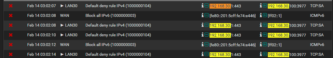

      -When I check the firewall logs, the traffic is absolutely getting to pfsense, but it's being blocked by the default deny ipv4 rule.
      Why is this happening?? I have no asymmetric WAN setup, no gateways specified in any of the firewall rules, DHCP traffic is working correctly on VLAN30, and all the other firewall rules for the other 2 local interfaces are configured identically-- in fact, I copied the any/all ipv4 rule from LAN10 and changed the interface to LAN30 in the rule before saving/applying.
      Here's the DHCP lease for the laptop in the leases tab, so you know I'm not crazy (about that part at least =):

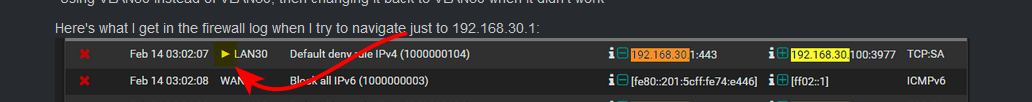

      Here's what I get in the firewall log when I try to navigate just to 192.168.30.1:

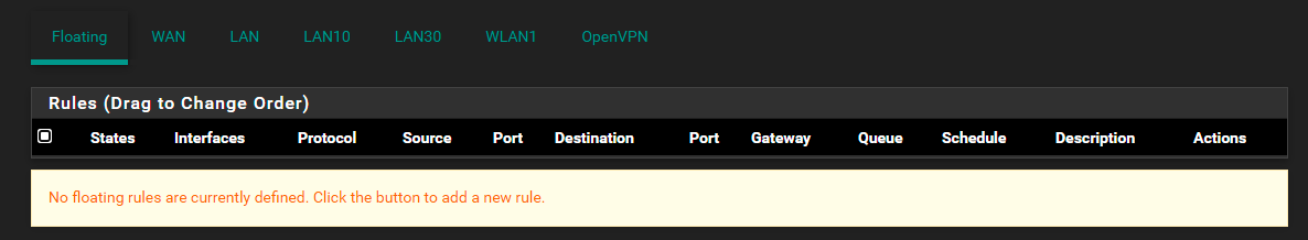

        @amorimpermissus can you post screenshots of your floating and vlan30 firewall rules?
          amorimpermissus @Griffo
          @griffo Hi thanks, I added the output of the pfctl -sr command for all the user rules above, but here are screenshots too:

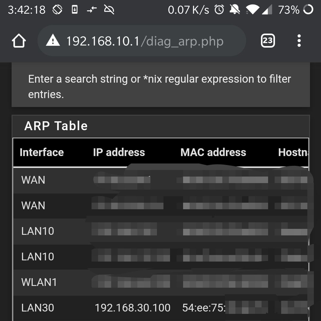

            What's the ARP table show for LAN30? Does it show the mac of the PC on .100 ?
            A 2 Replies Last reply Reply Quote 0
              @griffo Yeah I'll do the ping test in a bit. But it's definitely in arp

                  This is showing an outbound rule
                  That means the traffic was blocked on the outbound direction.
                  You can only place outbound rules in floating.

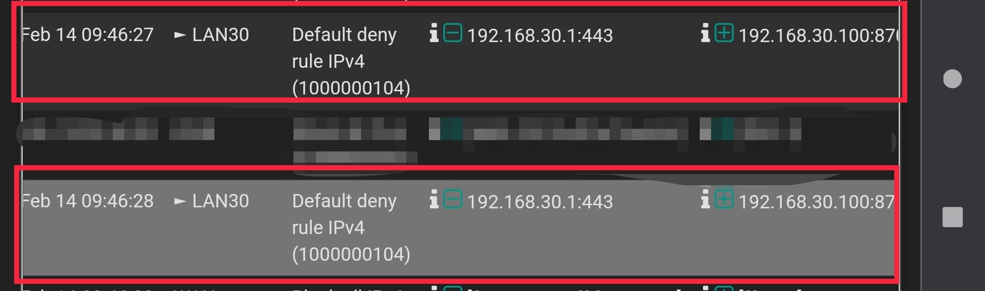

                    @johnpoz Hi and thanks so much for your response. I will add a floating rule and test, but I am also confused. As shown, I don't have any floating rules in existence. I created LAN30 (re1.30) the exact same way as LAN10 (re1.10). The only differences between the two are their VLAN and subnet. What did I misconfigure / forget that makes the LAN30 traffic behave differently than the LAN10 traffic (which has no problems getting to 192.168.10.1)?

                      I have no idea what you could of have done. I am just saying that the log is showing that is blocked on the outbound
                      And your traffic would be outbound as well that is your SA back to your client 30.100.. This would be outbound traffic from pfsense..

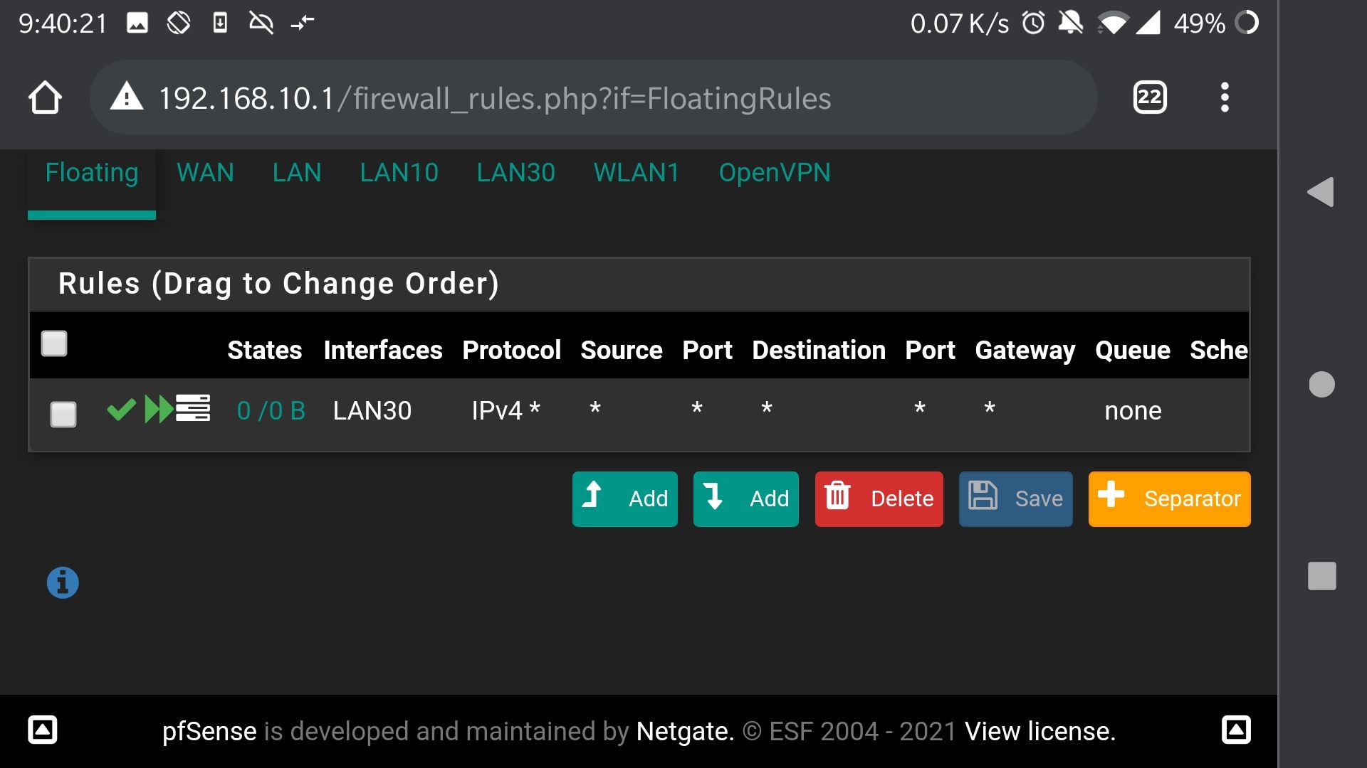

                        @johnpoz OK, just for the record, I created this floating rule:
                        I then waited for filters to reload and reset states. This is (still) the result when attempting to access 192.168.30.1 from 192.168.30.100:

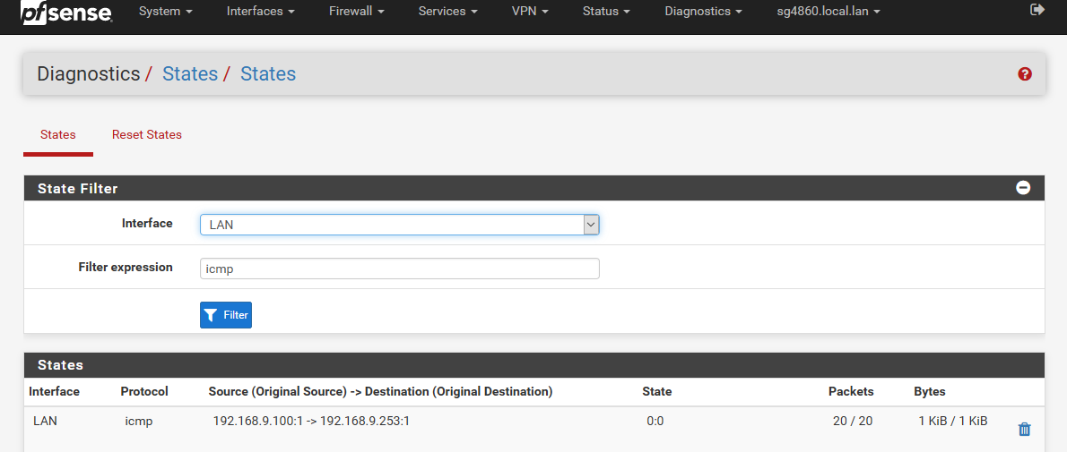

                                  yeah you will see a "state" created for icmp
                                  I started a constant ping to pfsense from my pc, then looking in the state table I see it.

                                  So you have IP set on the native interface your re1, and only have vlans 10 for your lan and 30 for your other vlan sitting on this physical interface.
                                  If traffic came into re1 without a tag, and source IP was 30.x then pfsense would try and answer via its vlan30 interface. But would be denied because no state on that interface - that is a GUESS to possible scenario that could maybe cause what your seeing..
