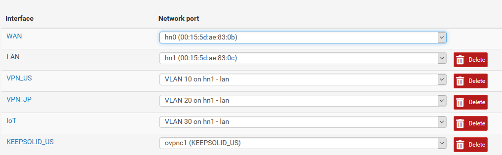

                          Interface setting

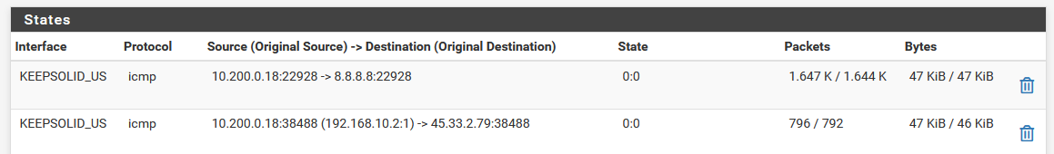

                              here is my states table (1st line is 8.8.8.8 monitor ip, second line is my ping running)
                              connection is solid so far, let me stop the other 2nd line ping in the background
                              thanks for the link , I did read that man page, so what do i do to keep ping alive or why does the monitor ip ping not keep alive?
                                If Google is blocking pings from your VPN IP, I would change the VPN monitor IP, choose one that replies back.
                                Change your VPN monitor IP as per my comment above.
                                I suppose that the ping 5 setting needs an openvpn interface in pfsense, to source that ping.. I see that you created one, lets see how it goes.

                                  Just to clarify , in my states image above it shows monitor ip icmp working, is that using my WAN interface to monitor the VPN? and hence it is not blocked
                                  not sure how to source a ping on the openvpn Interface and would you recommend that to run infinitely?
                                  i have tried a few monitor ip's 1.1.1.1 etc did not help keep connection alive

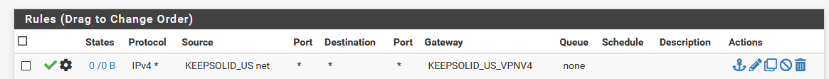

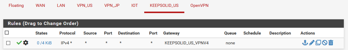

                                    do i need any firewall rules on my openvpn interface ?
                                    edit: did not make any difference adding any rules

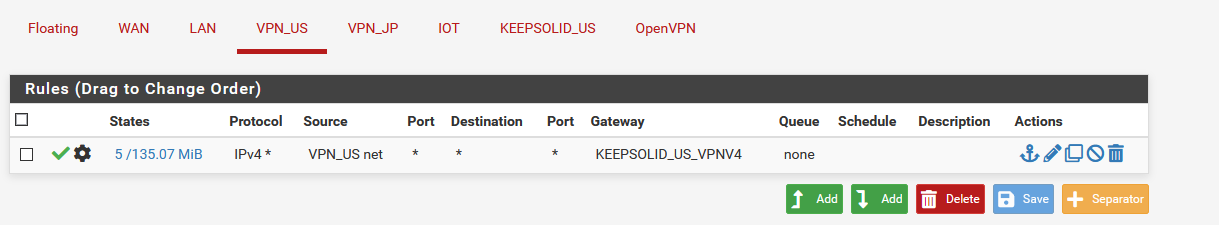

                                    I am using a vlans interface with gateway keepsolid_v4 and has allow all
                                    My computer is connected to the vlan and can surf the openvpn for that 10 mins

                                      @jonny-b74 Your image is showing interface KEEPSOLID_US as the source, so how you have replies from 8.8.8.8 and the ping you tried earlier didn't work?
                                      I would confirm if 8.8.8.8 is reachable through the VPN by pinging it directly, you can use a computer that is set to go out through the VPN, so you wouldn't need to choose any source interface in pfsense..
                                      Just make sure that the computer is indeed being routed through the VPN..
