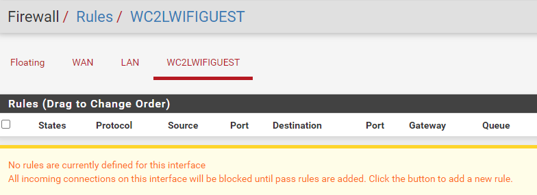

      Hi Folks,
      It is more than likely a lack of knowledge. I am trying to setup a bunch of NAT rules. The do not appear to be working. I don't think it is the same as the dual WAN issue.
      Single WAN port (DHCP from ISP)
      Two VLANS are configured
      LAN - 172.30.30.1/24 (Wired & Wireless) WiFiGuest - 172.30.32.1/24
      I have over 20 rules under Firewall - Rules
      So a simple rule is my Telnet rule
      Source *
      Port 23
      Destination 172.30.30.40
      Port 23
      Gateway *
      Queue nine
      Description Special-Telnet
      There may be some other settings that I have missed. Please tell me what I'm missing or how to fix it.. I'm very new to the Netgate/pfSense world.. I appreciate the help toubleshooting

            Are you trying to reach this server from WAN, or from WIFIGuest?
            If you are coming from WAN, you should use the port forward tab.
            If you are coming from another VLAN, you don't need NAT, just a firewall rule.

                From the WAN, just create a port forward, and this will generate a firewall rule automatically.
                From another VLAN, just create a firewall rule allowing VLANX to reach the LAN server port 23, no NAT or port forward required.
                The source port is random, so, source port should be any.
