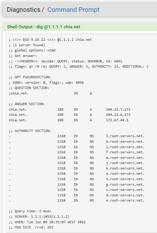

                                      Where is chia.net being filtered by 1.1.1.3??
                                      $ dig @1.1.1.1 chia.net +short
                                      104.22.7.173
                                      172.67.44.5
                                      104.22.6.173
                                      $ dig @1.1.1.3 chia.net +short
                                      104.22.7.173
                                      104.22.6.173
                                      172.67.44.5
                                      Now other stuff is filtered..
                                      $ dig @1.1.1.3 www.youporn.com +short
                                      0.0.0.0
                                      DaddyGoD 4 3 Replies Last reply Reply Quote 0
