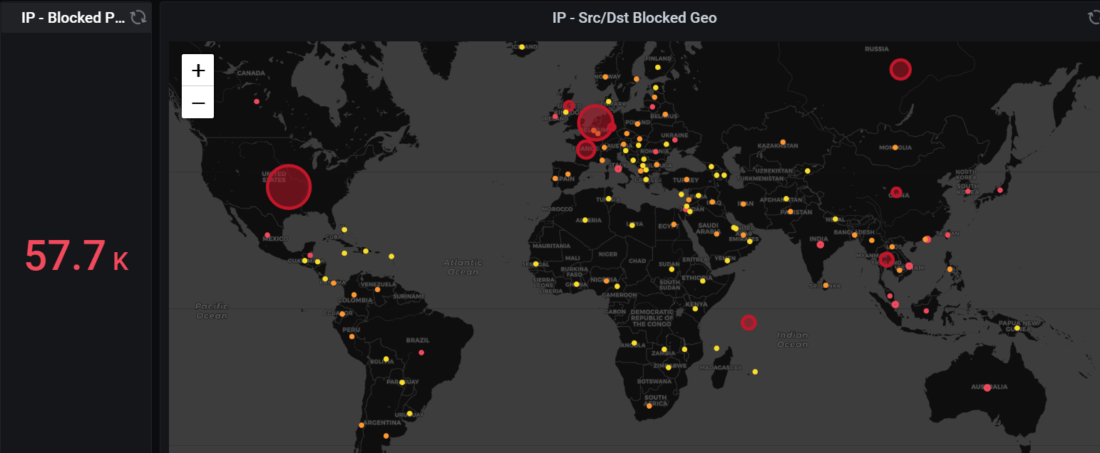

                              oren1031
                              but look like pfblocker is doing its job...

                                    johnpoz LAYER 8 Global Moderator @oren1031
                                    Why are you loading the NA list then? Just for your picture of where IPs are from?
