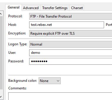

      Hi, from a server behind pfsense 2.4.5-p1 I can't access any ftp server that uses port 21 and ssl protocol such as:
      test.rebex.net
      user explicit ftp tls over tls if available
      access is only possible if I use SFTP to port 22
      The error message (in Filezilla) is:
      Response: 234 AUTH command ok. Expecting TLS Negotiation.
      Status: Initializing TLS...
      Error: GnuTLS error -110: The TLS connection was non-properly terminated.
      Status: Server did not properly shut down TLS connection
      Status: Connection attempt failed with "ECONNABORTED - Connection aborted".
      Error: Could not connect to server
      On the windows server I disabled the firewall and in pfsense I opened all ports from 1024 to 65535
      what else can i do?
      thank you.

          sasa1 @KOM
          @kom if I access sftp port 22 it works, my problem is that I can't access if I try to access as shown in the attached figure, I can't access port 21 in tls.
          Thanks.

                sasa1 @KOM
                @kom i need to connect using port 21 & ftp over tls, ftps and not sftp (sorry)
                thanks.

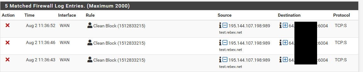

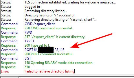

                    Just to be complete in this write up - I set mode to active.. And while I have my client set to send the correct public IP.. It won't work because the ftp active helper can not open the port on pfsense for the connection from the server to client in active mode. And I don't have the active ports forwarded by hand.. But as you can see that is not related to the control channel connection
                    in the port command you see 23,116 which is the port in this session of 6004 (23x256+116)
                    And you can see it blocked on pfsense.

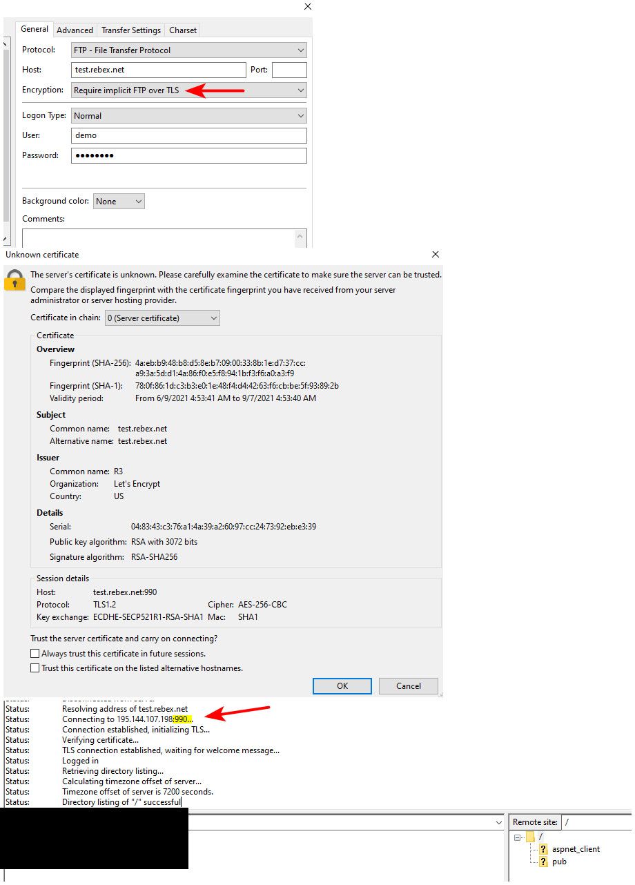

                      sasa1 @johnpoz
                      @johnpoz I confirm that in the modality:
                      require implicit FTP over TLS
                      I don't have problems.
                      My problem is only when I use the mode:
                      require explicit FTP over TLS

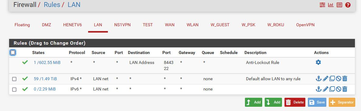

                      if I understand what you are saying, my problem is in the configuration of the LAN Rules, I am attaching an image.
                      Do I need to change this rules?
                      Thanks.
                        johnpoz LAYER 8 Global Moderator @sasa1
                        @sasa1 your lan rules are not the problem.. Those are the default any any rule - all traffic would be allowed. If you can not connect to the server for some reason a block upstream?

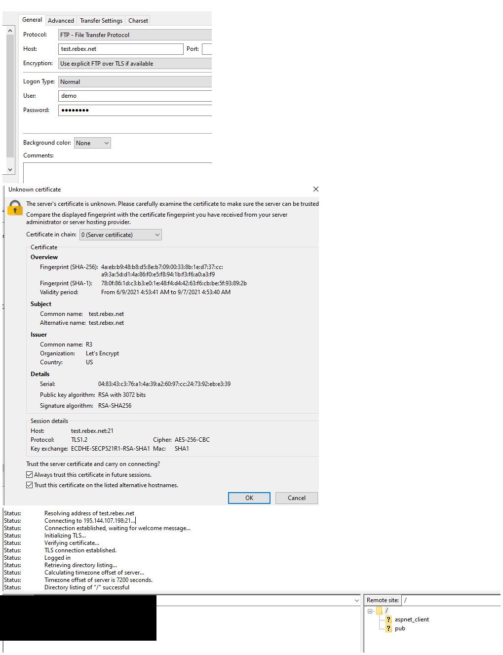

                        Works just fine.. Using passive for the data channel.. You can see above in the PASV command and then the server sends me the IP and port to connect too. Which via your outbound rules would be allowed without any problem.. With ftp there is a control channel connection and a data channel connection. if you can not connect control, then you never can get a data channel. If you connect with control, then be it using active or passive will determine who starts the conversation for the data connection..
                        What is the specific error your seeing in filezilla when you test.. Turn on detailed log view if you want to get a bit more info.. Your first posted error has to do with trying to use the sftp port while trying to do ftps..
                        ftps be it explicit would use port 21 for control channel.. Implicit uses port 990.

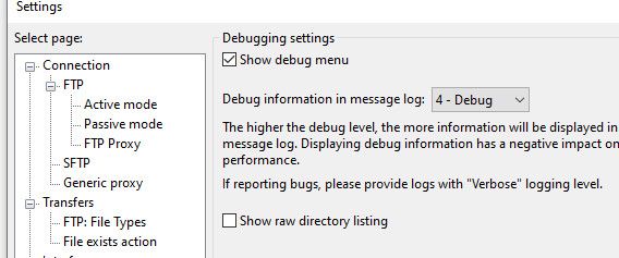

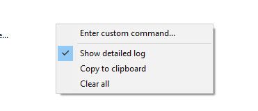

                                @sasa1 I would update, and then turn on detailed logging..
                                Right click in the log window area
                                You might want to turn on debug as well
                                Then your log will look like this
                                Status:	Resolving address of test.rebex.net
                                Status:	Connecting to 195.144.107.198:21...
                                Status:	Connection established, waiting for welcome message...
                                Trace:	CFtpControlSocket::OnReceive()
                                Response:	220 Microsoft FTP Service
                                Trace:	CFtpLogonOpData::ParseResponse() in state 1
                                Trace:	CControlSocket::SendNextCommand()
                                Trace:	CFtpLogonOpData::Send() in state 2
                                Command:	AUTH TLS
                                Trace:	CFtpLogonOpData::ParseResponse() in state 2
                                Trace:	tls_layer_impl::client_handshake()
                                Trace:	tls_layer_impl::continue_handshake()
                                Trace:	TLS handshake: About to send CLIENT HELLO
                                Trace:	TLS handshake: Sent CLIENT HELLO
                                Trace:	tls_layer_impl::on_send()
                                Trace:	tls_layer_impl::on_read()
                                Trace:	TLS handshake: Received SERVER HELLO
                                Trace:	TLS handshake: Processed SERVER HELLO
                                Trace:	TLS handshake: Received CERTIFICATE
                                Trace:	TLS handshake: Processed CERTIFICATE
                                Trace:	TLS handshake: Received CERTIFICATE STATUS
                                Trace:	TLS handshake: Processed CERTIFICATE STATUS
                                Trace:	TLS handshake: Received SERVER KEY EXCHANGE
                                Trace:	TLS handshake: Processed SERVER KEY EXCHANGE
                                Trace:	TLS handshake: Received SERVER HELLO DONE
                                Trace:	TLS handshake: Processed SERVER HELLO DONE
                                Trace:	TLS handshake: About to send CLIENT KEY EXCHANGE
                                Trace:	TLS handshake: Sent CLIENT KEY EXCHANGE
                                Trace:	TLS handshake: About to send FINISHED
                                Trace:	TLS handshake: Sent FINISHED
                                Trace:	TLS handshake: Received FINISHED
                                Trace:	TLS handshake: Processed FINISHED
                                Trace:	TLS Handshake successful
                                Trace:	Protocol: TLS1.2, Key exchange: ECDHE-SECP521R1-RSA-SHA1, Cipher: AES-256-CBC, MAC: SHA1
                                Trace:	tls_layer_impl::verify_certificate()
                                Status:	Verifying certificate...
                                Trace:	CFtpControlSocket::SetAsyncRequestReply
                                Status:	TLS connection established.
                                Response:	200 PBSZ command successful.
                                Trace:	CFtpLogonOpData::ParseResponse() in state 11
                                Trace:	CFtpLogonOpData::Send() in state 12
                                Command:	PROT P
                                Response:	200 PROT command successful.
                                Trace:	CFtpLogonOpData::ParseResponse() in state 12
                                Status:	Logged in
                                Trace:	Measured latency of 128 ms
                                Trace:	CFtpControlSocket::ResetOperation(0)
                                Trace:	CControlSocket::ResetOperation(0)
                                Trace:	CFtpLogonOpData::Reset(0) in state 15
                                Trace:	CFileZillaEnginePrivate::ResetOperation(0)
                                Trace:	CFtpListOpData::Send() in state 0
                                Status:	Retrieving directory listing...
                                Trace:	CFtpChangeDirOpData::Send() in state 0
                                Trace:	CFtpChangeDirOpData::Send() in state 1
                                Command:	PWD
                                Response:	257 "/" is current directory.
                                Trace:	CFtpChangeDirOpData::ParseResponse() in state 1
                                Trace:	CFtpChangeDirOpData::Reset(0) in state 1
                                Trace:	CFtpListOpData::SubcommandResult(0) in state 1
                                Trace:	CFtpListOpData::Send() in state 2
                                Trace:	CFtpRawTransferOpData::Send() in state 0
                                Trace:	CFtpRawTransferOpData::Send() in state 1
                                Command:	TYPE I
                                Response:	200 Type set to I.
                                Trace:	CFtpRawTransferOpData::ParseResponse() in state 1
                                Trace:	CFtpRawTransferOpData::Send() in state 2
                                Command:	PASV
                                Response:	227 Entering Passive Mode (195,144,107,198,4,9).
                                Trace:	CFtpRawTransferOpData::ParseResponse() in state 2
                                Trace:	CFtpRawTransferOpData::Send() in state 4
                                Trace:	Binding data connection source IP to control connection source IP 192.168.9.100
                                Trace:	Trying to resume existing TLS session.
                                Command:	LIST -a
                                Response:	150 Opening BINARY mode data connection.
                                Trace:	CFtpRawTransferOpData::ParseResponse() in state 4
                                Trace:	CFtpRawTransferOpData::Send() in state 5
                                Trace:	TLS Session resumed
                                Trace:	Protocol: TLS1.2, Key exchange: ECDHE-SECP521R1, Cipher: AES-256-CBC, MAC: SHA1
                                Trace:	CTransferSocket::OnConnect
                                Trace:	CTransferSocket::OnReceive(), m_transferMode=0
                                Trace:	CTransferSocket::TransferEnd(1)
                                Trace:	tls_layer_impl::shutdown()
                                Trace:	tls_layer_impl::continue_shutdown()
                                Trace:	CFtpControlSocket::TransferEnd()
                                Response:	226 Transfer complete.
                                Trace:	CFtpRawTransferOpData::ParseResponse() in state 7
                                Trace:	CFtpRawTransferOpData::Reset(0) in state 7
                                Trace:	CFtpListOpData::SubcommandResult(0) in state 3
                                Trace:	CFtpListOpData::Reset(0) in state 3
                                Status:	Directory listing of "/" successful
                                Which will show us more info about the TLS exchange..
                                You could also try clearing your cached certs? If your on windows that would be here "%APPDATA%\FileZilla"
                                There is a trustedcerts.xml file.
                                Once you have cleared the certs - you should see popup like I showed in my connections with details of the cert they are presenting you.
                                  sasa1 @johnpoz
                                  @johnpoz I deleted the trustedcerts.xml file, enabled verbose logging and debugging.
                                  I attach files with the errors received.
                                  Thanks.
                                  debug 4.txt

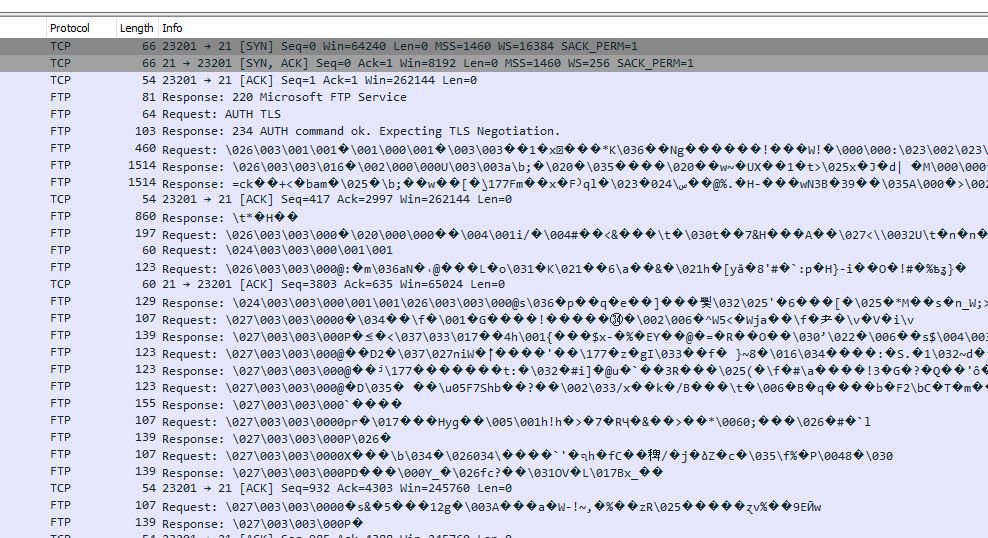

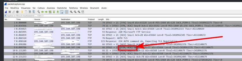

                                    @sasa1
                                    Looks like you never got the hello back..
                                    Traccia:	tls_layer_impl::client_handshake()
                                    Traccia:	tls_layer_impl::continue_handshake()
                                    Traccia:	TLS handshake: About to send CLIENT HELLO
                                    Traccia:	TLS handshake: Sent CLIENT HELLO
                                    Traccia:	tls_layer_impl::on_send()
                                    Traccia:	tls_layer_impl::on_read()
                                    Traccia:	tls_layer_impl::failure(-110)
                                    Maybe you could update your timeout? I believe it defaults to 60 seconds.. Maybe yours is lower, or you could say up it to 120 seconds? The way I read that is you never got the answer back from the client hello - server hello..

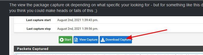

                                    For sanity shake you could sniff on pfsense wan when you try it.. You should be able to see what is sent and gotten back.. But yeah never going to get far if you never get the server hello back to work out the handshake..
                                    Are you doing any sort of vpn on pfsense, do you have multiple wan connections? Anything like that?
                                      sasa1 @johnpoz
                                      @johnpoz I took the timed-out to 120 seconds but to no avail.
                                      yes there is an active vpn with openswan.
                                      I disabled the vpn but unfortunately the result does not change
                                      Thanks.

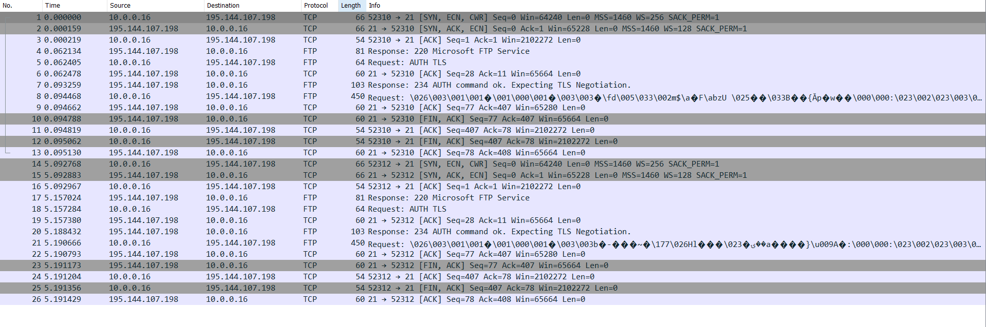

                                        Could you route your connection to this ftps server around that vpn..

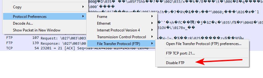

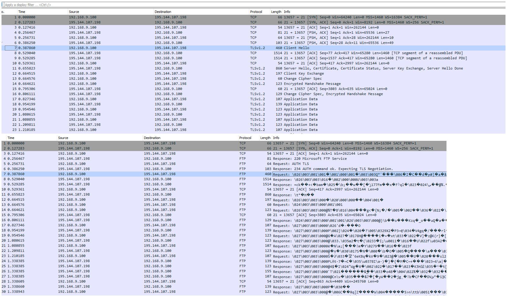

                                        If you capture your traffic and disable the ftp decode wireshark will do on it - you can then view the tls info.. So example here sniff via a connection... You can see my client hello and then the server hello..
                                          sasa1 @johnpoz
                                          @johnpoz I disabled the vpn connection and removed the rules related to the vpn but unfortunately the problem remains the same.
                                          Thanks.
                                            Well if they don't send you a server hello - then no you would not be able to connect.
                                            A sniff will show you what pfsense sees on its wan in return.. There would be no reason pfsense would not send this traffic to your client if it actually got it..
