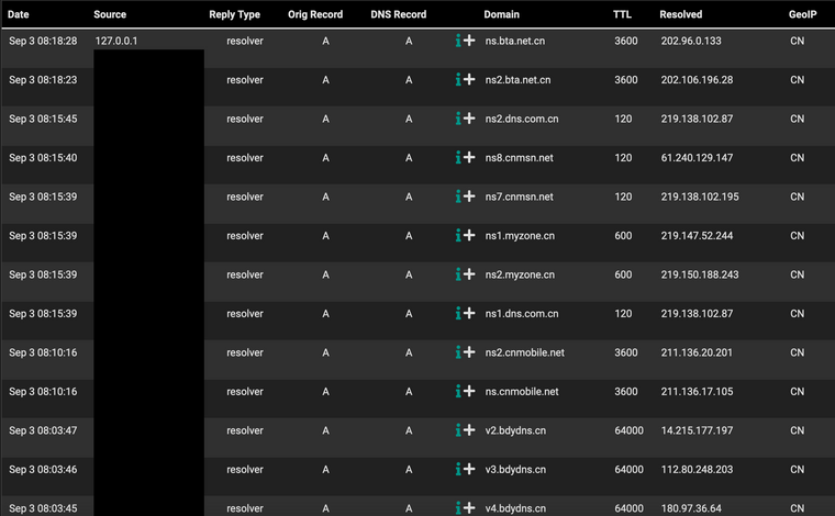

      code4food23
      I am unsure why this would be the case. If someone could shed some light on this, I would greatly appreciate it.
      KOMK 1 Reply Last reply Reply Quote 0
      • KOMK Offline
        KOM @code4food23
        @code4food23 Perhaps pfBlocker updating its tables. Any fqdn's used in an alias are resolved every 5 minutes or so.
          code4food23 @KOM
          @kom I see. So this is normal? I also see some to other countries, such as VN, AT, UK, etc, but its always coming from 127.0.0.1 (which is unbound, correct?).
          I was beginning to worry I had rogue devices.

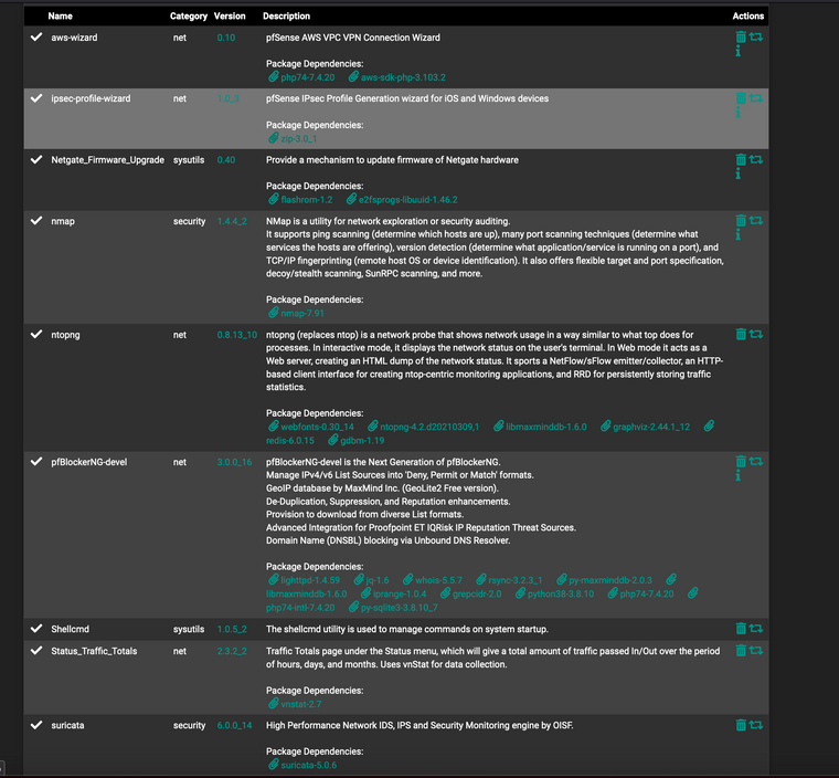

          • KOMK Offline
            KOM @code4food23
            @code4food23 Yes, that's Unbound. You have other packages like Snort or Suricata installed which may be doing the requests, or it might be pfB.
            bmeeksB 1 Reply Last reply Reply Quote 1

                code4food23 @bmeeks
                @bmeeks i see..so if not those, then why would unbound be reaching out to those foreign domains?

                    • bmeeksB Offline
                      bmeeks @code4food23
                      @code4food23 said in Can someone help me understand why is unbound resolving foreign domains (e.g. China)? Is this normal?:
                      @bmeeks I see. Now that is very worrisome. Throughout the day the only devices connected were my raspberry pi and a ring cam. I've only started checking the logs recently so hard to say. But I just filtered for CN and was surprised.
                      There are no unknown devices in my DHCP lease list nor on my Unifi conroller that is running on my Pi.
                      I do not have any ports either, has my network been compromised?
                      Can't say. Those are DNS name servers (the ns* values) for cnmobile.net, and the other lookup is some kind of cloud services provider based in China. This could simply be from some add on a web page opened by a client. It doesn't automatically mean you are compromised, or that there are rogue devices on your network.
                      You can use the packet capture capabilities of pfSense, along with additional unbound logging, to see what client on your LAN is responsible for the lookups.
                      C 2 Replies Last reply Reply Quote 1
                        code4food23 @bmeeks
                        @bmeeks Thank you so much for taking the time to respond. I am now noticing even more strange behavior and have no idea what to do exactly..
                        Except for the apple.com, all of the rest are from unbound.
