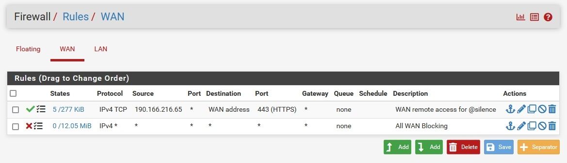

                        A Former User @Elmojo
                        @elmojo, If you want you can allow access only in pfsense (creating a rule in your wan like this for example) Firewall> rules> Wan> Permit 190.166.216.65
                        • E
                          Elmojo @A Former User
                          @silence What would that "permit"? Is that 190.166 address your public IP, or just an example?
                          I'm sorry, I don't follow what that rule would do. I'm game to try it if it gives you access to only the pfsense box, but I don't see how it would work. Sorry, it's Monday and I'm slow. Besides, I'm learning all this from scratch. Please be patient with me. ๐Ÿ™„
                            @elmojo, yes my WAN IP PUBLIC !
                            Only Acess Remote to you pfsense (website)
                            I would need you to create a user just to monitor your firewall logs.
                            • E
                              @silence Ok, cool. Let's give it a shot. One minute, let me set up the rule.
                                @elmojo, take a screenshot of the new username and password for me but don't send me the link.

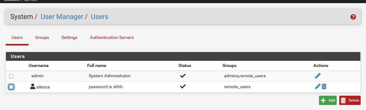

                                • E
                                  @silence sorry for the delay, was on the phone with my office.
                                  I have no idea if I did the user right. Let me know.
                                    @elmojo, Now Need View Firewall Logs

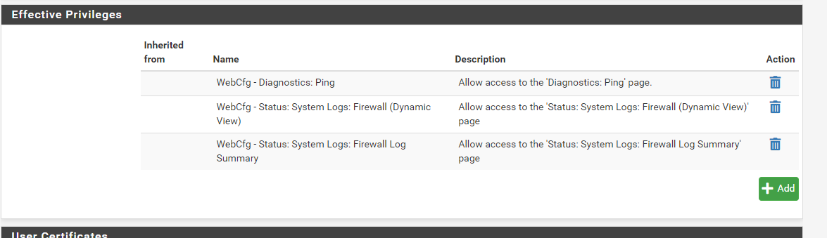

                                    • E

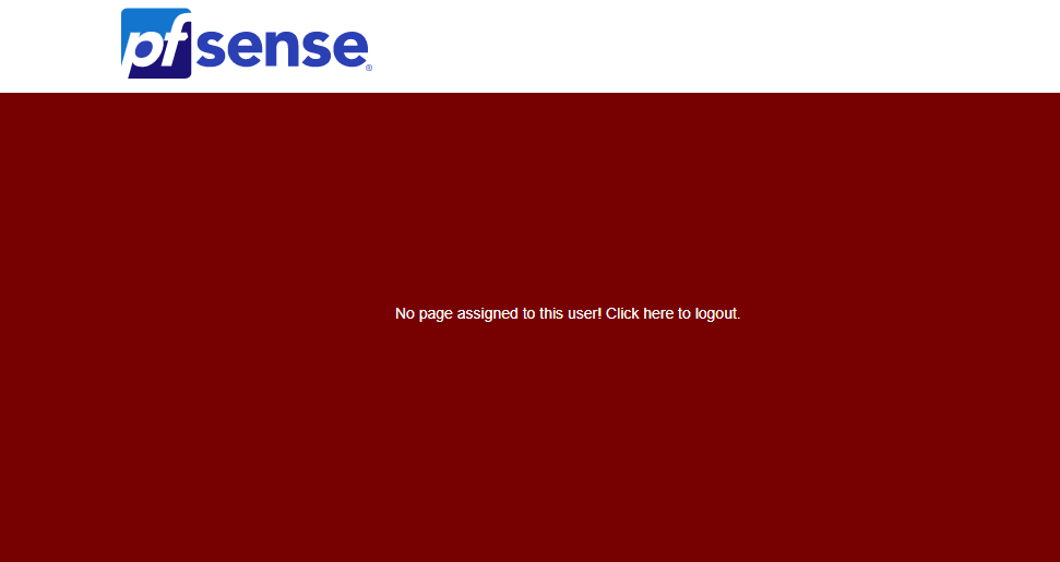

                                      How do I assigned you to the page?
                                      I don't see any options in the user management...
                                        • E
                                          @silence Done, try now.
