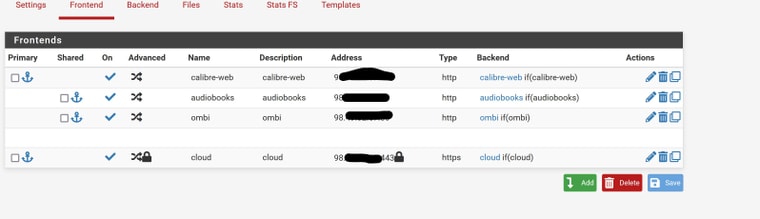

        You're looking for the HAproxy package (reverse proxy). You can install it from the package manager and configure it to do TLS offloading.
          menethoran @viragomann
          @viragomann unfortunately, no... HAProxy breaks something or something is broken while using HAProxy and TrueNAS Scale apps (ive been beating this thing with a sledge hammer for like 3 weeks now :) )

                  HAproxy only needs the SSL certificate which is matching to the hostname wich you type in the web browser is to handle TLS.
                  Do you have a proper cert?
                    @viragomann yes, through ACME, set for the full domain name (cloud.mydomain.org) and also carried into the app (kubernetes pod) itself.

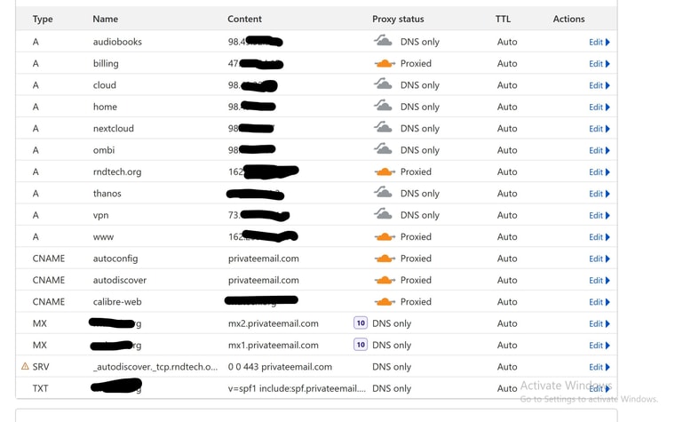

                          @viragomann my mistake, i think i was seeing a latent error message (just hanging around from chrome) on my phone. trying to connect via firefox gives a 521 error (if my cloudflare SSL/TLS is set to flexible) and just seems to hang, eventually timing out, but not before it looks like it resolves the address to reflect my internal address ie: i connect to https://cloud.mydomain.com, long delay, address changes to https://192.168.2.2:9443/login and then times out) (if i have the SSL/TLS settings in cloudflare set to FULL)
                          so, it LOOKS like the traffic is being routed to where its supposed to go, but not sure why its translating the address to the internal one

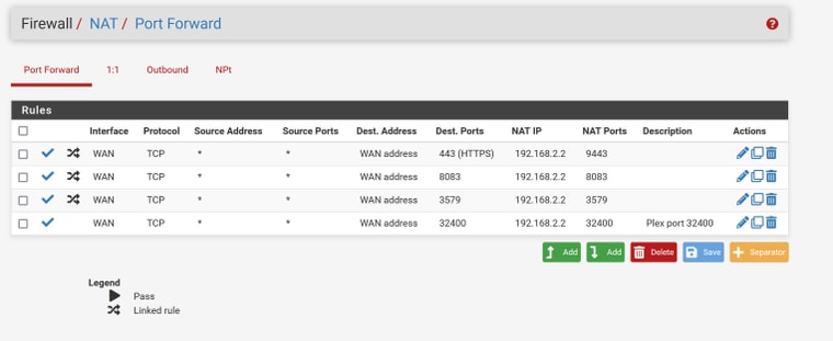

                            And this works from inside your network?
                            Why port 9443?
                            Did you consider to change the port for pfSense WebGUI to something else than 443?
                            M 2 Replies Last reply Reply Quote 0
                              @viragomann no, i cant connect to 192.168.2.2:9443 from outside my network. Sorry, i think i phrased something wrong.
                              If i try to connect to https://cloud.mydomain.com the address bar will convert that to https://192.168.2.2:9443/login when it times out (like its hitting HAProxy or my NAT settings and translating it correctly but now actually hitting the pod on the NAS.
                              and its set to 9443 becausevfor some stupid reason, ports lower than 9000 cant be assigned when creating the pods (that may be changed at a later date, but i assume its to keep people from using ports that the NAS does, who knows what happens in the minds of devs)
                                @viragomann and yes, my PfSense web interface is on 8443.

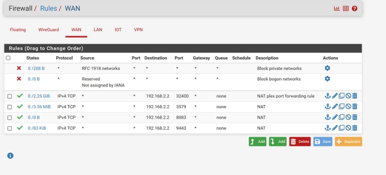

                                  So you connect to port 443 from the internet and forward it to port 9443 on your web server?
                                    menethoran @menethoran
                                    @menethoran i should also say, ive tried using traefik (as a pod) but, honestly, im completely lost with the way it integrates (because it was "designed" as a pod for truenas by truecharts, they do all the backend stuff and there are no ways that ive found to change anything in traefik by its GUI, and there is no access to the backend (cli), so, ive kind of disregarded it as a usable piece of software. at least for now. So, im trying to get PfSense/HAProxy to work correctly with the NAS and its pods
                                      @viragomann yes, i can connect perfectly fine to https://192.168.2.2:9443 from inside my network. I can even connect to https://cloud.mydomain.com from inside my own network and it translates to https://192.168.2.2:9443 perfectly fine and everything works.
                                      And yes, my PfSense is set up to forward connections coming in as https straight to 192.168.2.2:9443... but only works from inside my network.

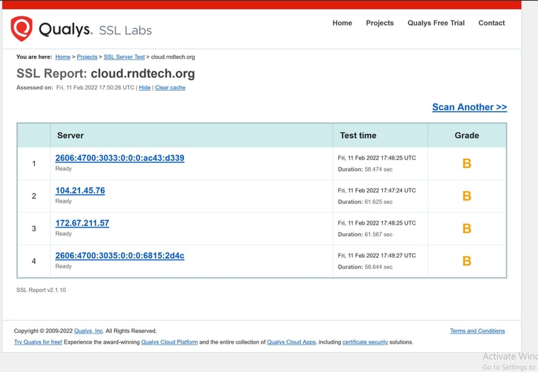

                                        Consider to check your SSL settings with an online checker, e.g. https://www.ssllabs.com/ssltest, to get an idea what's wrong with it.

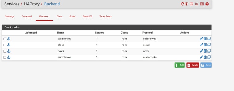

                                          @viragomann not entirely sure what the test tells me...
                                          • V Offline
                                            viragomann @menethoran
                                            @menethoran
                                            This is a test history for cloud.rndtech.org. So this host name was already tested on SSL Labs.
                                            Is this your own domain? Or do you have a subdomain within this?
