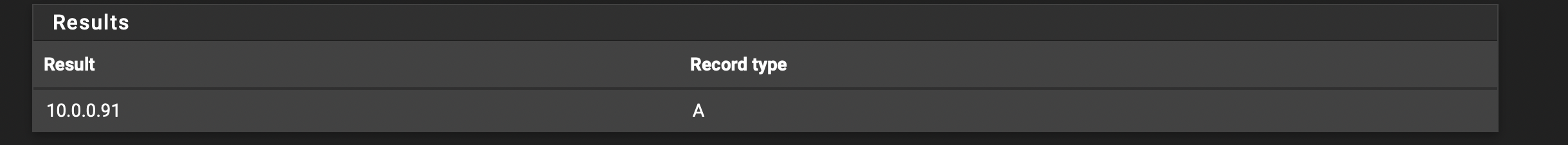

                                          • W Offline
                                            wrobelda @viragomann
                                            @viragomann said in Routing Virtual IP traffic through VPN gateway:
                                            @kultigsptrizigfrisch
                                            Dude! Simply do what I suggested above to get where the hostname is directed to:
                                            So go to Diagnostics > DNS Lookup and resolve your hostname and you will know where the packets are directed to.
                                            Dude, I am literally telling you that DNS lookups work as intended, i.e. taking an exemplary domain I want to evade the geoblocking for, I see it resolves to sniproxy's Virtual IP, as I already explained, quote:
                                            " I know that my selected DNS domain queries are directed to SNIProxy by dnsmasq, as I intend "
                                            I see the traffic intended for those domains in sniproxy logs, and the websites work just fine, except I can't get it to route through the VPN's gateway and it instead uses the default one.
