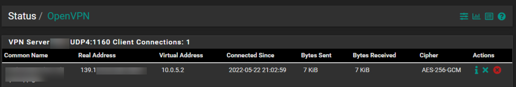

                                  Server side:
                                  Firewall Rules OpenVPN
                                  NAT Outbound
                                  OpenVPN Server Configuration
                                  OpenVPN Server Client Specific Overrides

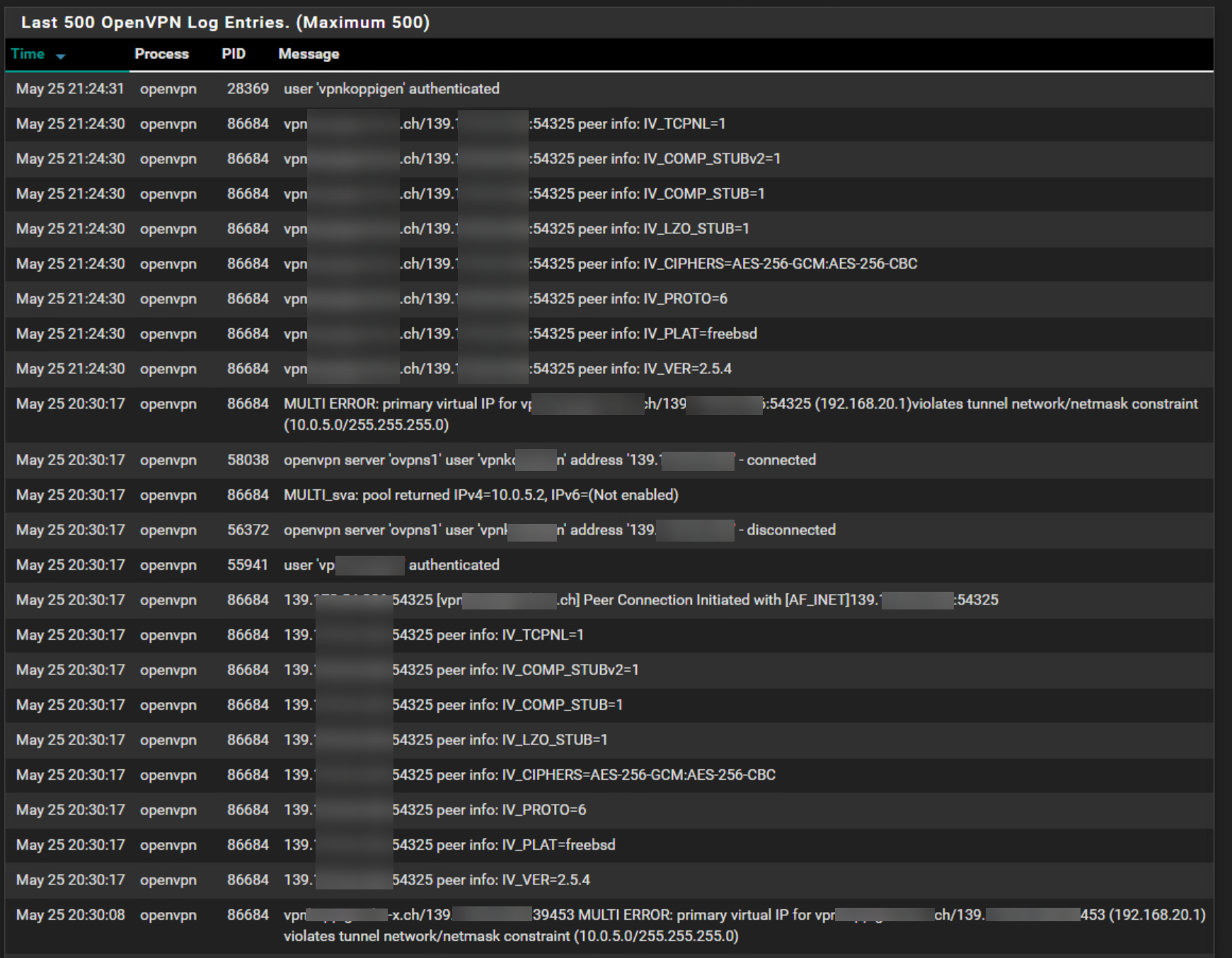

                                  Server-Side Log:
                                  OpenVPN Log
                                  OpenVPN Status:
                                  Answers for your questions:

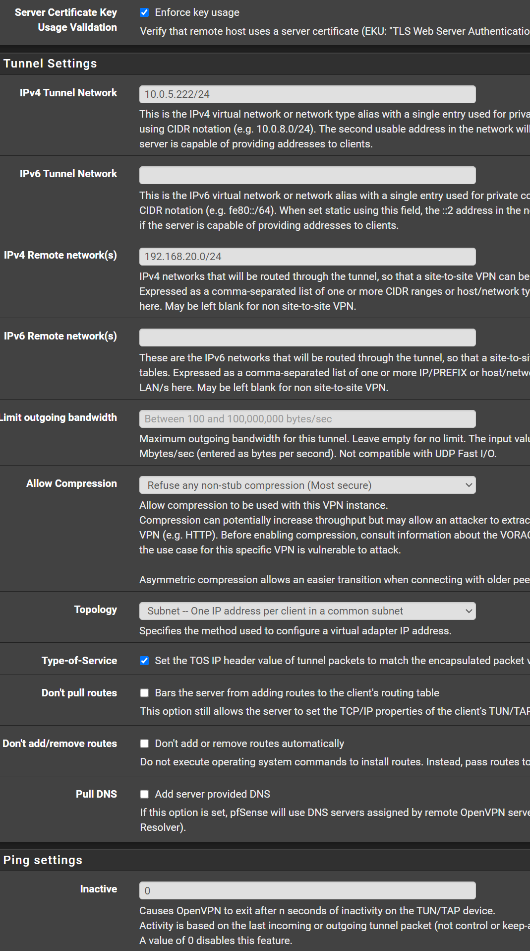

                                      This is the follow up and client side configuration. The client side is also a Pfsense, so the connection will be from Pfsense to Pfsense.
                                      Client Side
                                      Firewall Rules OpenVpn
                                      NAT Outbound:

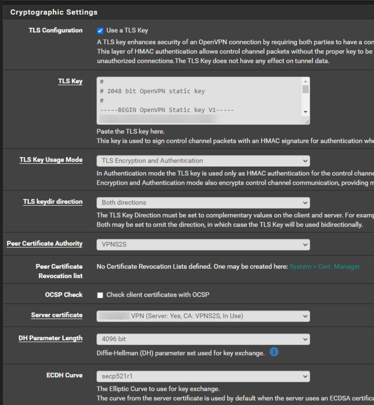

                                      OpenVPN Configuration:

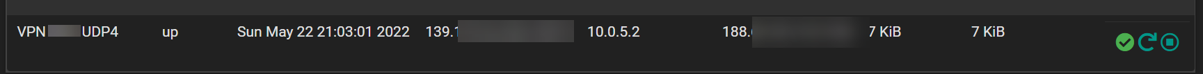

                                      Client Log OpenVPN:
                                      Any help is welcome.

                                        @hispeed Get rid of the client specific override.
                                        The tunnel networks have to be the same. Copy the subnet from the server to the client. 10.0.5.0/24
                                        • V
                                          viragomann @hispeed
                                          @hispeed
                                          You're messing up the settings, again and again.
                                          Configure the CSO as I suggested above, please. The tunnel network is wrong again.
                                          In the client settings you must not state a tunnel IP. You can leave it blank or enter the tunnel network equal to the server settings.
                                          And the Remote Network is wrong! This is your local network. In the Remote Networks box enter the server sides network!
