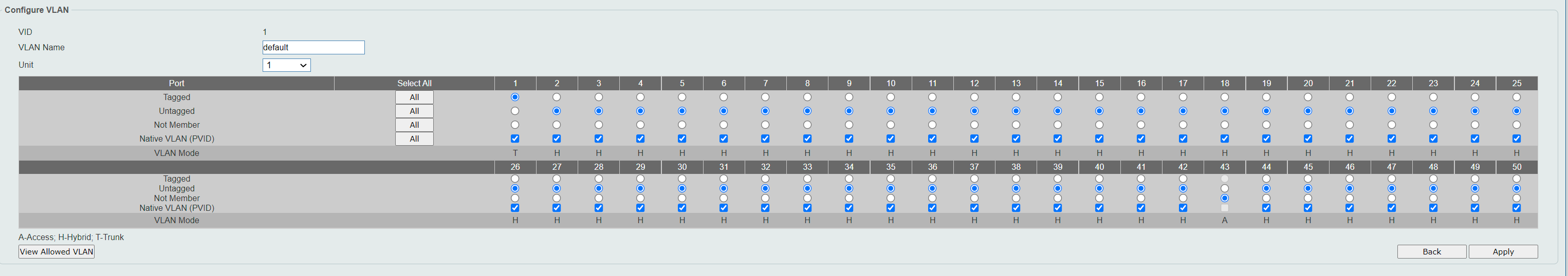

It is so confusing, since I can edit the port individually (like when I can choose Access port on port 43 and tons of details.. this is also where I set the port 1 to now Hybrid) and then I can edit it in this multi-port view.

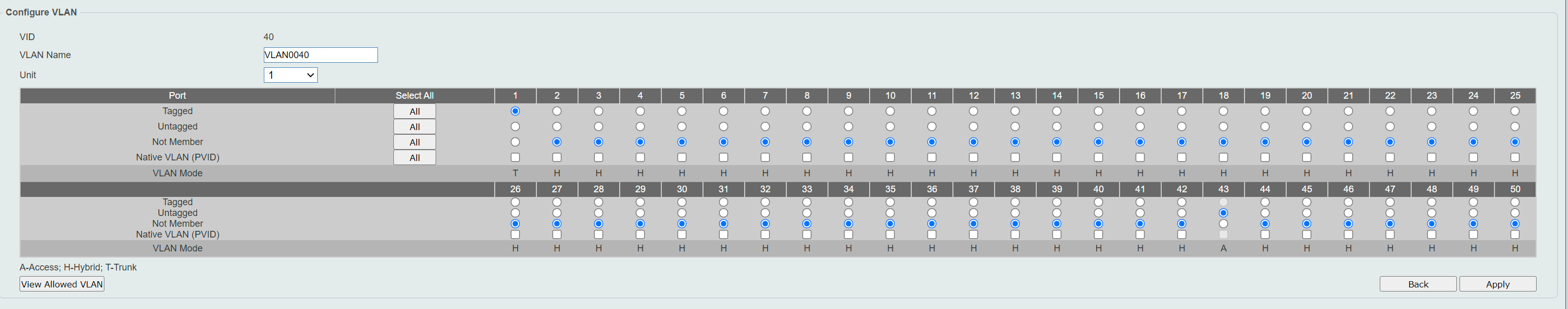

As you can see, when I edit the 40 VLAN group as a hole like in the screenshot here, I can't set port 40 tagged (radio is greyed out/disabled) and when I try to set port 1 to Untagged, it just ignores this after pushing Submit and in the summary button shows "Untagged port 1,40" instead of "Tagged port 1".
Edit: Ops, I see that you say "Untag port 1", so it is correct here :) So ignore that part, port 1 is Untagged as it should.

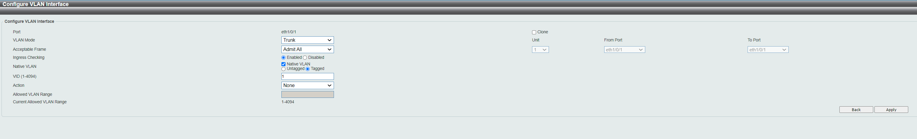

Ok, so this is VLAN-interface - I assume you want me to edit Port nb 1 entry there. Like this:
Step1:
Step 2:
Isn't vlan 40 already tagged here? Or is it wrong?
It says "Current Hybrid Untagged VLAN Range 1" and "Current Hybrid Tagged VLAN Range 40".
@jarhead In there, under Hybrid mode in the faq, they have stated "tagged" for all the VLANS. So you mean I should enter 1-4096 (or 1-40) as "tagged" range instead of the things I have from my screenshot above?

This doesn't make sense to be neither ;) Because I have found out that the "tagged" and "add" box is not for the VLAN-textbox (VID 1-4094) above (that only accepts one single VLAN). It seems to be there for the "Current Hybrid tagged VLAN" and the "Current Hybrid untagged VLAN" -box, like marked red in my screenshot.
When I change the value in the text-box and choose Add or Remove, it adds this entry to Current Hybrid tagge VLAN (when I choose tagged). See my picture for illustration of this. This also makes sense in my head: This way. If I do as you say, I can't add a new VLAN50 later, since that textbox with VLAN-ID with value 40 only supports one VLAN. If I set it to 40, it will block out traffic to every port except the VLAN40. But I want to keep the switch talking 1-2, 1-3, 1-4 etc on VLAN1 and 1-43 on VLAN4.

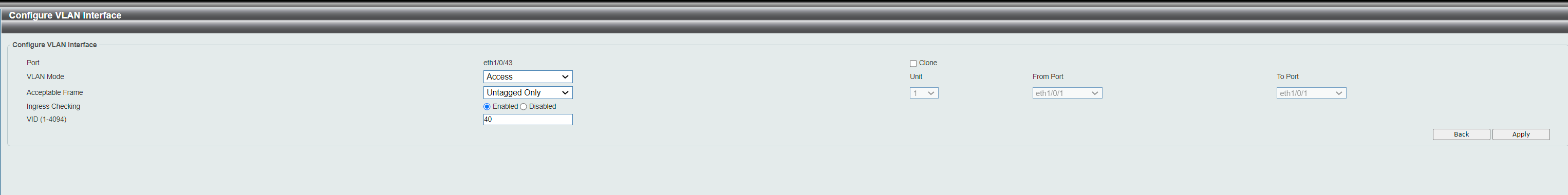

How it looks after I submitted the box. It list Port 1 to have the default VLAN 40 for non-tagged/non-assigned traffic. Doesn't look correct to me.

In the dropdown menu, I have "Add, Remove, Tagged, Untagged". It is under the VID-box. This is the Port 1 interface.
When I did as you said, just entered 40 in the VID-box, choose "Add" and choosed "Apply", the Current Hybrid untaggd/tagged VLAN-range list became empty (because the text-box with Allowed VLAN Range was empty and it is my understanding that the dropdown is only for the selected port values under it - so when I had no values in it, it deleted the values displayed at the bottom).
The VID DO change for Port 1, as I shown in previous listing/summary. But I assume that box is only for having a default VLAN in case no traffic is tagged arriving on that port. That makes sense, I would think it was smarter to have it to 1. Since it is port 1 that is a trunk port for many VLANs, not only one. If I enter 43, Port 1 can only communicate with port 43 on VLAN40 (If my understanding is correct).

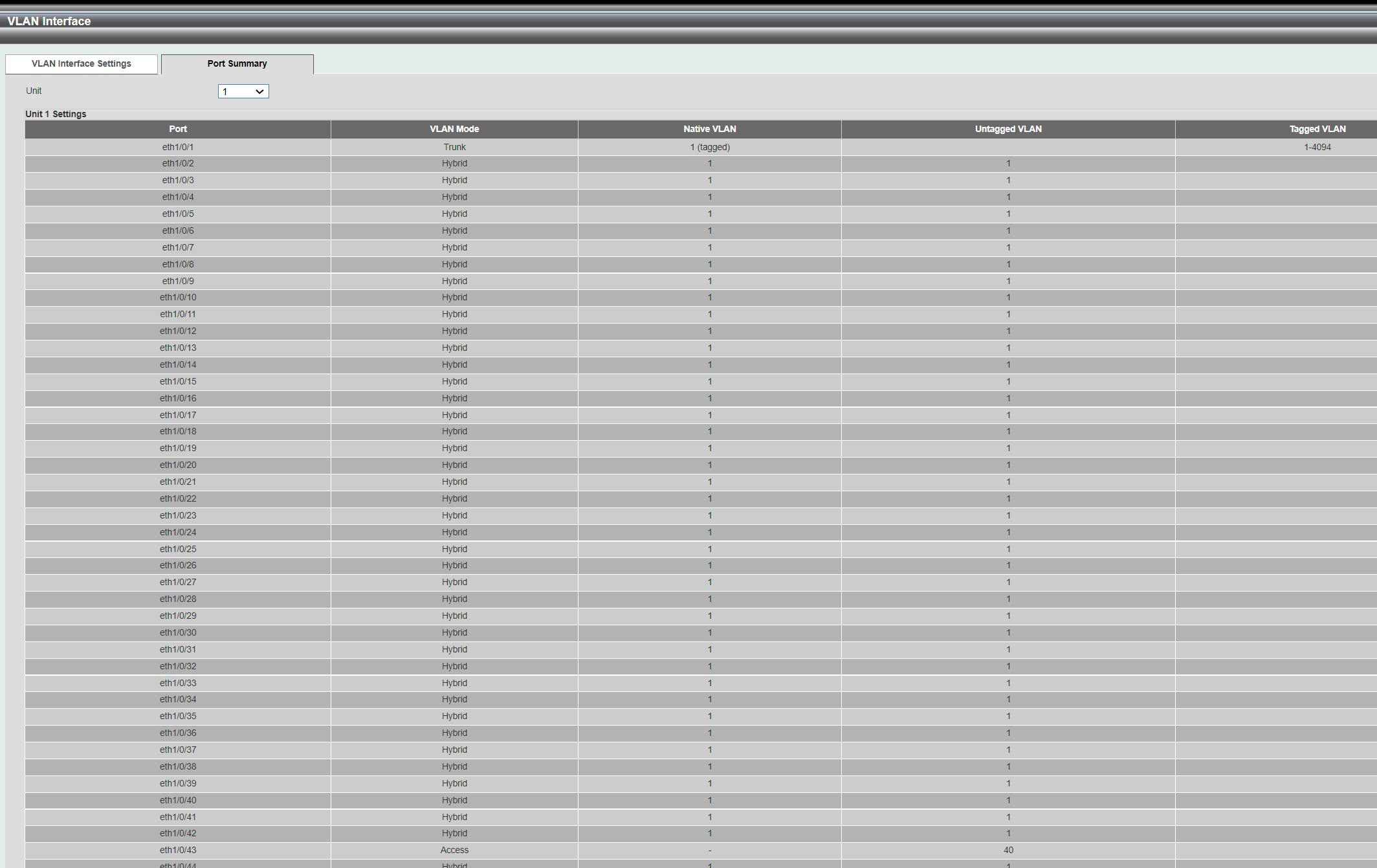

And here you see another indication that I'm actually adjusting port numbers. After doing what I showed above, the vlan summary looks like this (notice the heading of the columns and you will find the value 1 and 40 again):
