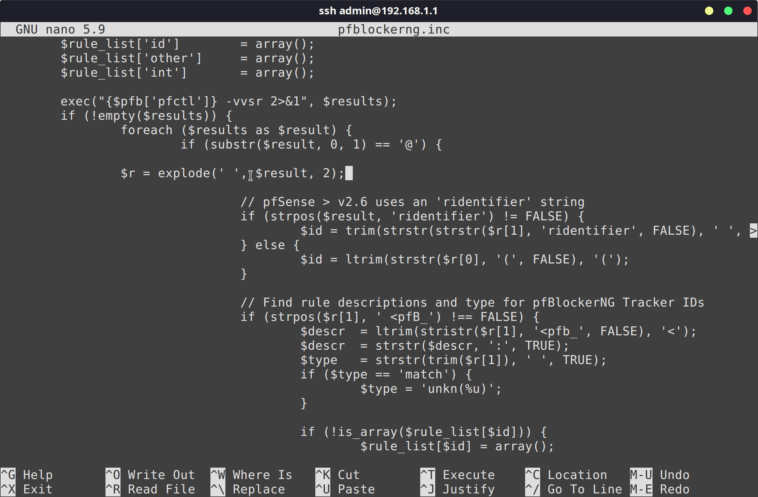

                        I used System Patches package to apply the patch. The code i pasted looks like this:
                        diff --git a/net/usr/local/pkg/pfblockerng/pfblockerng.inc b/net/usr/local/pkg/pfblockerng/pfblockerng.inc
                        index 7fa8c1d2f8bf..2abbef30578b 100644
                        --- a/net/usr/local/pkg/pfblockerng/pfblockerng.inc
                        +++ b/net/usr/local/pkg/pfblockerng/pfblockerng.inc
                        @@ -4136,7 +4136,7 @@ function pfb_filterrules() {
                                 foreach ($results as $result) {
                                     if (substr($result, 0, 1) == '@') {
                        -                $r = explode(')', $result, 2);
                        +                $r = explode(' ', $result, 2);
                                         // pfSense > v2.6 uses an 'ridentifier' string
                                         if (strpos($result, 'ridentifier') != FALSE) {
                          johnpoz LAYER 8 Global Moderator @nimrod
                          @nimrod I would directly look at the file and make sure it actually applied, if your not seeing any difference in your cpu usage after applying..
                          you can find the inc file in this dir

                            @johnpoz said in Strange issue with CPU usage.:
                            It seems ok. I also see pfblockerng.inc.orig file, which i think is the backup created by system patches package.
                            This file is 300 megs, and it has 10000 lines of code in it. I guess, the file size depends on how many feeds/lists i have loaded.
