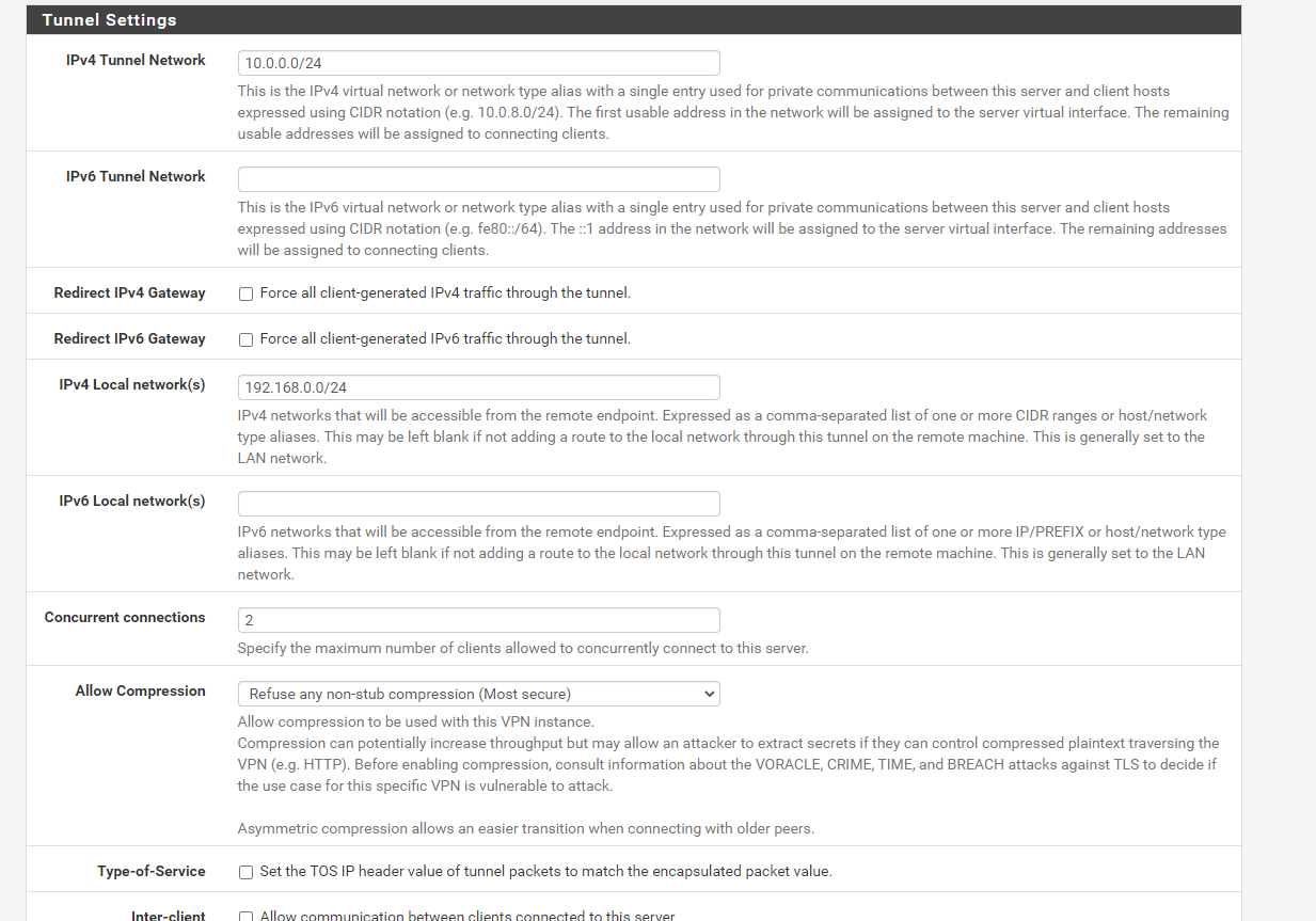

            I did change the IPV4 Tunnel Network from 192.1xx.x.xx to 10.0.0.0/24
            and i redownloaded the config file (because i would assume you would need a new confige file if you are making these types of changes).

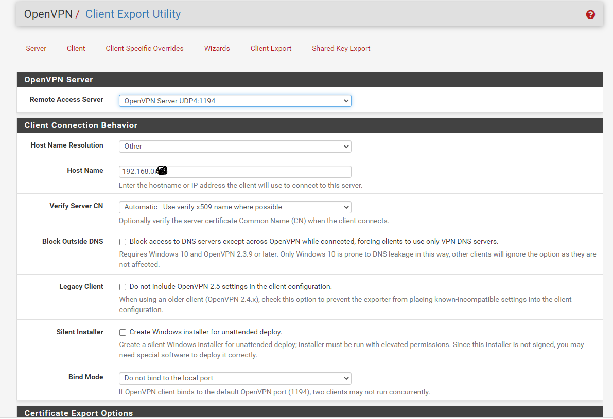

            Here is a pic of the client export utility.
            Here is a pic of the tunnel settings. As mentioned above the change i made is reflected in the pic below. From what I recall the IPv4 is supposed to be your local network. That is what i think mine would fall under as everything is on a 192.168.0.x ip.

                @travelmore The hostname in the client config needs to be your WAN address.
                Your local address would be 192.168.0.0/24, not 192.168.0.100/24.
                Google rfc1918. Those addresses never need to be redacted.
                T 1 Reply Last reply

                          @travelmore Did you change the hostname in the client export?
                          Reply Quote 0
                          • V
                            viragomann @TravelMore
                            @travelmore said in OpenVPN on PFSense:
                            I am assuming I need to do a new config file to my phone when I make these setting changes, right?
                            Yes, the client has to connect to the public address if from outside.
                            You have to state this into the "Host Name" box in the client export utility.
                            You can as well edit the clients config if possible and replace the IP in the remote line.
                            However, is your pfSense WAN IP a public one? Or is there a router in front of it?
                            Is your public IP static?
                            Is pfSense the default gateway in your network?
                            Reply Quote 0
                            • T
                              TravelMore @Jarhead
                              @jarhead No i did not that is set to other

                                @viragomann The host name box in client export utility is set to other (post above i believe shows this info and pic).
                                As far as editing the config file, the IP that is in the remote line is the IP for my pihole.

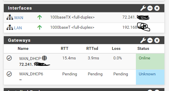

                                My WAN IP on my pf sense is a 72.x.x.x IP. I do not know if this IP actually ever changes. I just know its always a 72.x IP.
                                My LAN is a 192.x.x.x it is a static ip.
                                I did check and see the OpenVPN service is running now which is an improvement from previously.
                                  So you should have your server set to listen on this WAN IP.
                                  Then in the Client export utility set the "Host Name Resolution" to "interface address". So it put the public IP automatically into the remote line.
                                  However, you have to make the change on the client. So either you can edit the config there or export a new config from pfSense and import it on the client.

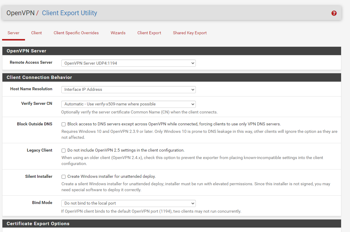

                                        @travelmore In the Client export, change Host Name Resolution to Interface IP address, then export a new client config and use it on your client.

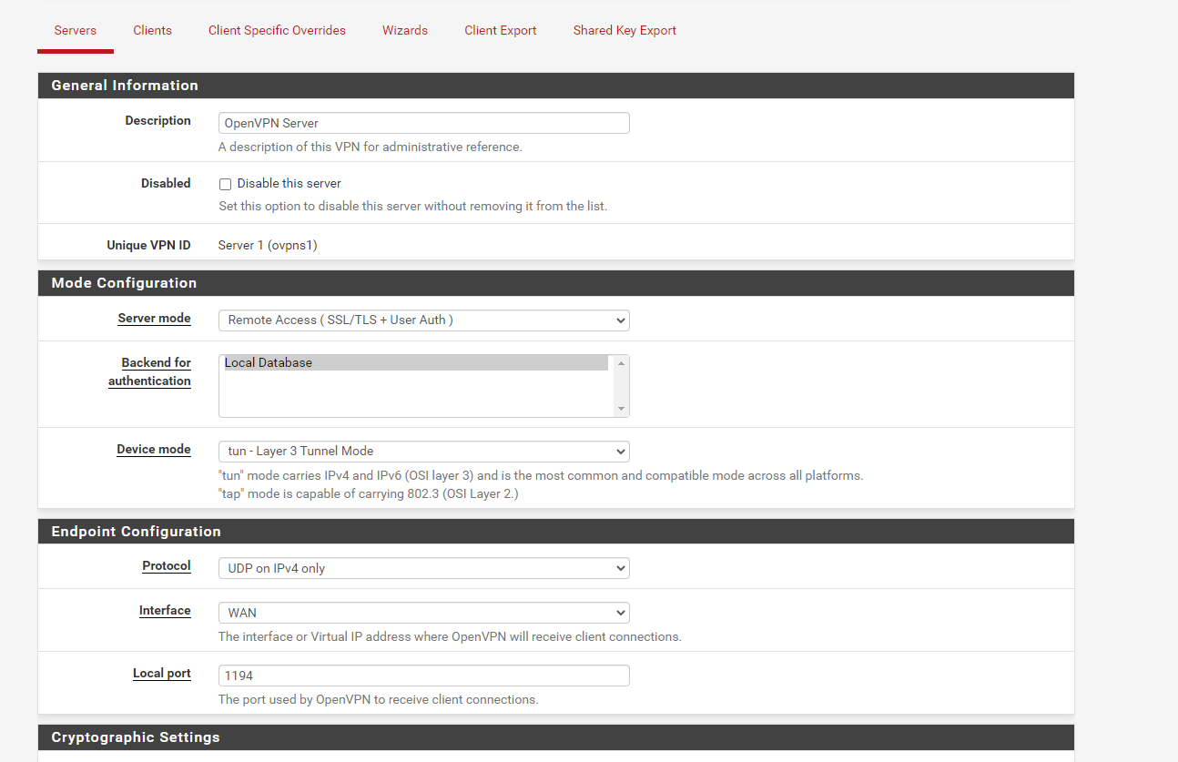

                                          @viragomann This is what is already set in Server setting. I didn't make any change to it just looked and saw that was set.
                                          These are the tunnel settings ips currently, I believe these are correct. Please verify.

                                          I have just now done as @Jarhead stated and changing the hostname res. to interface IP address (below) and exporting a new client config.
                                          I will let you guys know if i can connect.
