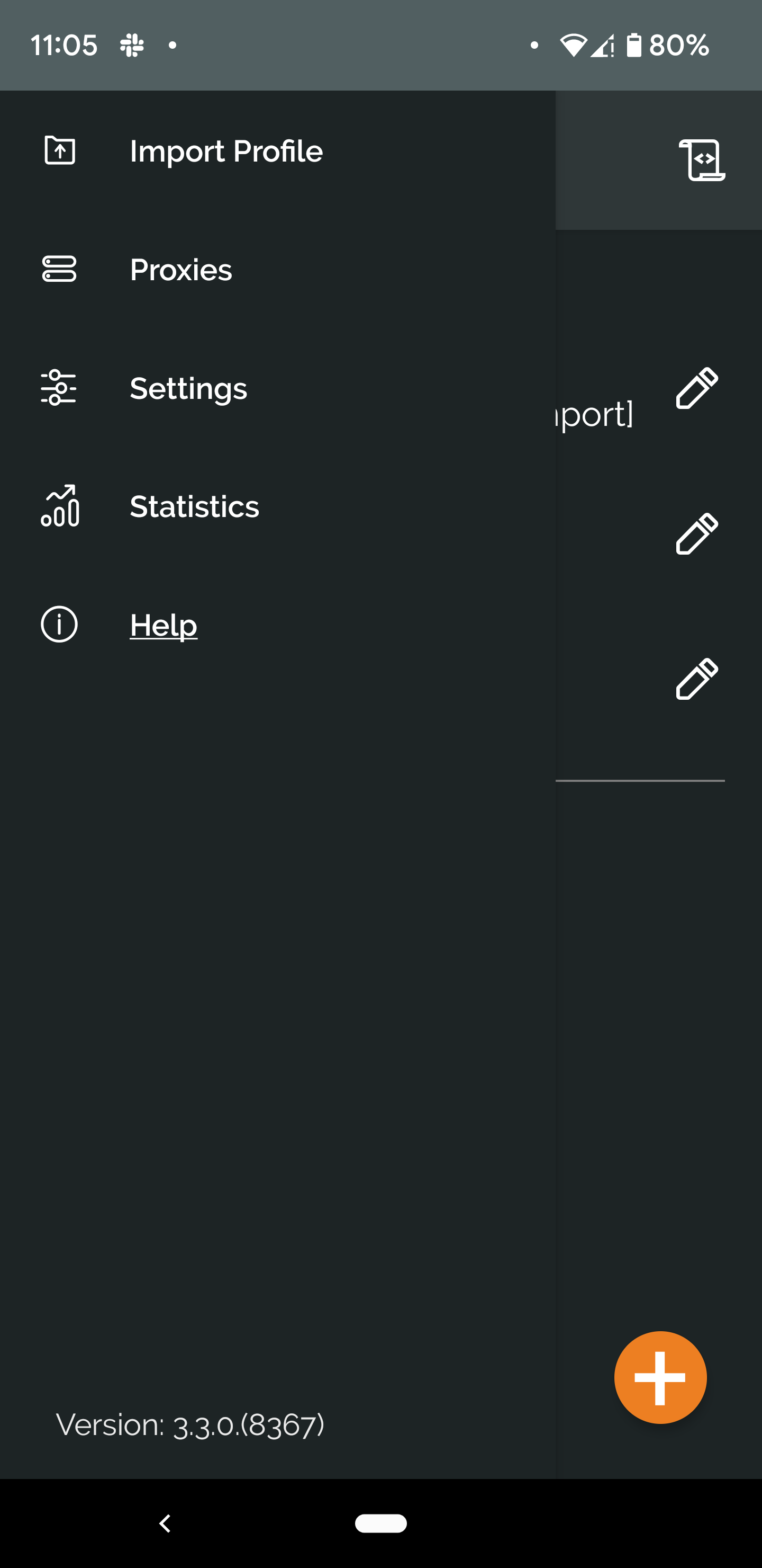

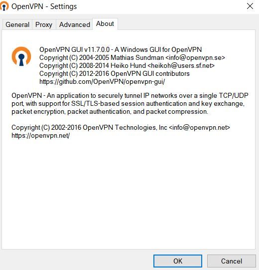

                          On the versions, the android/windows versions are just what I see in the "about". So, maybe that is the GUI version, but I don't see the underlying "version" of OpenVPN in either situation.
                          See attached.
                          and
                          • V Offline
                            viragomann @davidstoll
                            @davidstoll

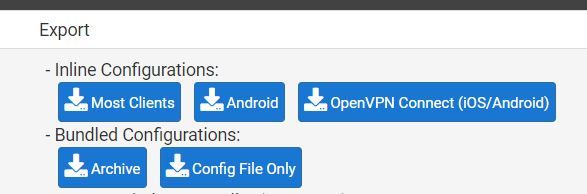

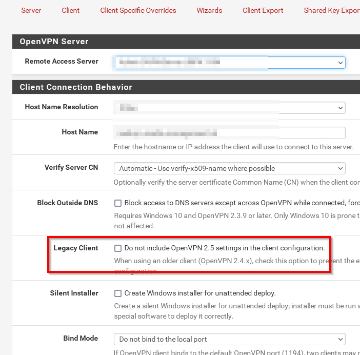

                                    Since you're running an 2.4.x client, check "Legacy Client" in the client export utility and export a new config file.
                                      davidstoll @viragomann

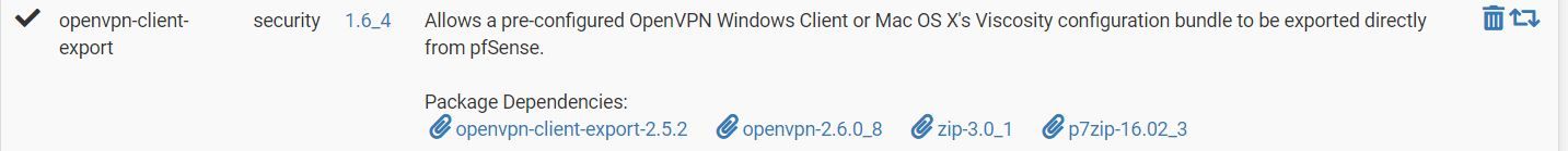

                                      @viragomann I don't have any options. I can only click on the OS that I am trying to export for. Is there a better export plugin maybe? I'm using "Openvpn-client-export v1.6_4, which seems to be the latest as far as I can tell.
                                      • V Offline
                                        @davidstoll
                                        Try this one:
