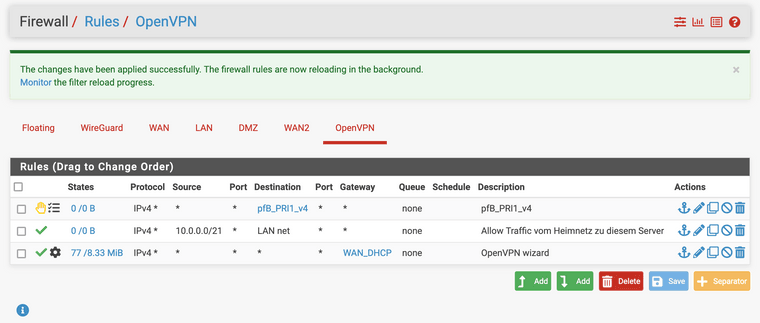

          @viragomann Thats the point, it can resolve it. But there is no connection for some reason. And I don't habe any blocking ACLs :(

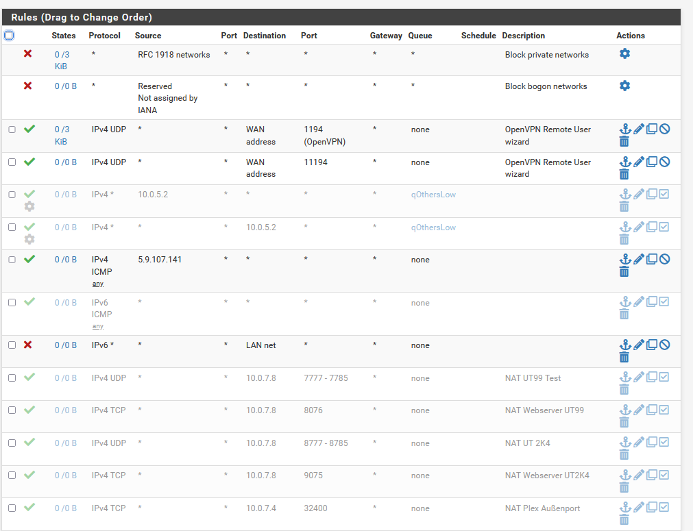

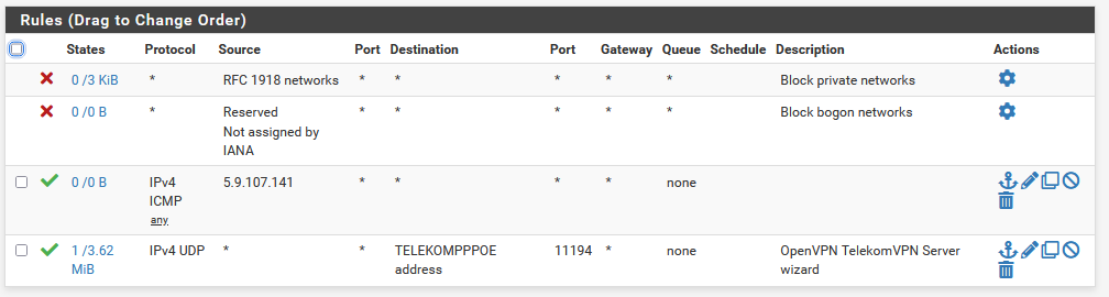

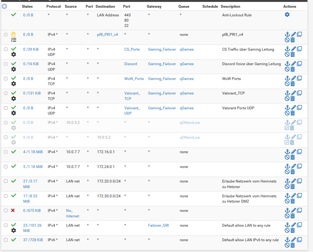

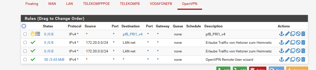

          As you can see, there are my Rules, WAN2, WAN, OpenVPN, LAN.
          Do I oversee something?
          The one Blocking Rule is a alias of two IP Adresses, which I don't want to connect to the web :)

                        In the OpenVPN server settings you have "Redirect gateway" checked to route all clients upstream traffic over the VPN?
                        If you go to Diagnostic > Ping on pfSense can you ping both?
                        Gamienator 0G 1 Reply Last reply Reply Quote 0
                        • Gamienator 0G Offline
                          Gamienator 0 @viragomann
                          @viragomann
                          Yes. My client connected via OVPN can Ping 8.8.8.8
                          it can resolve Google.com (216.58.212.163), but cant Ping it.
                          In diagnostic, Ping in the Browser the pfsense can resolv and Ping all.
                          And yes. Checkmark is in to redirect all traffic
